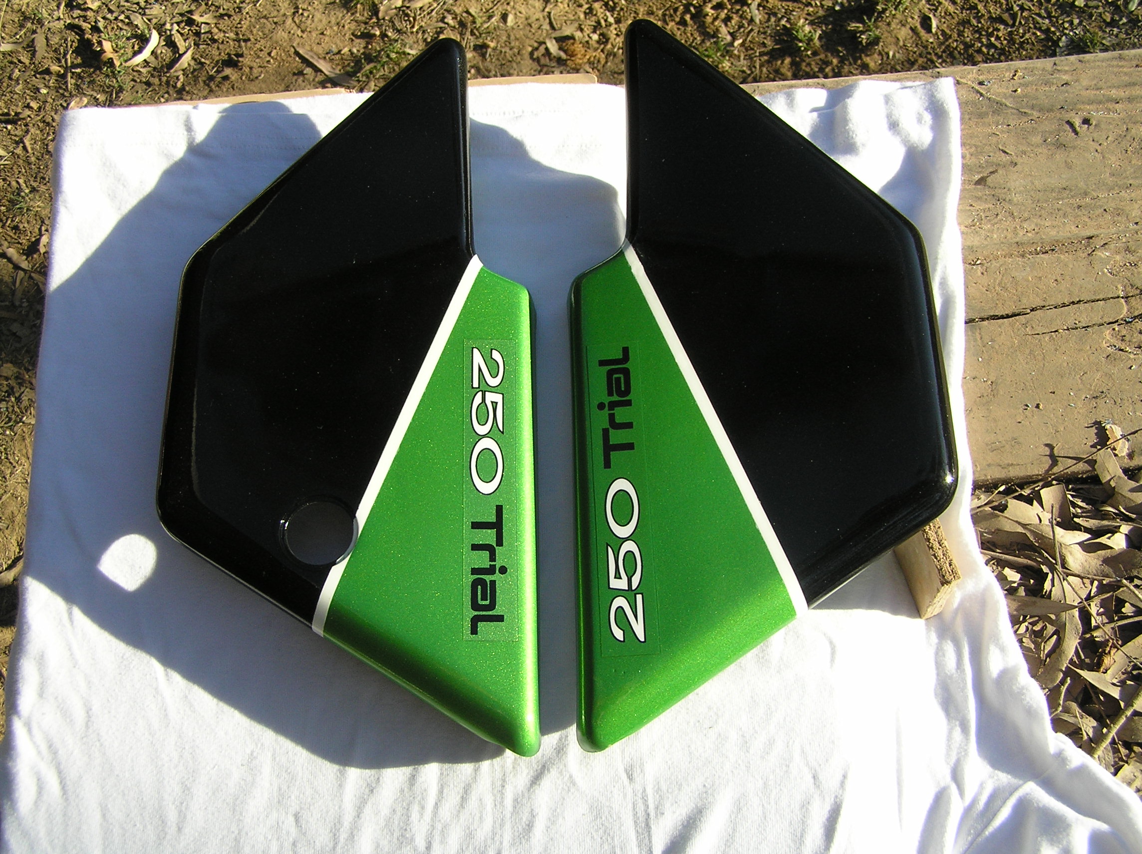

David, thats a nice paint job on the KT! We may have to awaken that KT collector to compete in the bling contest.

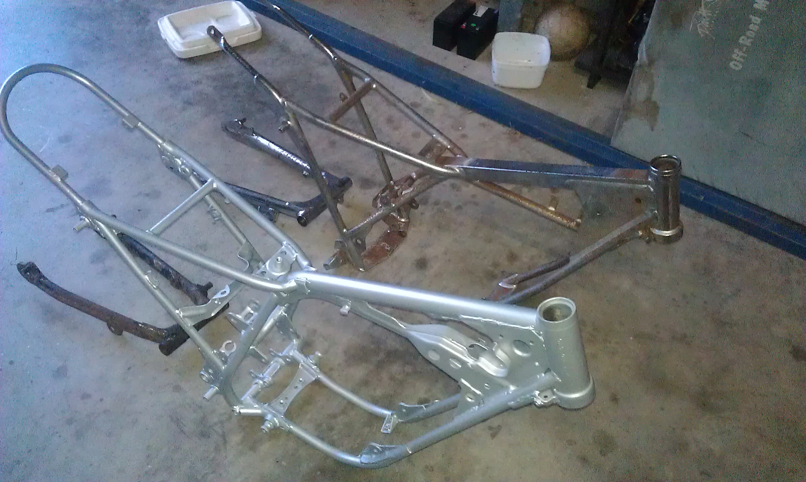

I've got a couple of TY175s completely apart and decided to compare the weights of the components that are not the same. One is a Whitlock TY175 and the other is a TY175B. The Whitlock uses the running gear from a TY175 so I have weighed the main items that are different on the two bikes.
Main frame section
Yamaha 8.2kg Whitlock 6.1kg
Swingarm
Yamaha 2.0kg Whitlock 2.0kg
Stand
Yamaha 0.5kg Whitlock 0.5kg
Seat
Yamaha 1.0kg Whitlock 0.5kg
Tank
Yamaha 2.3kg Whitlock 1.7kg
Net difference between them = 14kg - 10.8kg = 3.2kg

Yeah, the problem is all that heavy fresh paint on the Yamaha frame. Strip that off and leave it ugly then the problem is solved.

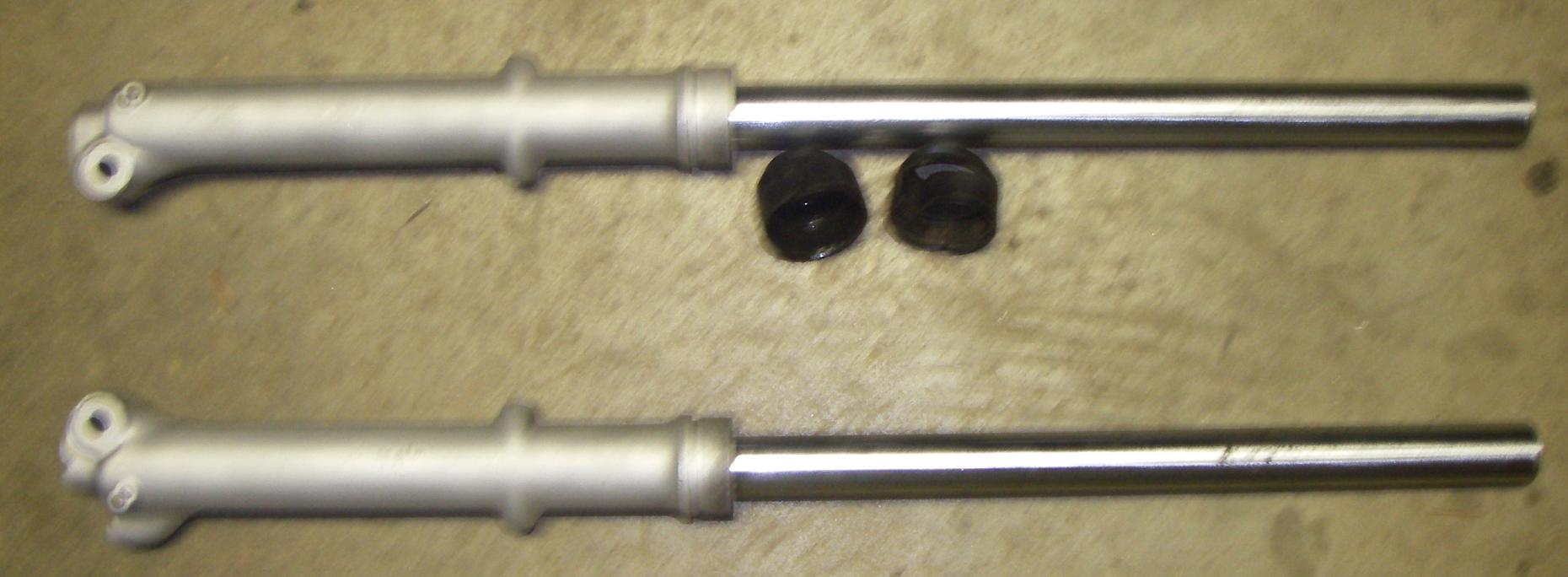

Had a little time this afternoon to reassemble the KT forks, There is now 48 less unassembled parts, don't want to count the total but I am hoping it is less than a 1000? Hoping to get dust seals from Kawasaki as mine fell apart when I tried to clean them.
