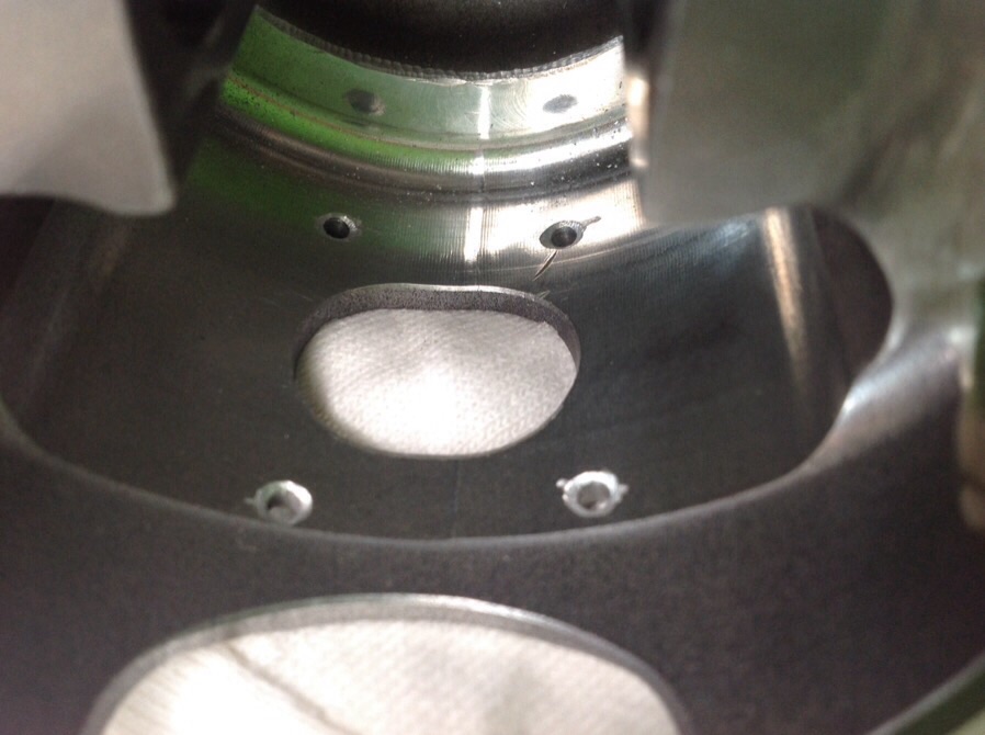

The barrel looks good as you would expect as it 10 times harder.
What I think the problem is, is as the piston comes down its doing a scissor action and forcing the oil away and not between skirt and barrel.
I hope this will force some oil where I want it. The wossner piston is strong so I don't expect it to notice. Having said that I used a fine round file so there are no sharp edges to promote fracture lines.
The reed tips show no signs of touching and fraying.
There is no air gap where the reeds seat so alls good.

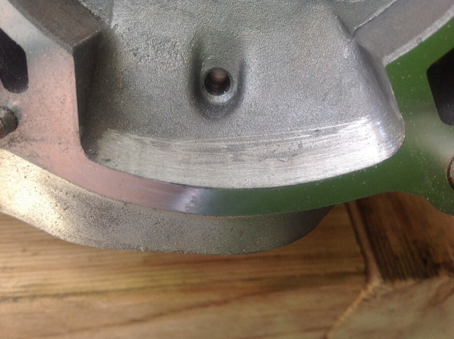

Cases are apart cleaned up and ready to be port matched.
The cases are about 1mm smaller so mark it with a dentist tool.
You can just see the line in this light.
Mark with a texter.
Tioli
Posts: 756
Bike: ty175je , KDX/KX ,,,
Location: Tas
Post by Tioli »
Get comfortable and this time I'm using a small sanding drum.
Check
Little off the back to match.
This time some has to come off the barrel.
Tioli
Posts: 756
Location: Tas
Post by Tioli »
A little off the case to match the bottom of the sleeve and a little off the barrel.
That much.
Same for the front.
The left side does not have any locating pins so you have to go by the marks previously made when it was togeather below both studs.
Will it make much difference? On its own probably not as it was not to bad to start with. However its the little things that make the whole.

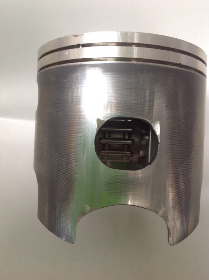

I was Skyping my brother over Christmas as you do and we got onto my piston problem. He was not a fan of my scavenging system as it dident help fix the problem.
My scavenging system
"That piston is under pressure and it's not happy" "The bridge ports are taking the heat from the piston and getting hot" "You have to blast it with oil" "Oil is stubborn and it takes a lot of heat to move its temperature"
So this is how I interpreted his fix.

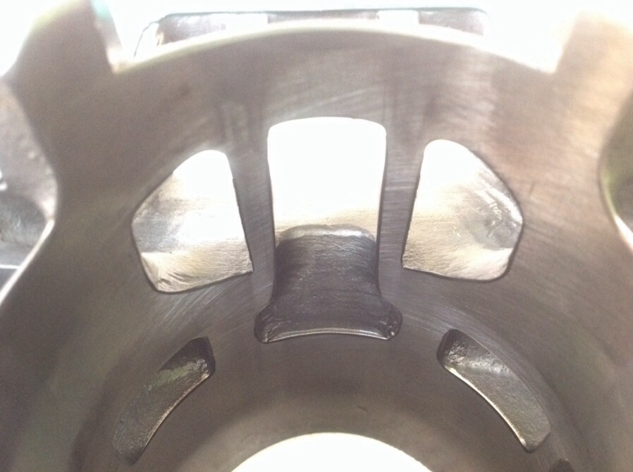

First I want to know where the bridges are
Note the scoring is wider than the bridges
"Drill 4, 2mm holes two above and two below"
While im at it open up the front.
Tioli
Posts: 756
Location: Tas
Post by Tioli »
"With a fine file, file slots wider that the bridge"
I cheated and used a dermal.
I did use a file to clean up all the edges to make it smooth.
"Sand the edges with wet and dry, you have to drag that oil out of there"
I use the same cut off wheel so the wet and dry was rounded alittle
"You have to take the sharp edges off as forged Pistons like to crack from there"
Both in the strong part, note
"Make it like a funnel"
I used a round tipped dremal.
The area behind the piston is a vacume compared to the preasure under the piston as it comes down. It's going to force air/fuel/oil through the slots and out the sides. On the up stroke it's going to suck charge in. My scavenging and his blasting system will help it float on a continuous stream of cooling oil.
If you are going to make power then you have to deal with the heat.
"Now you can hold it wide open while the others are seizing"
