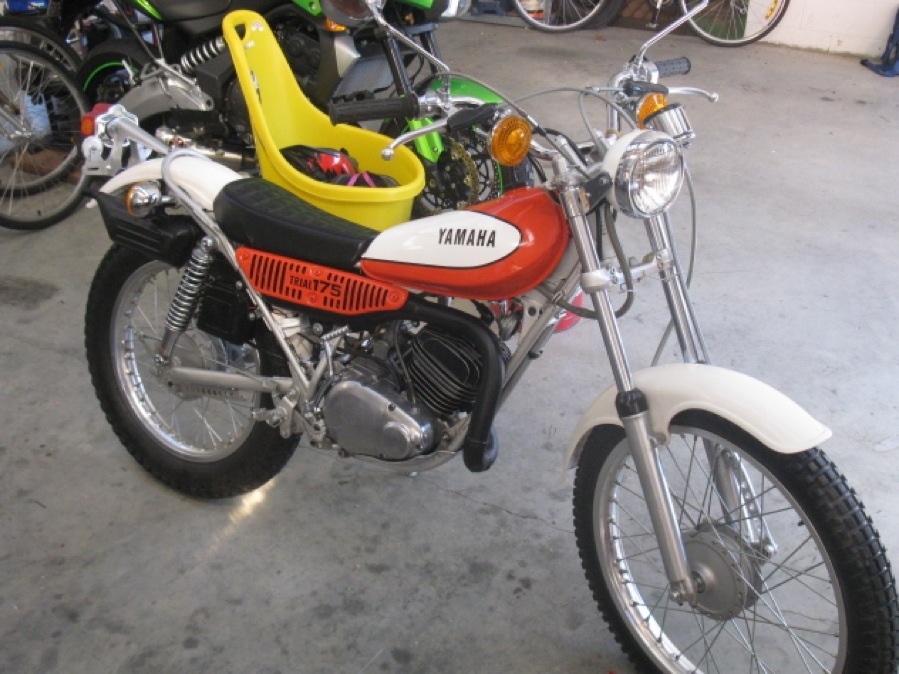

Hi Greg
Remember that ty basket case I bought in a box for $400.
Well after 4 months and $600 later I have turned it into this masterpiece of ty glory. It's fully serviced from the swing arm bushes up.
Not like my JC which is so restored it has lost it's character and my will to take it bush
No one can say this bike is molested. I did have to paint strip several layers of white gunk of the tank to get to the original orange tank
Greg do you have a orange muffler cover like the white one in your parts bin, happily swop
I can paint this one but that would spoil the look. This one looks like it was always white and is straight
Thanks
Eric

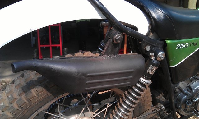

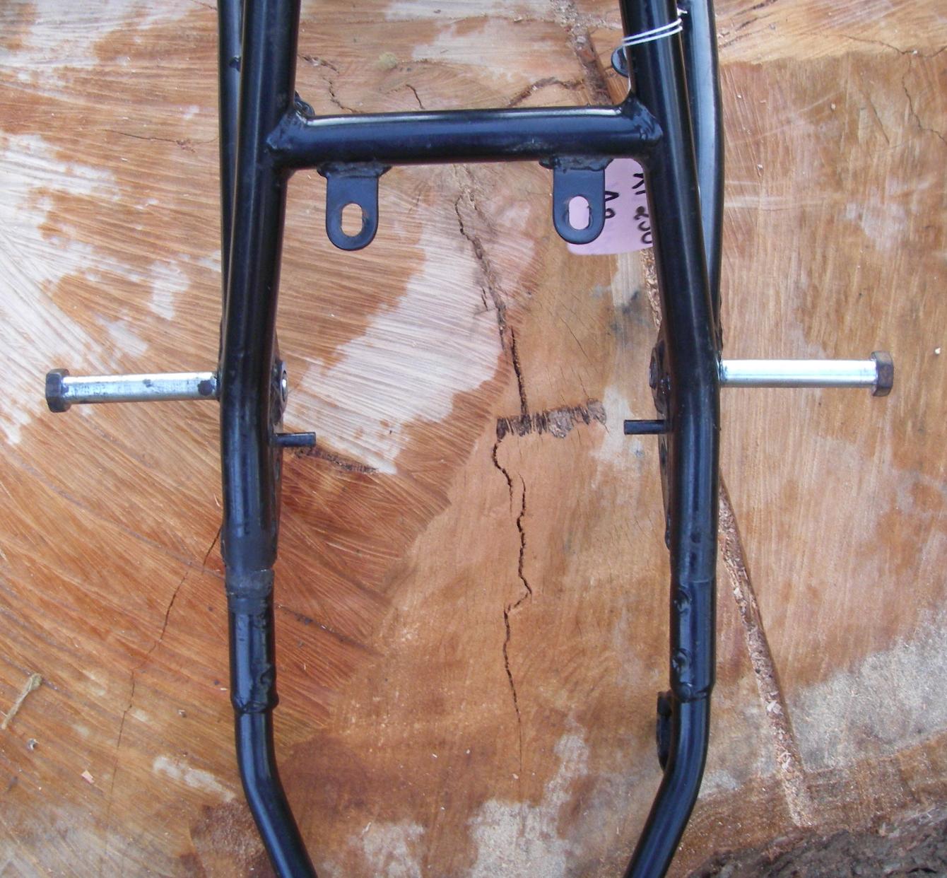

Just sharing where I am up to with the KT, for some reason there were no top shock mounts? So I drilled and tapped the frame 12x 1.25, screwed in some bolts and Tigwelded the inner end to stop them working loose. Suppose all good creations have a bolt sticking out of each side!

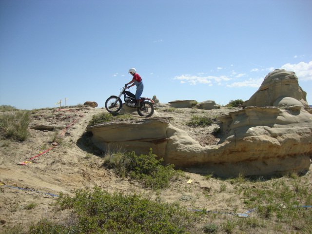

Greg Harding wrote:paulo wrote:Greg Harding wrote: Yes I have heard the stories about how it changes the bike and makes it more rideable, but if they were that good, we would see them at trials. Fact is RL's are rarely seen competing which is a shame.
They are rare here in the USA as well. I heard that was due to Beamish buying up a bunch for the conversion to Beamish? I had a choice between a TY & RL when I bought the RL and thought they rode about the same (RL was stock) but don't think I did anything tight. Perhaps I don't ride well enough to tell the diffrence.
- RL250 Midwest, Wyoming USA
- DSC01075.JPG (130.17 KiB) Viewed 5824 times

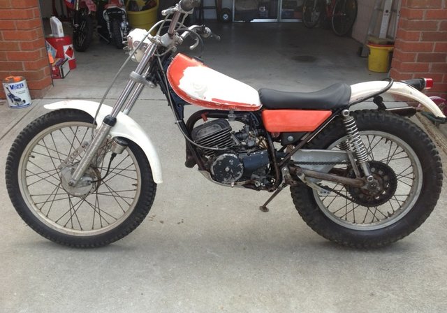

Here's a little one of my first ever (pseudo) trials bike.
I'm concentrating on gettting mechanically spot first and then I'll work on the cosmetics.
It's actually not as bad as it looks, though.
Ultimately, I want to get it registered as I reckon it could be the perfect bike for cruising around vinduro events taking photos.
