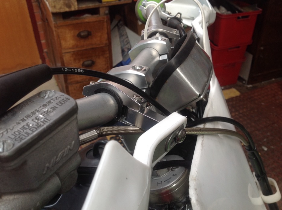

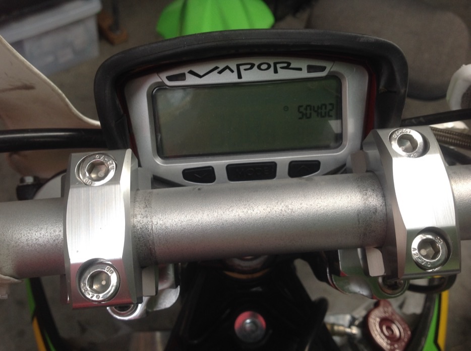

These are supposed to reposition to 50mm.
The problem is the bike came with fat bars and adapters. Raisers with small on the bottom and fat on top 70 odd mm are thin on the ground.
Looks a little busy.
As far forward as they will go with out bending or making a new base plate.

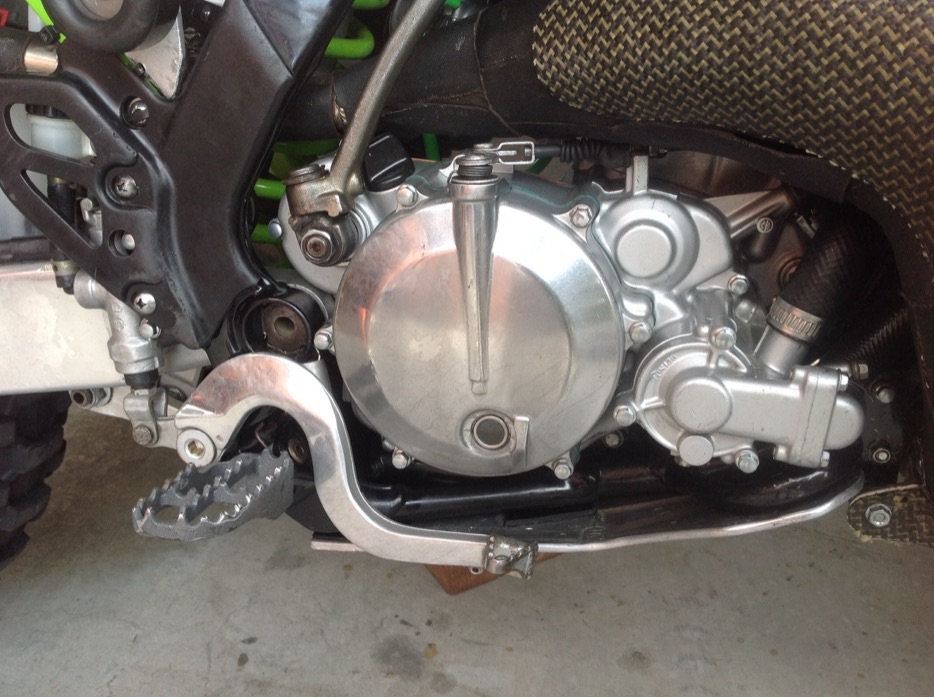

Looks just within normal.
Polished the clutch cover which my boots have messed up.

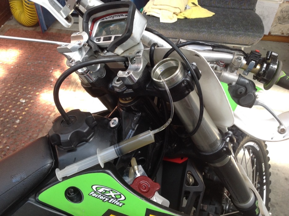

Still can't bottom out which is an indication of my age. So it either has heavy or normal springs in it. I'm running one grade thinner oit and taking 25ml out will bring it close to bottom of the range.
Strangly the oil I could get out of the rod hole was dirty and from the spring area was clean.
