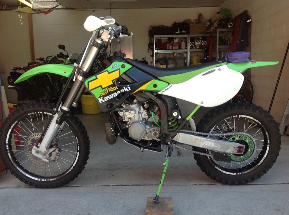

Posted: Sat Jan 23, 2016 6:33 pm
by Tioli
Nice enough bling with out being over the top.
Posted: Sun Jan 24, 2016 8:52 am
by CLO
Yep, I agree - it looks good!
Posted: Sun Jan 24, 2016 8:55 am
