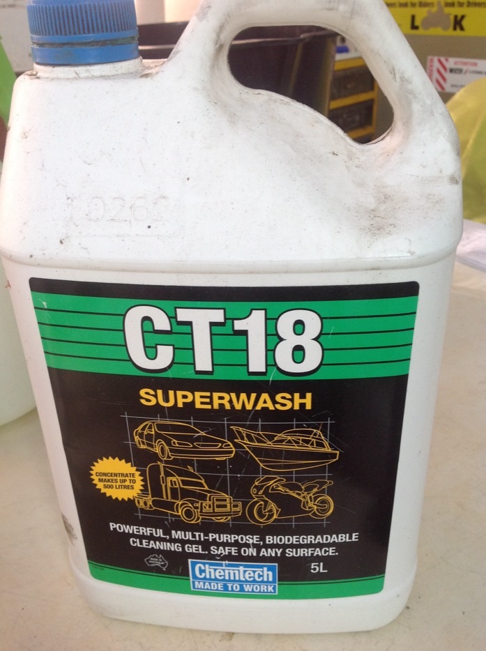

2, fill with water and add about a cap full of ct18
I believe this is the same as truck wash? It works like it should. By leaving a film that washes off and makes a new one.
Spray once with silicon (maybe a freshen up once a year)
Then for the rest of the time:
When I get back from a ride first thing is put the bike where I'm going to wash it. Plug the exhaust and pump up the sprayer and spray every thing. Drench it, about 2/3 of a bottle. Then leave it there for at least 10 minutes while you put the gear away.
Put a cap full in the bucket with water.
Hose the bike over to wash the dirt off.
I like to do this to the engine bays of the cars once a year. A mechanic told me never wash a hot motor or when it cools it will suck water into the electrics.
Give it a complementary sponge over and hose off.
Dirt does not seem to settle. If you rub some dirt in a light sponge over will fix that.
Start from the top by slapping a full sponge on and the suds running down do most of the cleaning. Just keep slapping it on and give it a quick once over and hoses off.
Works for me and my friends.
