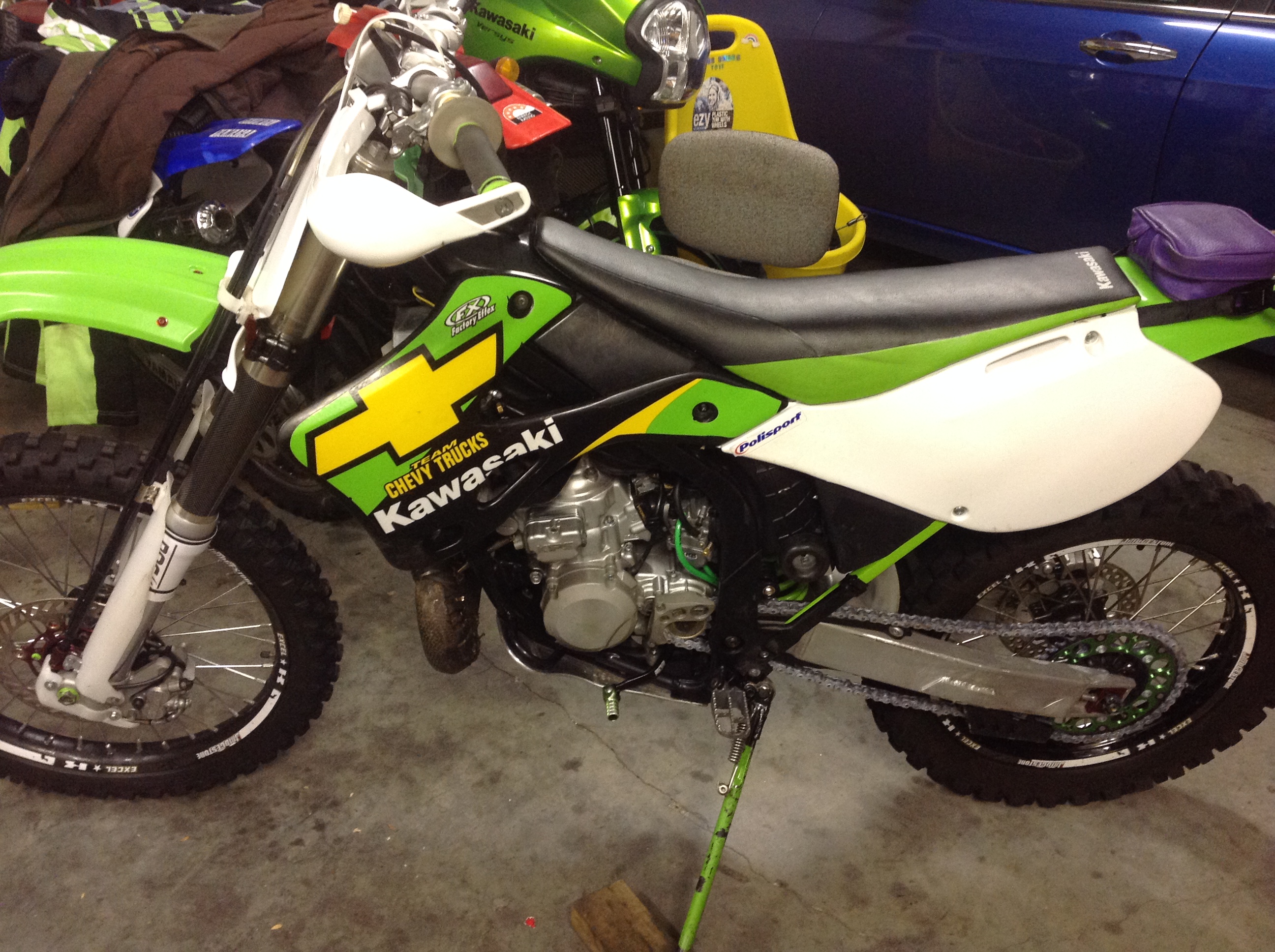

This bike is just about done so I am looking around to see what's next. This is a difficult time as there are more questions than answers. What I have wanted to do for a long time is make my own motor but I just don't have the equipment and knowledge on how to use it. It would not be that special but defently mine.
Finally had a chance to take it out and I was feeling frisky. Where we ride. It feels like 50 % of the tracks are sand and it rained the night before so it's good grip.
The change this time is another tooth larger in the front sprocket. I'm progressively going taller gearing is an tempt to get some drive and not just instant wheel spin. It feels like a new bike.

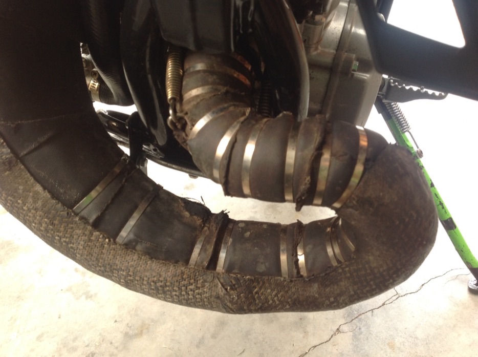

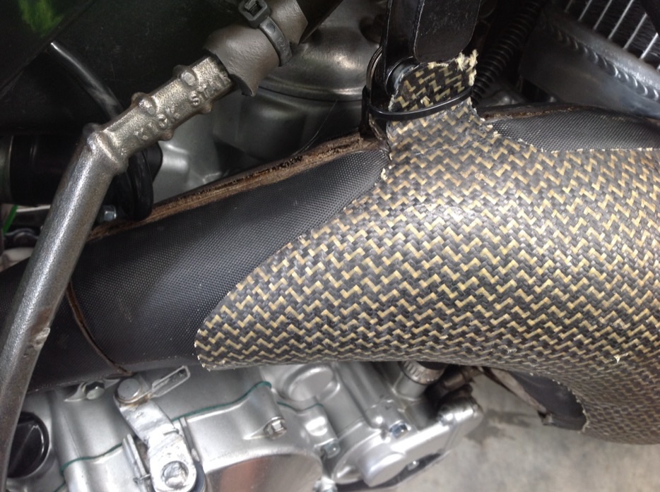

Thing is when you do that and stop its quite hot. So hot in fact that the sound deadening material was smoking like it was on fire. Blue, blue smoke up around the radiators both sides. The exhaust tip kept smoking for a long time. I suspect we had a carbon fire going.
The material has fallen off.
Still a bit hanging on. How am I going to clean that!?
Looks like it's shrunk some but still holding.

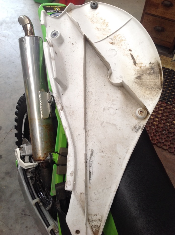

This panel seemed to have no support and just fell off. It's mate next door has given up as well.
And this one.
That material was forced to stay in position. This was where the smoke came from.

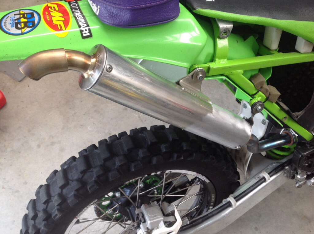

Fair enough I was making a lot of heat/power but I never expected the exhaust tip to discolour. The trip logger said my max water temp was 91* which is high for this bike. When you consider that's 91* at 153 kph that's is something to think about.
Spark plug says I'm still rich so alls good.
And this one.
There was oil all over the rear brake calliper. Looks like the bottom of the silencer was blowing oil out which it had never done before.

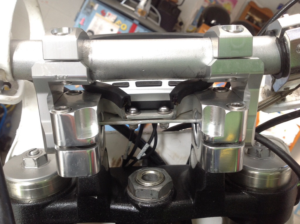

On the plus side the new handlebar height really worked and I could stand with out feeling like my arms were being pulled down.
The brake line stay, stayed put so I will call that good

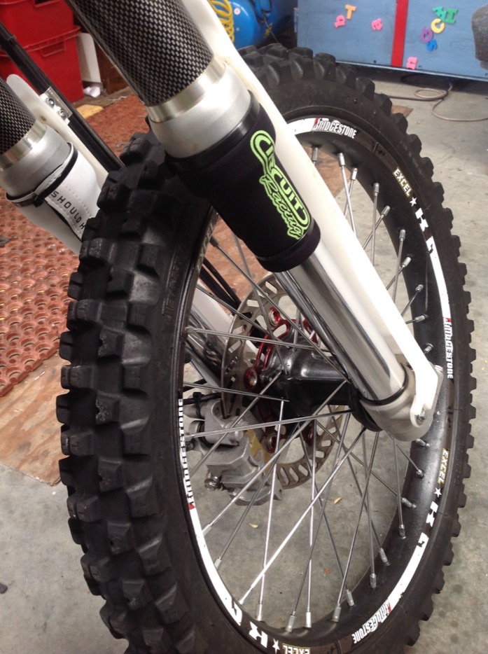

I finally feel like the front forks are beginning to work. No negative feedback, I can drop off ledges and feel confident it's going to jut do what it's supposed to do. For the most part don't know it's there.
The cable tie on the leg is pushed to the bottom which is expected with the fork wipe on. Having said that this is the first time it has gone to the bottom
I really suspect it's got heavy springs. They are just starting to feel good and I'm at the extreme edge of adjustability. One grade lighter oil, the oil level ranges from 60 to 120mm from the top with 90 std. I'm at 120mm, softest setting on rebound and compression.
I going to leave the black fork wipe in for a while before I replace it with a white one just to see how dirt acclimates.

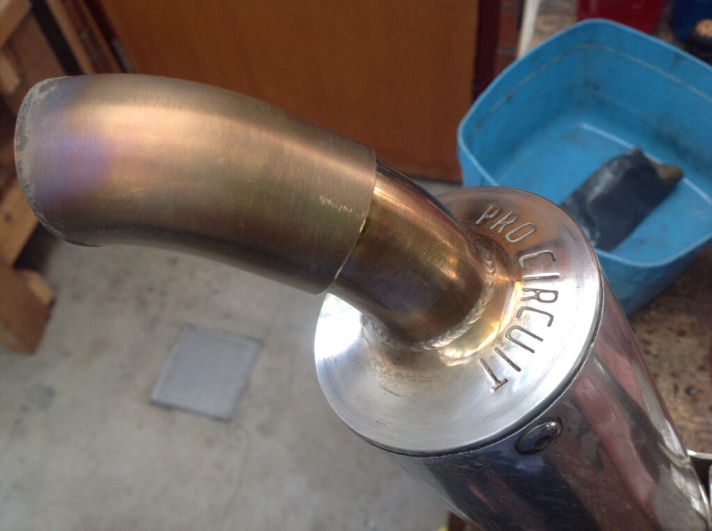

The black goop came off easily enough.
Now I noticed I preferred the darker colour over silver SS colour. So experimented to see it this would work.
Now to get the glue off
Light spray with penatrol to seal it.

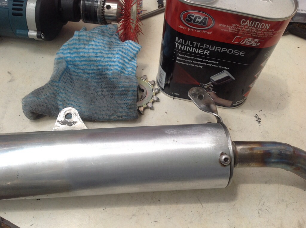

I do like that just been thrashed look. I think the reason the colour is burnt patchy is the penatrol I coated the polished silencer in to stop it oxadising and going dull.
[attachment=5:spam]
I do like it so will remanafacture it myself. First clean it off with a little light sanding.
[attachment=4:spam]
A little heat and it's done. Looks like I did not clean the penatrol off the outer edges of the end cap.
[attachment=3:spam]
Little polish with 1200 wet and dry
[attachment=2:spam]
How long it lasts or ages I don't know and doesn't really matter.
[attachment=1:spam]
Thing to me is every time I look at it I will be reminded of the day I ended up make this bike go fast in the bush.
We both have to have big balls to light up big gears. The auto clutch will take care of the small stuff.
[attachment=0:spam]
[attachment=4:spam]
- image.jpg (166.65 KiB) Viewed 61538 times
[attachment=3:spam]
- image.jpg (146.69 KiB) Viewed 61538 times
[attachment=2:spam]
- image.jpg (129.03 KiB) Viewed 61538 times
[attachment=1:spam]
- image.jpg (186.93 KiB) Viewed 61538 times

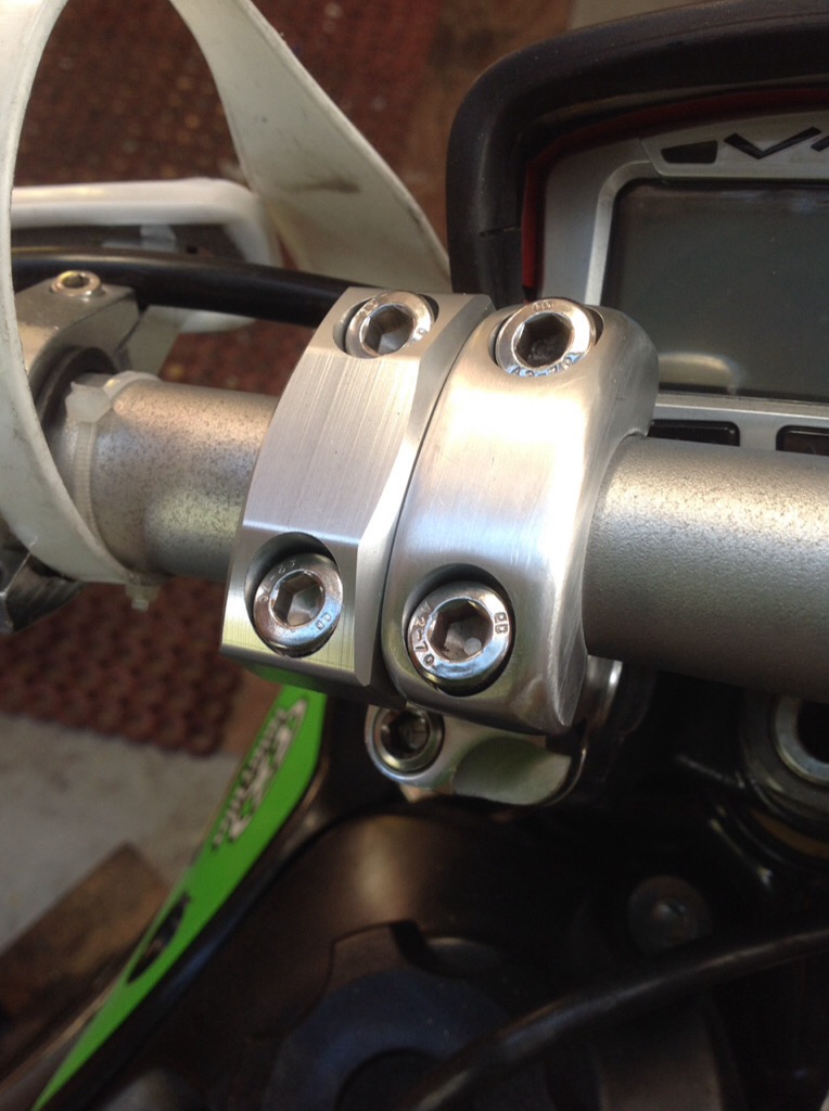

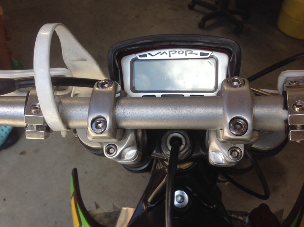

While I procrastinate about what to do about the exhaust I may as well fix some thing that's annoying me.
The small bar to fat bar and raisers are square and chunky and out of keeping with the bike having rounded edges.
If I round the edges off it looks better.
If I round the edges off all of it it all looks softer and smaller.

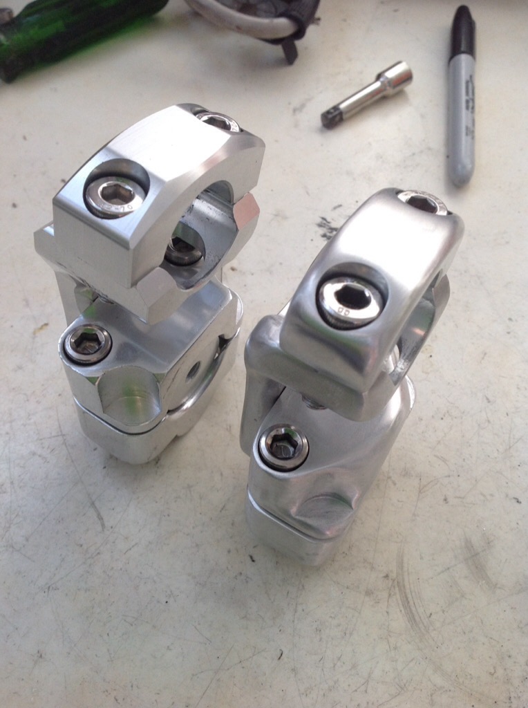

I like shaping metal as its not something you do every day.
With a bit of filing
Some sanding to remove the file marks, soften edges and sand the anodising off.
About 400'wet and dry to give it that burnished look.
Light spray of penatrol to seal it
Now the handle bar guards mounts look wrong.
Easy fix
It's not so much that now it looks good but more like now you won't notice it as it fits in.
