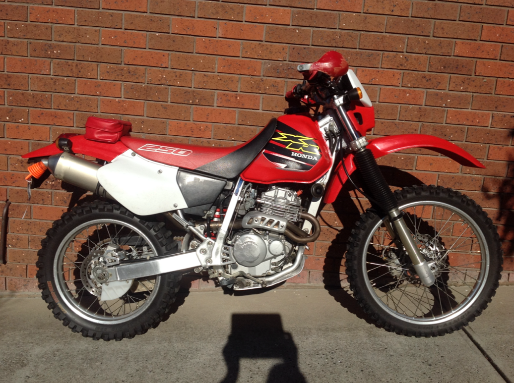

Other thing is I like that motor, It has spirit.
In its current tune when you are in the topend your wheel spinning. Somehow the taller gearing makes it more mellow. You don't have to be flat our to be in the powerband, has more bight hookup.
In sixth the only way your getting to it in a hurry is by fifth delivery. But once in back off.
The bottomend is one or two on the rear sprocket to small. I don't know that I want to mess with the formula.

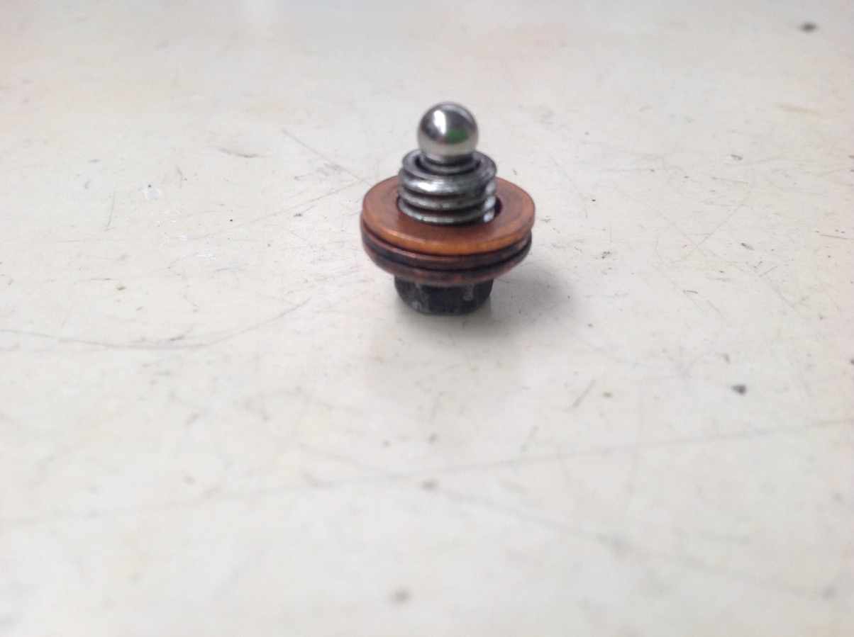

My understanding is this spring and ball tensioning system is adjustable.
The standard setting is two washers
So if I go three I should reduce the drag on the drive shaft for the powervalve. That could make the powervalve open earlier.
Now this may seem easy, the problem is it's designed to open at the same time as the timing retards.
How earlier will it open and how will it react to more advance?

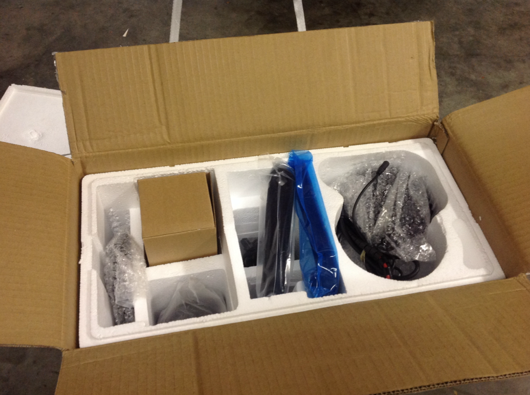

Hmm well I don't have the tools yet so I will just have a look.
Motor is oiled, solid and cold as a cold lump of metal is. Doesn't matter I will put the life into it.
The throttle has a nice smooth solid action. I wasn't to sure if I was getting a half or full twist grip.
Gear shift sensor plugs in some where.
Display is there
The bling ring is a special option.
Now where to put this stuff and all the rest that's coming.

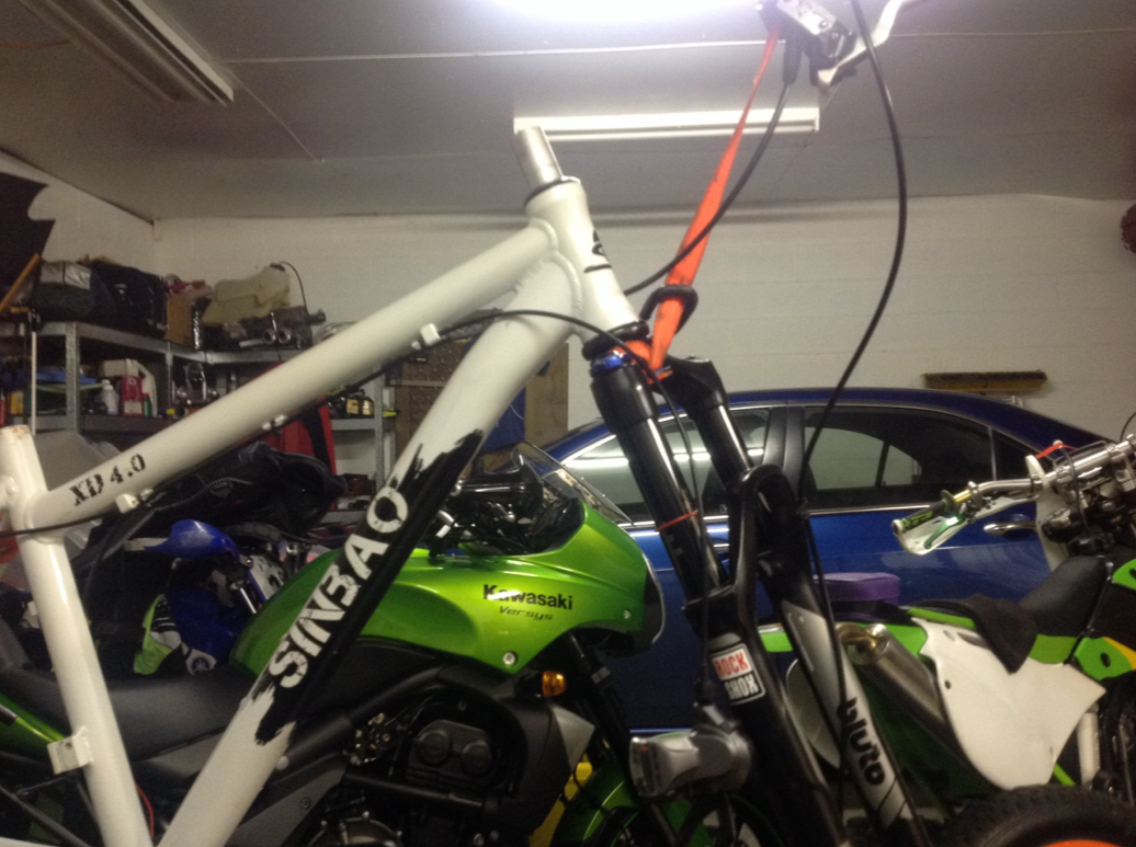

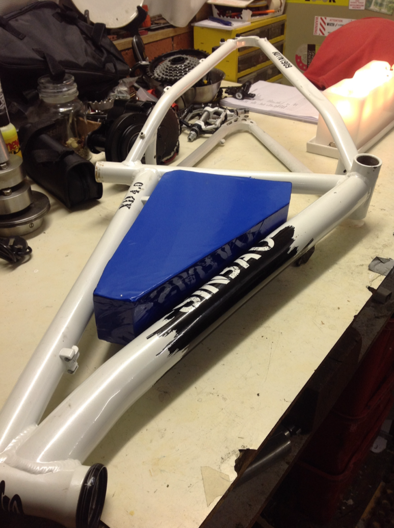

I think my first problem is I have to extend that to fit me. It seems the frame measures to around medium and small and I'm deffently a large.
Second one is the battery box is to big. If I ever make my own with high power batteries it could be smaller

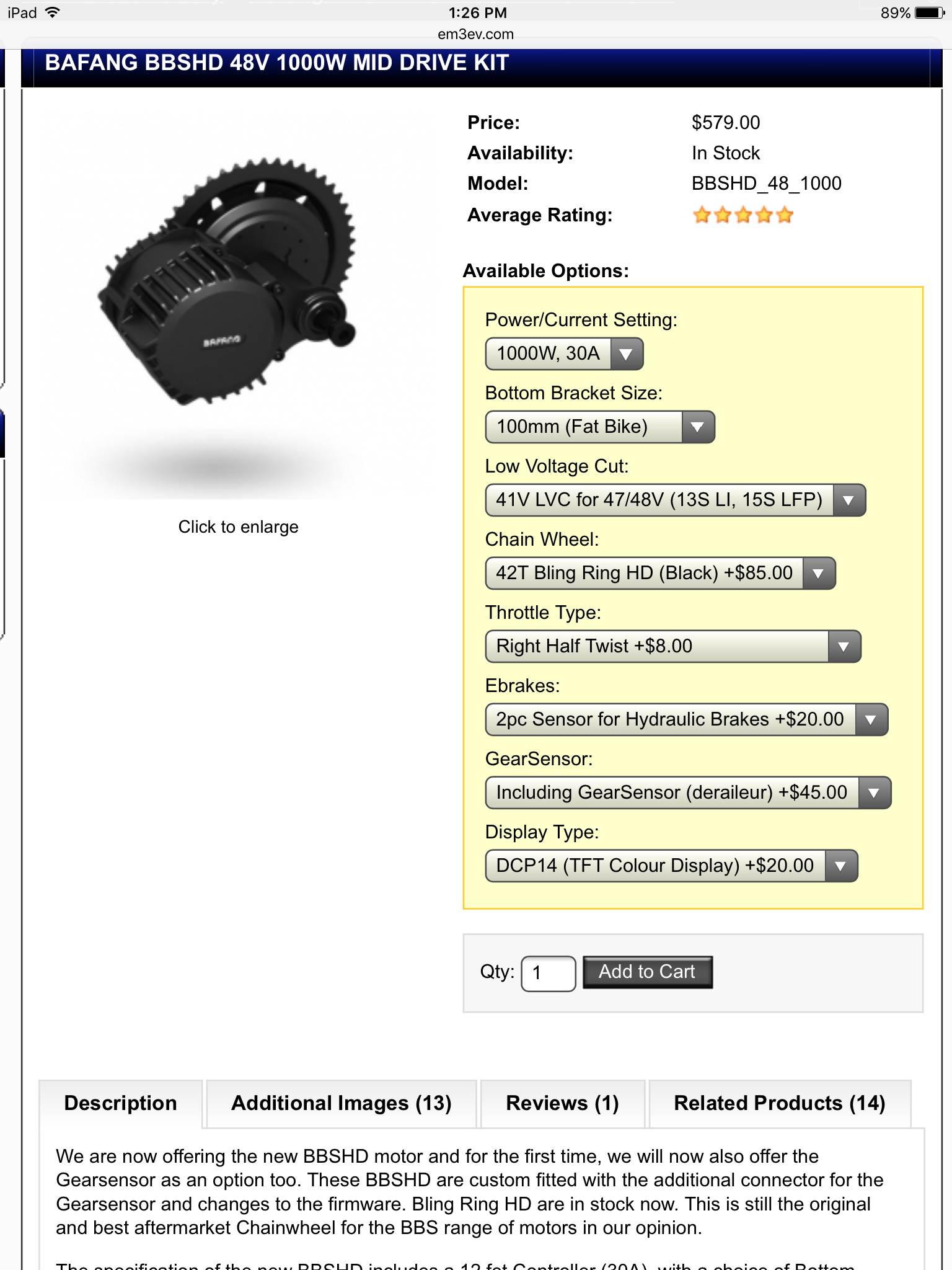

While I was thinking what I wanted from this motor I got a bit to click happy with Allexpress and colour coordinated a white bike.
It was simple only three colours. White and black with orange wheels. I seem to have been hasty which is a shame as I like white and black.
I like the frame, like white.
My concerns are:
I reasonably the stearing angle is bigger for a cruiser not technical tight.
I don't know how much to extend the stearing head
Is it possible
The triangle is to small. I would like more room for a carrier and radiator.
I might have to put this frame on hold
While I explor this. Apparently the gemority is exactly what I'm after.
What a mess I'm going to end up with, a real shmosil of colours this is going to be, blue, white, yellow, black, orange, silver, red and gold.
Well if I have learned any thing is just put it togeather and then figure it out.

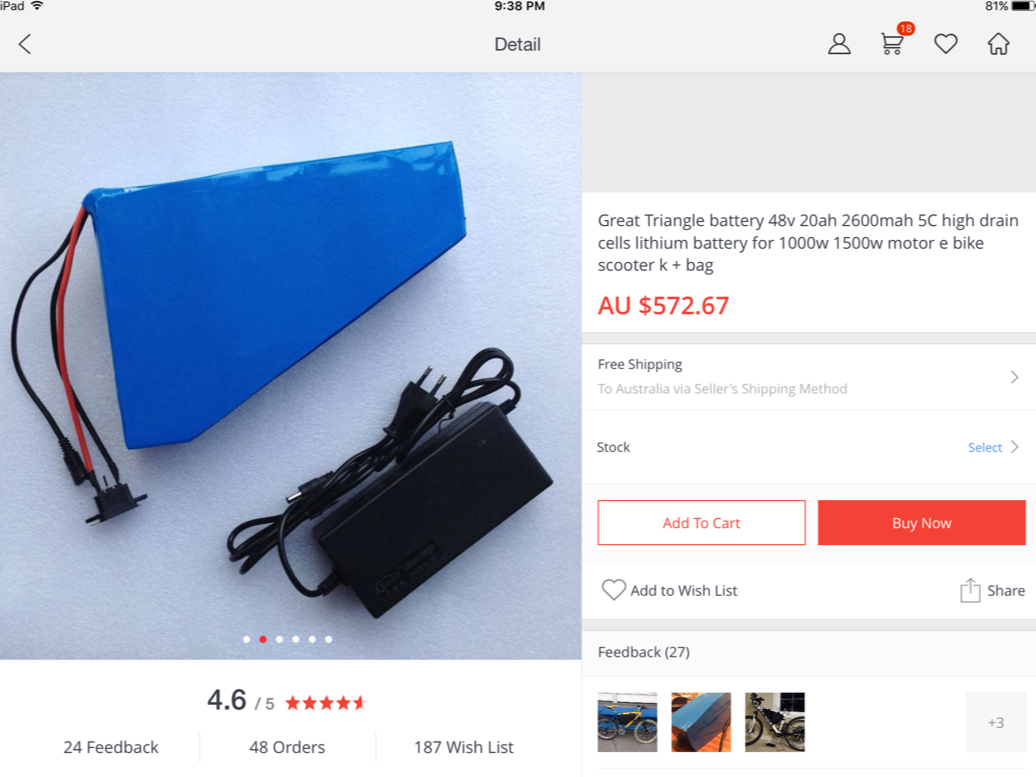

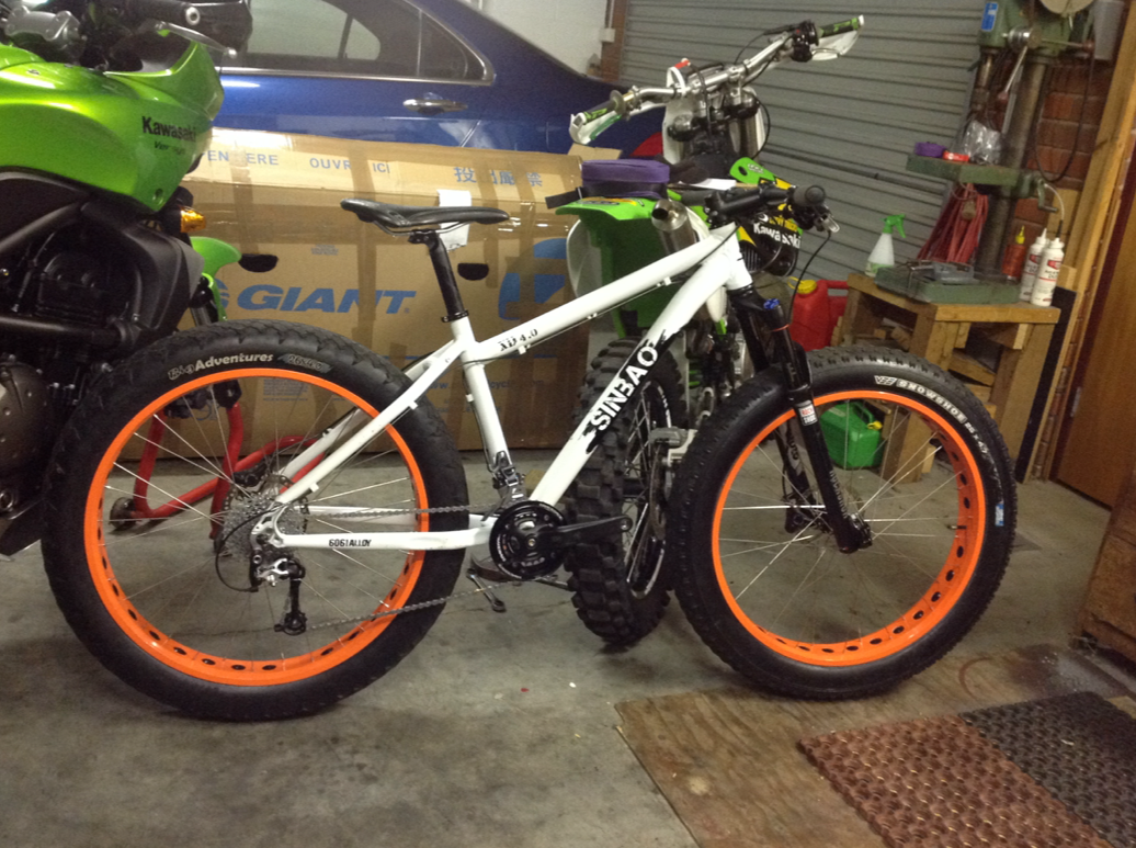

I bought this battery because it's grunty if I ever get into this I could make a 52V 30ah the same size with 30% better batteries.
That looks about perfect.

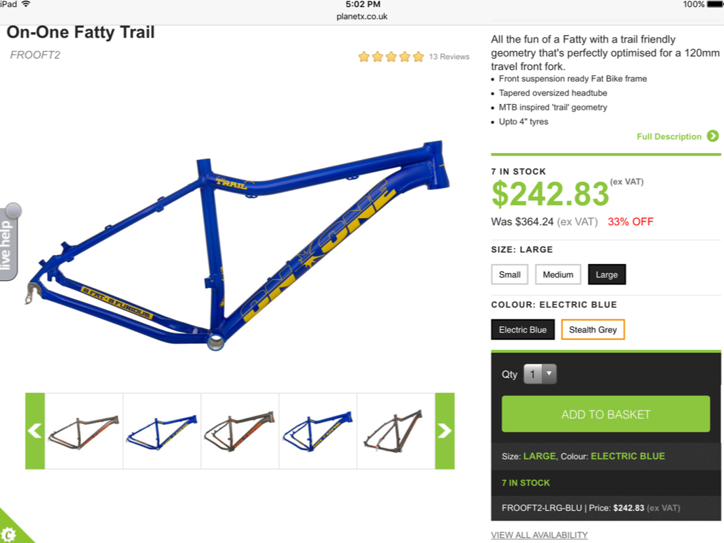

Love the frame layout. Apart from the bend in the seat post tube the rear is a strong triangle.
The bend in the seat post will take some of the stiffness out of it.
The bend on the top tube is not a straight line to the rear axel.
The bottom tube is braced under the stearing head to hold it in place.
I think this frame could be a little fluid.
I can't line the frames up to compare gemority
Laying the frames like this only lines the heads up in n one angle.
Line the bottom brackets BB up it makes the seat tube out of alignment the rear attaches axel mounts about a 1cm back and up.
Another example of just put it togeather and then figure it out arrived. I was thinking white rim tape would look better with a white bike.
