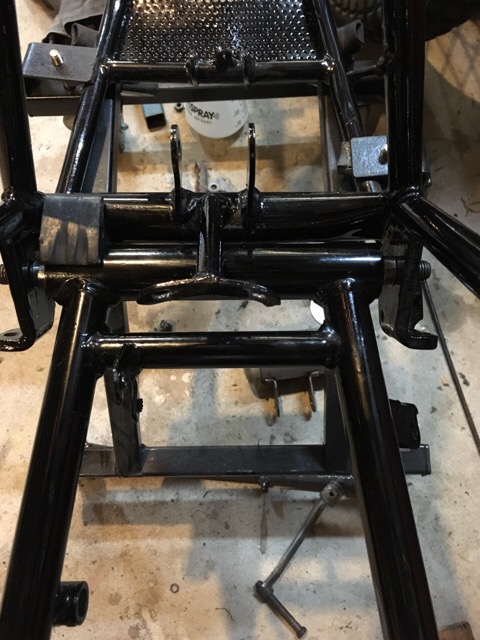

Re: Cota 172 Restoration
Today I fitted the new rear guard. Problem is, it prevents the tank/seat base from sitting down on the frame.
Looks like it fits OK here
With the seat in place
This is how night the seat is held up by the mud guard.
Does the mud guard need to be reshaped to allow the seat to fit correctly.

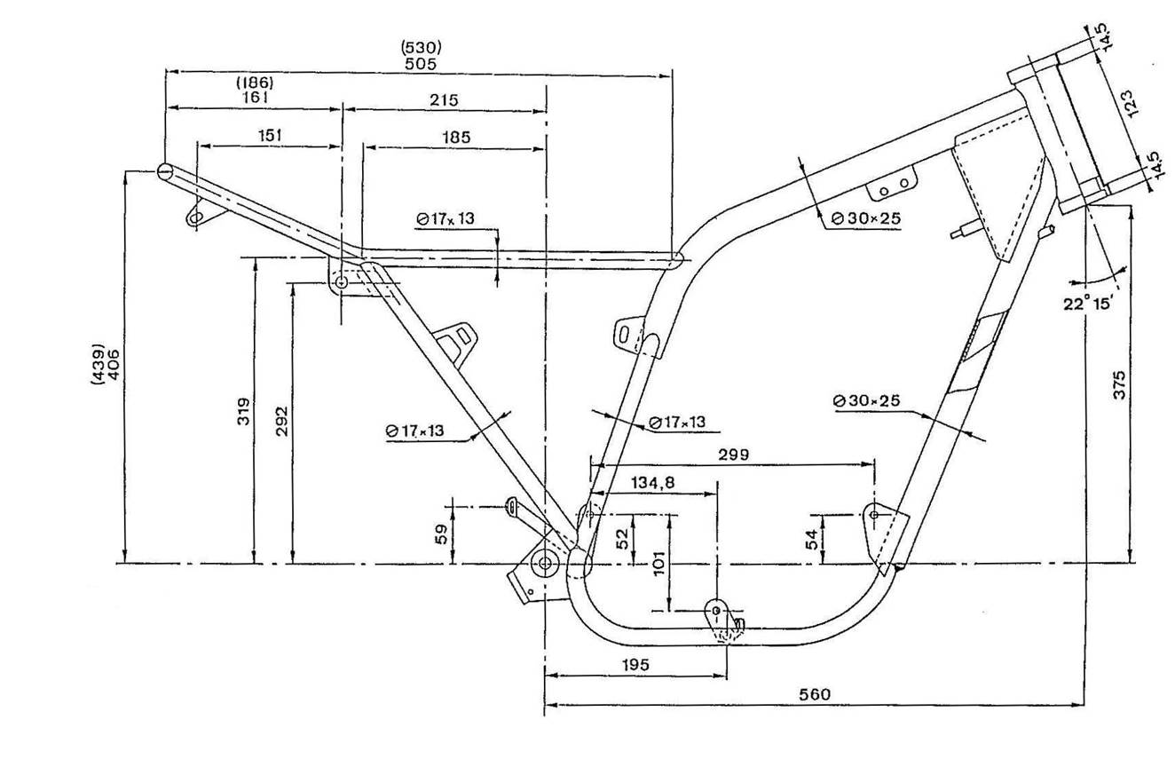

On further investigation my frame measures up the same as in the photo below.
There are two dimensions for the position of the rear mudguard support hoop in brackets.
My frame measures the same as the 161 horizontal dimension but measures almost the same as the vertical dimension in brackets (439).
Does this mean that the mudguard support hoop is bent up and needs to be bent down.
I positioned the mudguard as if the hoop was bent down as per the 406 dimension and the rear wheel on full suspension compression just fits inside the mudguard, so I think this would be OK.
What do you all think ?

In the photos it looks to me like the rear loop is bent upwards just behind the upper shock mounts
That's what I was starting to think as well David, but then I held the front mudguard onto the front tyre and the mudguard is a smaller radius than the tyre
I have had a close look at some photos of 123's compared to 172's, and the 172 mudguards certainly look to be larger radius.
