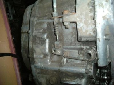

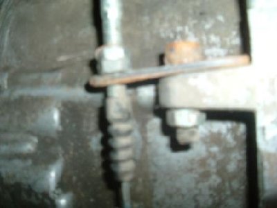

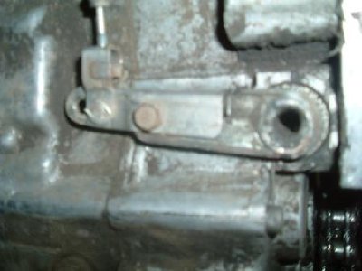

Here are the photos and some details of the my TY250A clutch lightening Mods. Photos are a bit blurred but should be sufficient to get the idea
Both the motor lever and the cable mount were modified.
Motor lever was extended by 25 mm using 1mm steel folded over to wrap around the existing lever. The lever was then held in place with only one bolt using the original hole in the lever. The lever size was 18 mm X 50 ( So the materail size was 36X50) Picture shows the extra hole at 35mm which was to big a pull for the clutch lever.
The cable mount was extended out 30mm to get the pull lined up. I used 3mm steel ( material size 20X60)
I have had a few rides and find myself using the clutch with one finger so I am pretty happy with this mod. If anyone need more detail just ask.

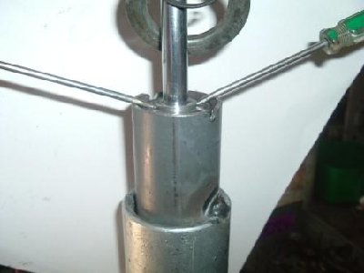

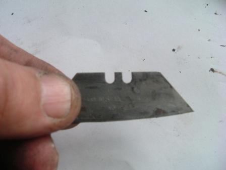

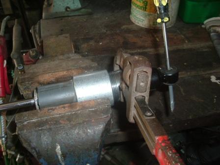

I have a method for getting the wiper seal housing out of the Falcons.
1/ Grind a stanley knife blade so it is sharp at for 1/3 at one end and blade completly gone at the last third. Use this with a hammer to get the housing out to the thickness of the blade. Start with the sharp end and work your way to the blunt end slowly working your way around.

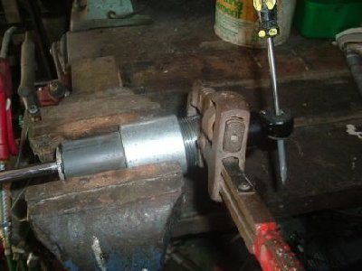

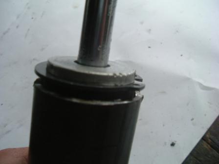

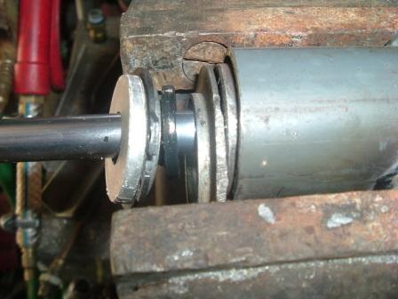

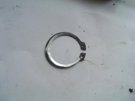

2/ Install the Pipe tool , a tight fit washer and then a 1 1/4 (32mm) circlip ground down on one side ( A little difficult to install)
3/ Fit in vice and use a stilson and screwdriver to stop shock rotating. Note if the tool does not fit tight to the shock you need a tight fit washer otherwise the circlip will bend.
4/ On the first shock i did the main seal housing was stuck so I put the shock in the freezer overnight and this helped. The pipe tool is also handy to get the extra height if the main seal housing is stuck.
If you need more details please advise
