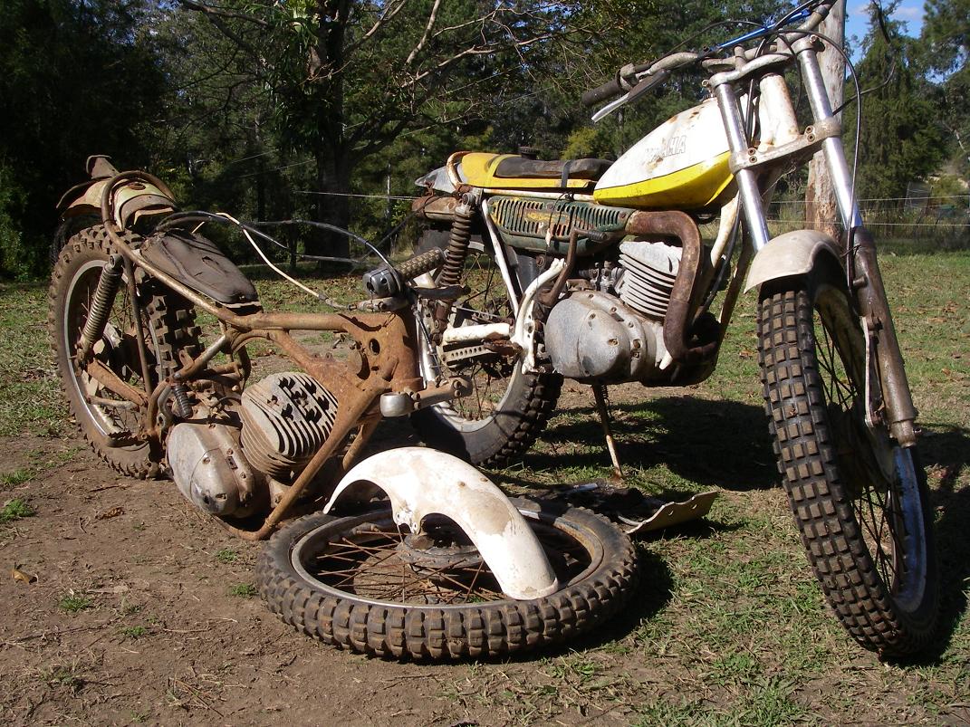

Just sharing the latest TY 250A, you may recognise the spare parts bike previously on page 2. The story is I bought both of these together for $300.00 the more complete one was basically all there but didn't go. I had it on the backburner while I was playing with the RL as it was not as easy to fix. With some help from mechanic friends, the A model lives! I assume it had been left sit for some time! The fly wheel was unusually hard to remove and we destroyed it in the process! However the spare parts bike had an excellent fly wheel. So points and condenser and clean out the carby and all systems go. The tank was extremely rusty so I left E10 fuel in it with magnetic hex drive bits and nuts inside. For 2 weeks I would drain the tank, leave some fuel, shake the crap out of it, drain and blow the metal bits out of the magnets, repeating the process on a daily basis. Suprising how the E10 desolves rust! The forks from the spare parts bike turned up a couple of weeks later and linished up good and now work well.

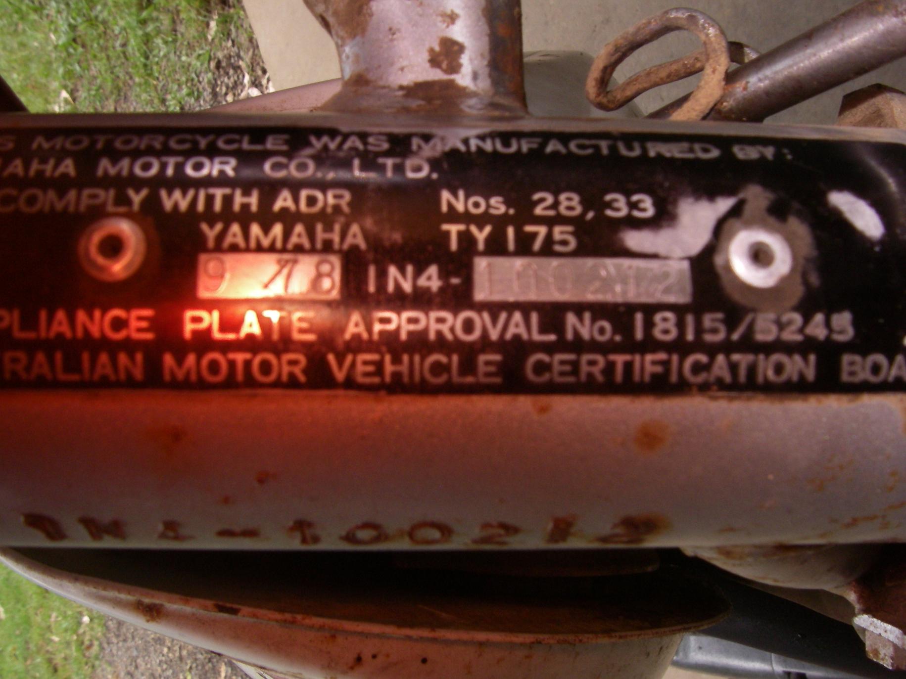

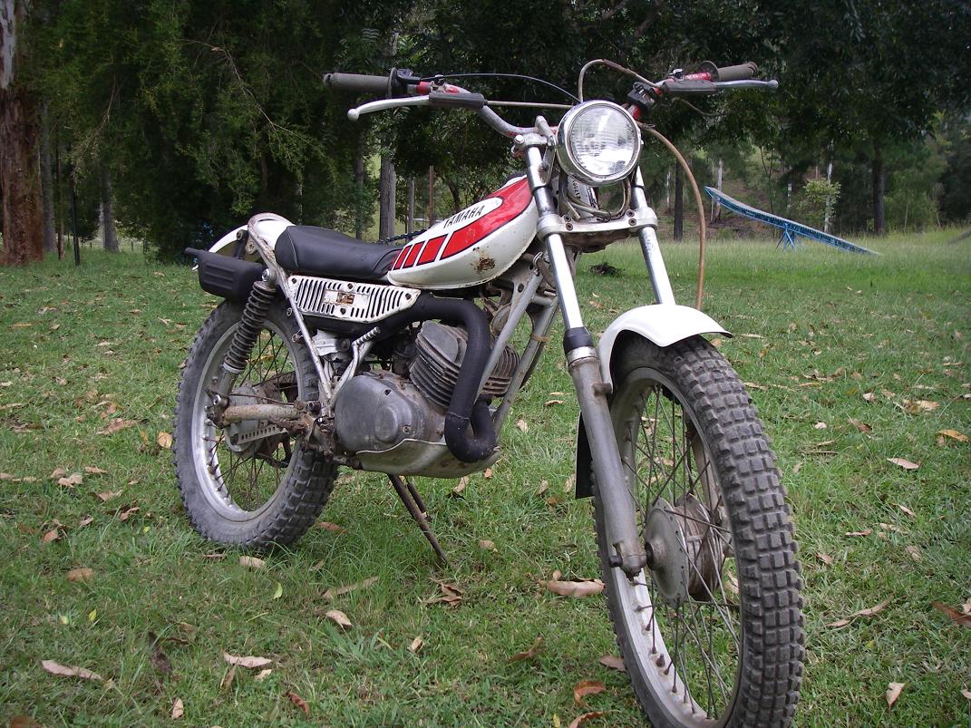

In my last quote, I discussed a TY175 which has had fifteen different riders in the time that I have owned it. Have decided to post some photos, as I think it is not a common model, I believe it to be a TY175JE which superseded the JC. Plus I have a slightly older JE basket case with the same graphics on the tank! As you can see in the photos, almost original condition and complete except no speedo. Every time I took a photo of the compliance plate, the flash reflected and you couldn't see anything, so I remedied the problem by putting my finger over the flash! I think this is why the photo is red?

Nice to know your blood is oxygenated Greg. The ADR plate photo is great and I see it also shows the frame number stamping in the same shot. It may well be a JE. There is a listing of the various common and uncommon TY175 models in an early issue of VMX magazine. Unless someone else wants to look the number up, I will - as a nice bit of bedtime reading tonight.
There is one of those same TY175s in our local trials club so they can't be too uncommon in Australia.
The TY175 reference in VMX magazine was contributed by Stephen Fox and lists:
1978 TY175 model with serial number range 1N4-100101 to 200000 as TY175JE
1976 TY175 model with serial number range 1N4-000101 to 100000 as TY175JC
