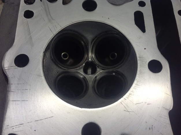

I think I will have to leave it and get some more 400. If it wasn't for the scratches at 3 o'clock I would leave it at that
Sheet of glass and 400 grit wet and dry

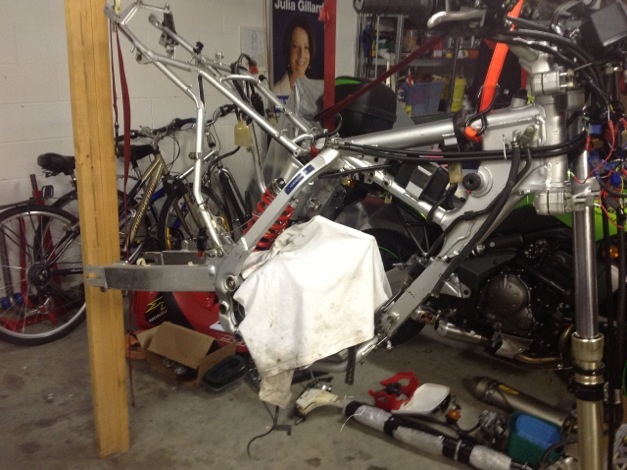

I want to give this bike some aspects of a trials bike.
I work on this one like a race bike.
This model has some history. End of the air cooled. Electric start with no kick starter. That suggest confidence in the starting system.

The head gaslit looks like it was scrawled off with a old paint scraper.

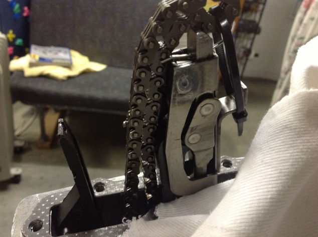

Strange how I have to take the oil pump off to put a new cam chain on.
Seems it has had a play with the cam chain on the way down. Any chance it's in the oil pump!!!

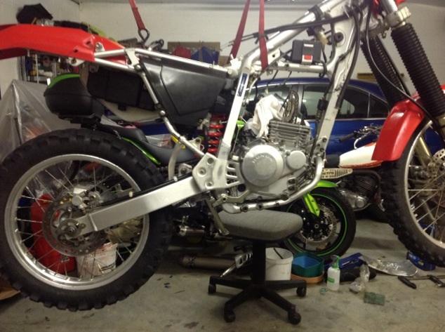

When I get this going and had some use with it. I think I will get it road registrable again and may take it on special events.
I have a plan. I'm going to need to make a pretty special fork brace to hold the mudguard in that place.
I have already started on the motor. It may not be a big one but if its happy they are all fun to ride

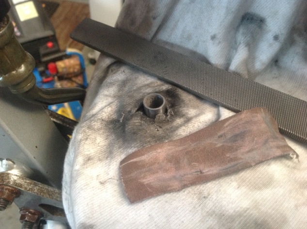

When I was putting on the head I noticed it didn't want to go down on the dowels. Seems the problem was way I thought was a good dowel wosnt. It says jammed in with gasket gue,misting askew and high. This would have throne the mâché nest off on his measurements. Lucky I ordered a new one as seen in the photo.
The new one piece thread and dowel measured on the border line of beeping to high and may prevent torquing down and consequence Leakey head gasket.
The one in the picture has already been shaved by one or so mm
