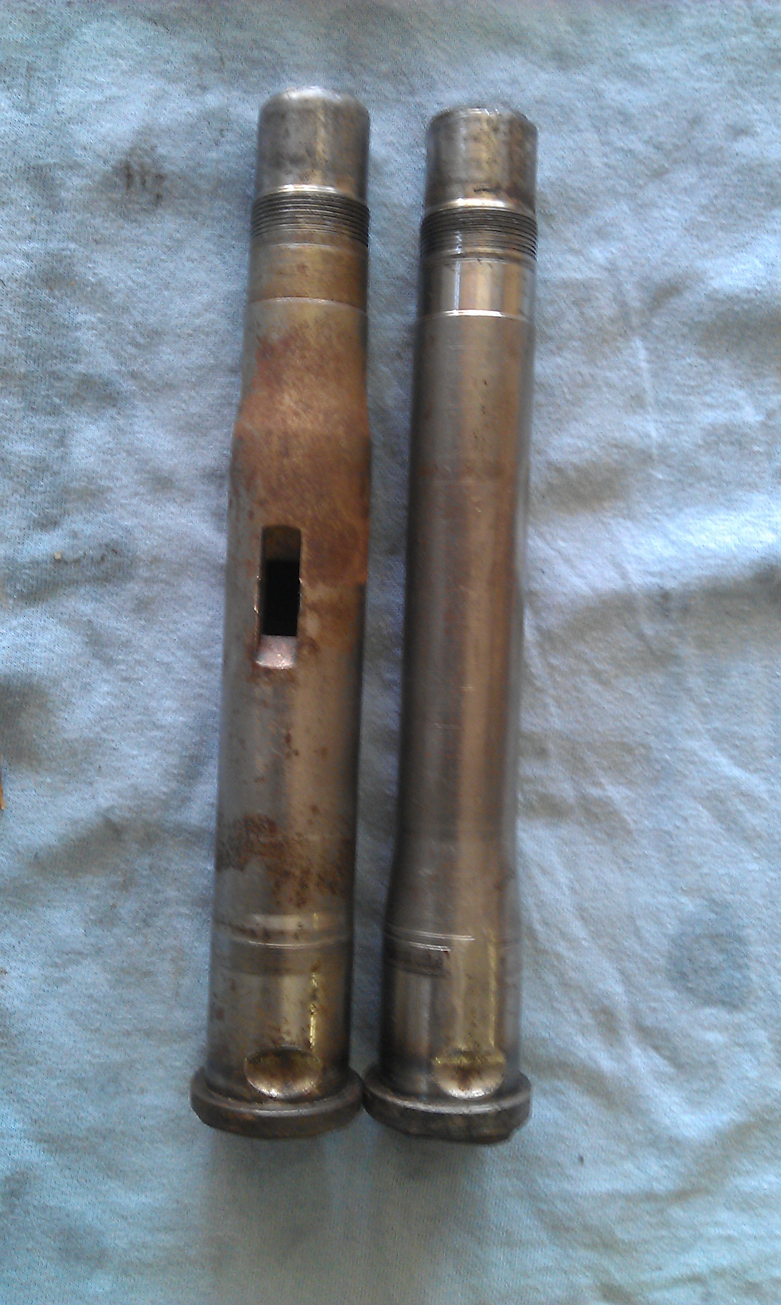

OK here's a trick question.
Which of these Yamaha steering stems is from a TY175?

I am guessing it was a rhetorical question, as they look to have the same diameter at the bearing surfaces, but taper at different points. My guess it that the bean counters instigated changing to the narrower profile...

Julz wrote:I am guessing it was a rhetorical question, as they look to have the same diameter at the bearing surfaces, but taper at different points. My guess it that the bean counters instigated changing to the narrower profile...
No not bean counter syndrome
Is the one with the slot in it for a registerable TY (steering lock) and the other for competition version?

sharvie wrote:Is the one with the slot in it for a registerable TY (steering lock) and the other for competition version?
Bingo Steve. Yes the skinny one is from a B model and the wider slotted one is from the JC model. Maybe Yamaha thought that the slot for the steering head lock weakened the stem too much to retain the original stem profile. Then again maybe they needed the bigger diameter for the locking pin to be able to reach.
The stem weights are:
TY175B - 522g
TY175JC - 539g

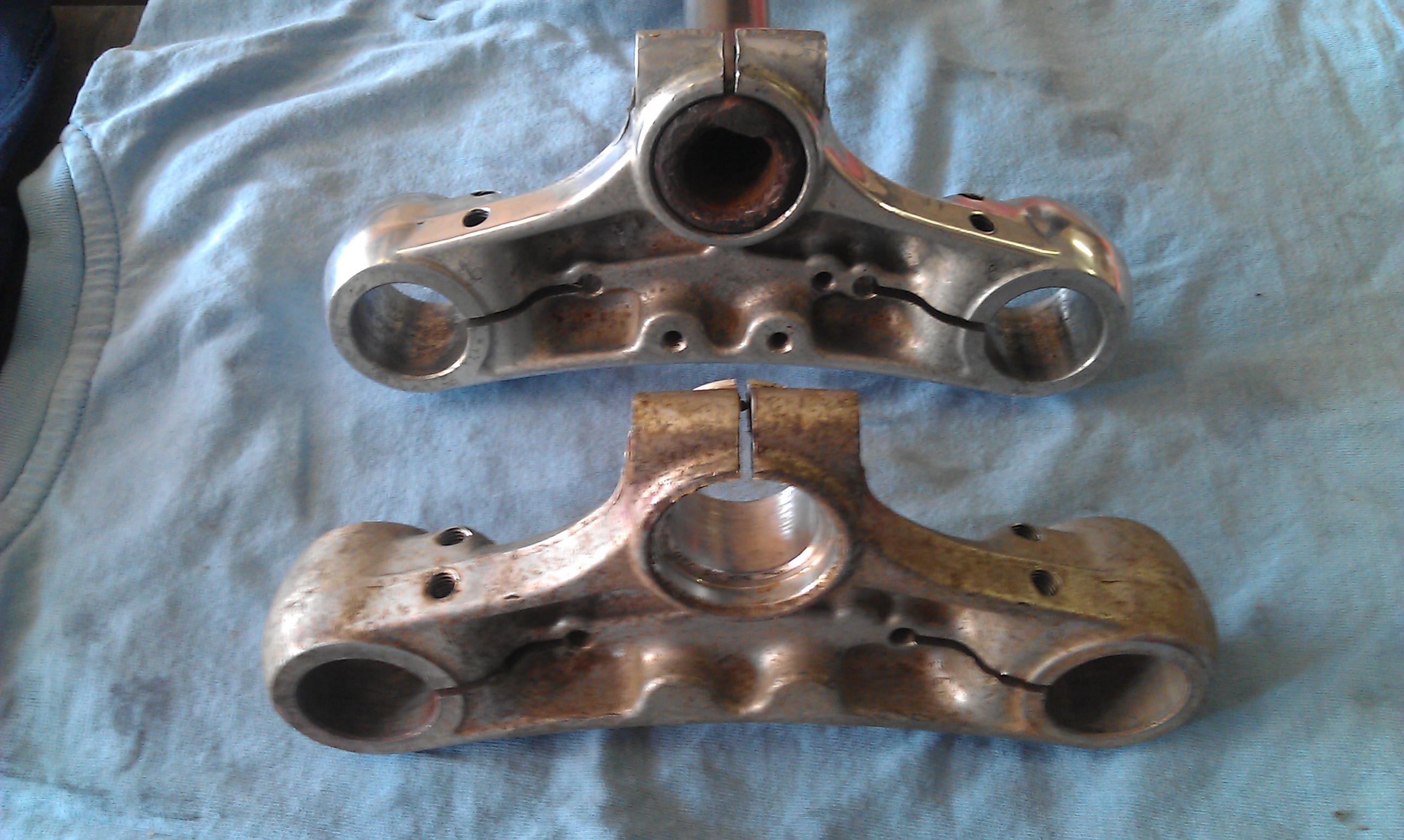

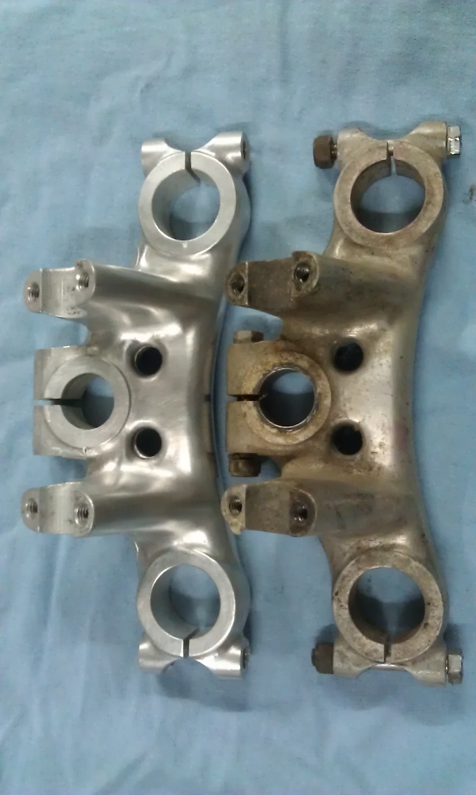

- Posts: 4118
Another difference between the two TY175 models is the lower triple clamp as can be seen in this photo. The TY175JC has three threaded holes in the underside that are not in the TY175 item
TY175 B - 545g
TY175JC - 540g
TY175 B - 545g
TY175JC - 540g

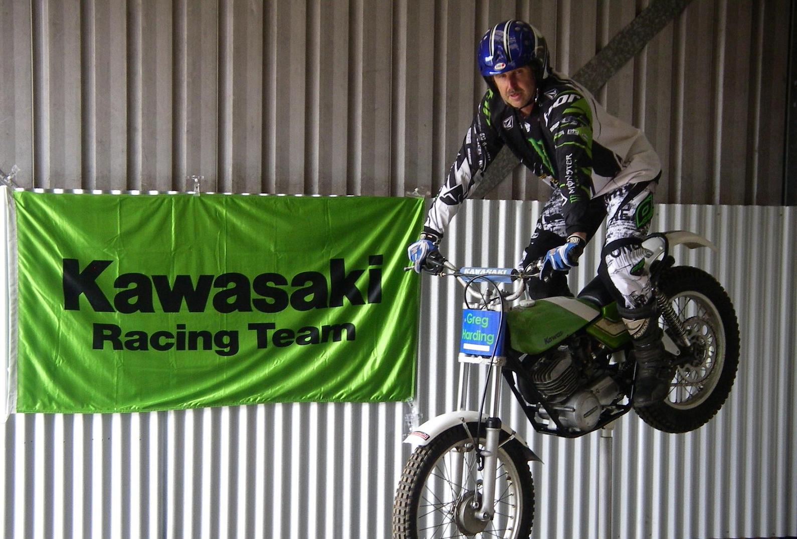

Hi Greg, I don't proclaim to know anything about the KT's infact I have never riden one. You say you have your bike dialed in. But my advice would be to soften the fornt fork springs they don't seem to have compressed much when you done that nose wheelie in the photo. Ha Ha
