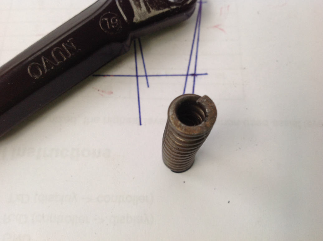

I slid a slip of paper between the leg and mount to see where it was touching. The paper was not restricted between the two so the problem is the spring can't push up enough to make its range further.
One way
The other way
So if the leg is recessed a little the spring would still be restricted by the side wall but could move up
Posted: Thu Oct 06, 2016 7:39 pm
by Tioli
A little extra dremel work to make sure.
The spring is just chopped off and rough
Clean up some so it slides nice.
Now the paper jams where the two meet. now metal can be taken away to extend the range.
When in place the mount block is on and angle and deffently not in the V of the frame.

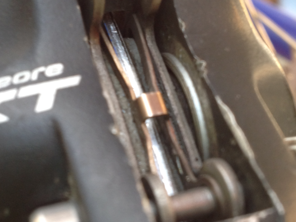

After a few test brake runs there is the beginning of a ware patten. What's interesting is the ware strip goes to the outside edge when I would have presumed it would be evenly spaced between the two outer edges.
The pad seems to be protruding above the disc
The shimano adapter measures 17.7 high
With the Chinese one 18mm which would make some difference.

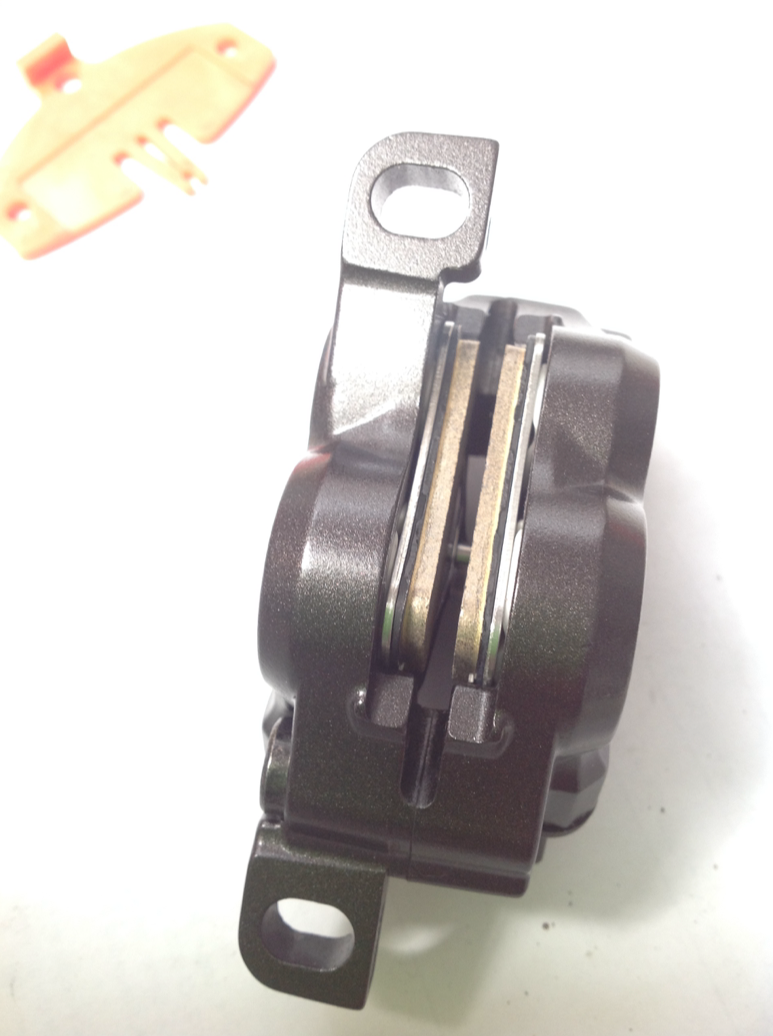

Posted: Fri Oct 07, 2016 8:32 pm
by Tioli
If I run a fine file across both at the same time it comes up crooked. I'm a bit over this buy it twice Chniese stuff. You buy it once then realise it's not as good as you would like so buy it again properly.
The post mounts also have a few paint flaws
I have two pad separator springs, one thick and very springy and the other thin and weak. I guess the same applies hear as well.
All togeather with the Japanese parts and were good to go.

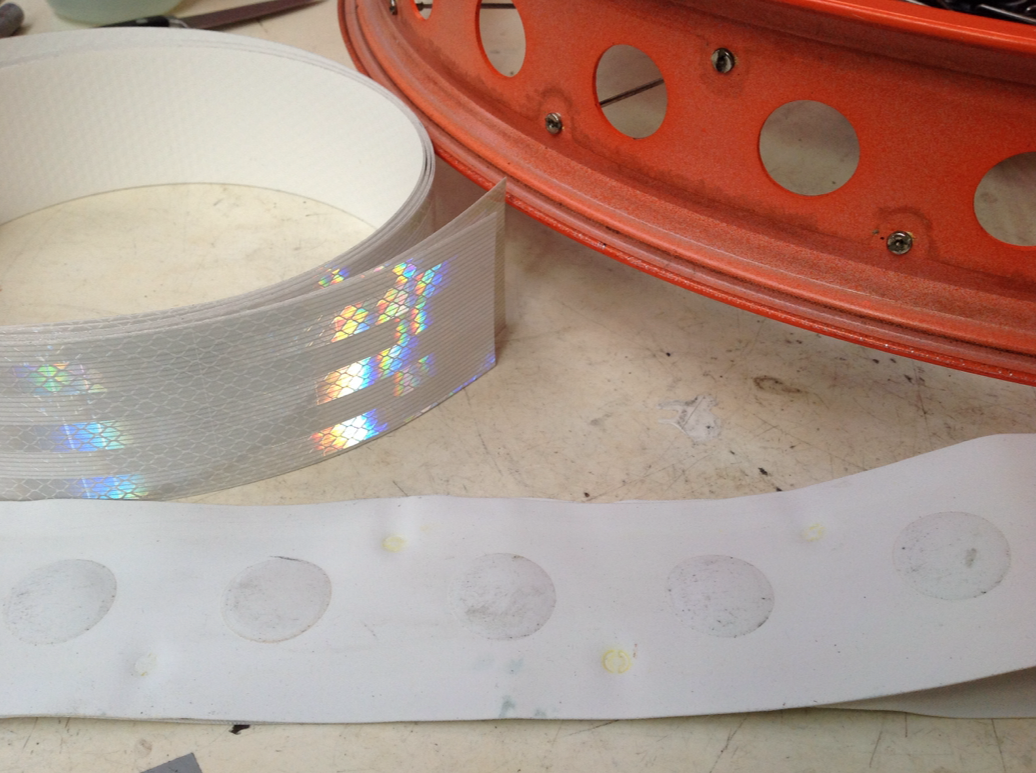

Posted: Fri Oct 07, 2016 8:52 pm
by Tioli
I couldent help myself and got another rim band. Safety first of course.
When I ordered the original white one I was thinking gloss white but it ended up being mat white and quite rough. At the tome it was questionable as to how it would stand up to grease and dirt from greasing the chain.
There is a lot to be said about these fat wheels. The grip is phenomenal, the material is light and thin so you don't need tyer leavers. Just let it down and pull it apart any way you want. You can run between 10 - 20 kp depending on what you want from them.
Only thing is on the road or concert bike trackers at above 30 kph they raw like 4 wheel drive tires

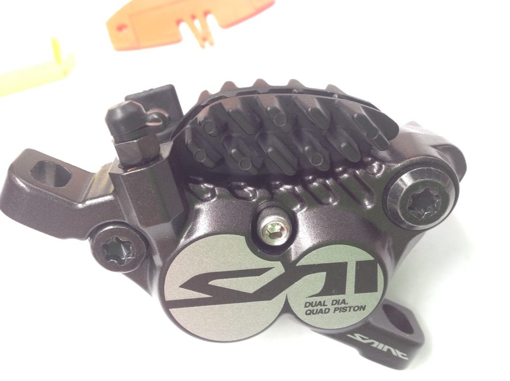

I was so excited abut the front brake upgrade. Read all about these 4 piston ceramic calipers.
Have never had ceramic piston brakes.
Pads are bigger, sintered and have fins to dissipate heat.
The spring decider is there to hold the pads apart further for better cooling.
Small compared to a motorbike but as usual higher quality.
