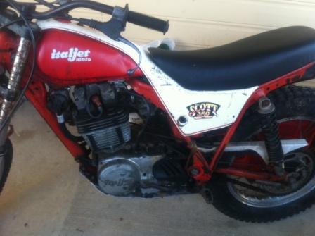

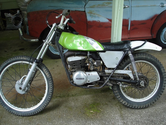

I found a photo of my Italjet Scott when I first bought it and as you can see, it is very rough and it hasn't progressed much at all. Yes Greg I can hardly wait to hear it run myself. I believe my bike was possibly originally bought by Robert Gough and had a sidecar attached as I have noticed some signs of where it would have been mounted..

Chippy, either the tank is small or the motor is big or maybe both? Looks fairly complete, have you done anything with the forks yet as they are quite rusty in the photo?

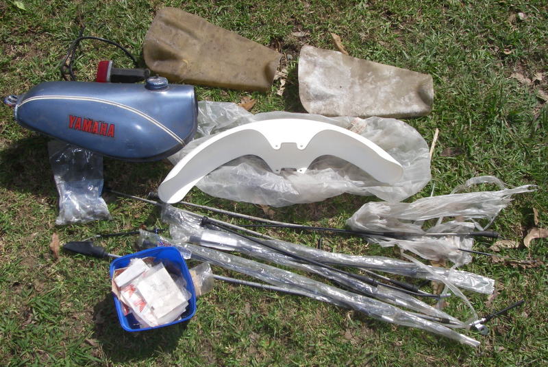

Donna is making quite the Picking Partner and we are both happy with the loot. Below is a photo of the TY175 parts that we picked up the same day for $50.00. We use a very simple formula of asking the right person the right question at the right time,EASY!

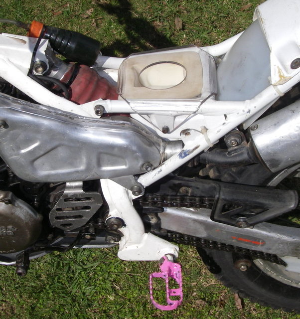

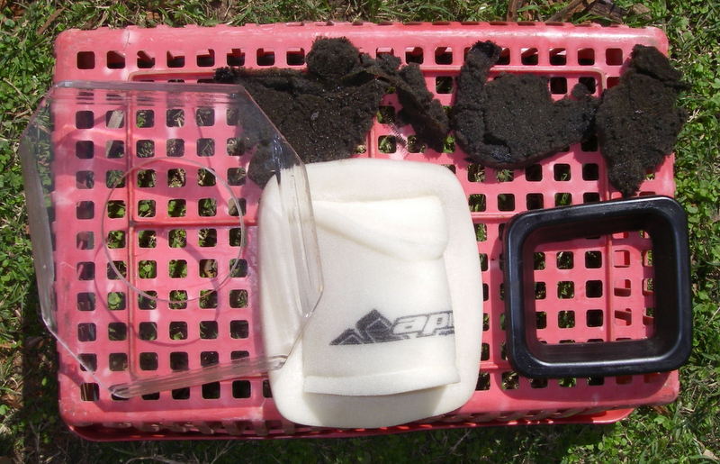

Now for the Totally Loved Machine, we have made a bit of progress.... Managed to pick up a 315/4RT air filter at the Queensland Titles last year and it fits really well into the TLM airbox, luckily the top of the box is flush with the frame, I only had to make a polycarbonate retainer, almost ready to ride!

Gav, Job done, we are both very happy with the $200.00 investment, shaved 7 kilos off the Totally Loved machine (thats a 5kg bag of potatoes and 2 litres of milk!)

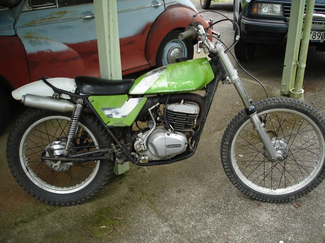

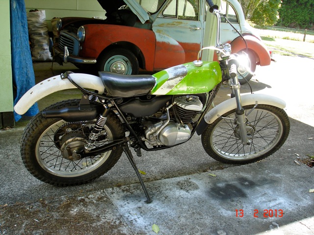

KT250 new life. Before and after photo's.Not a show piece but now looks like it should. Replacement mudguards,forks, fred's springs,fork seals, handle bars,levers, muffler,air cleaner,rear sprocket, fred's fuel cap,grips,various springs and frame sandblasted, welded and powder coated. Bank balance badly depleted.No side covers yet. Cheers Ross.

Straightpipe, your KT looks good, there is quite a bit of difference between the before and after shots. Did you notice much difference in bottom end power when you fitted the original rear silencer?

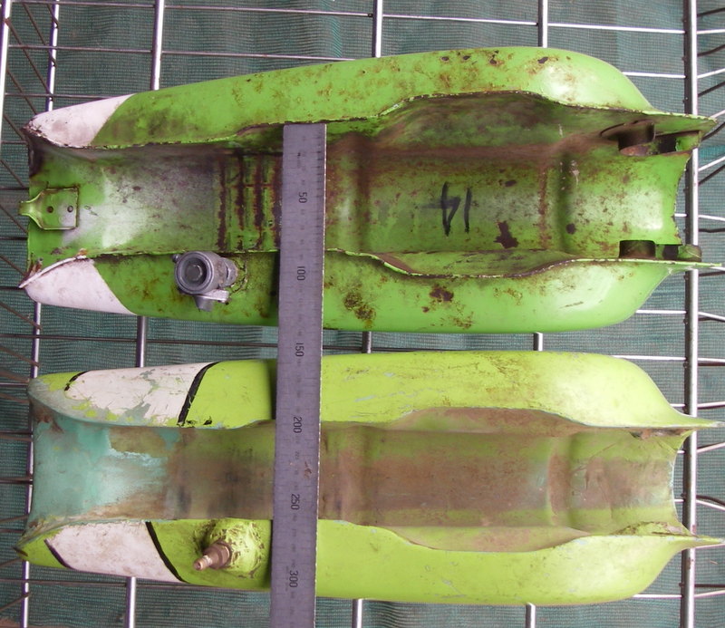

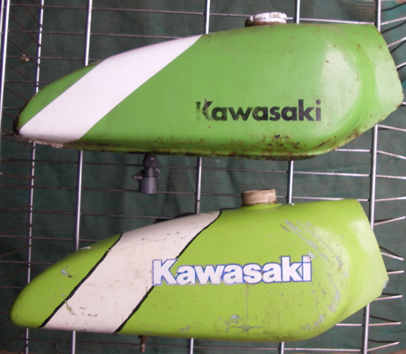

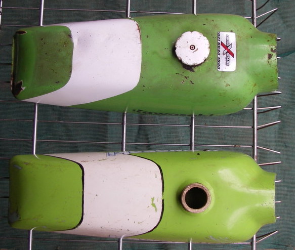

David, finally got some time to do some comparison shots for you, the fibreglass tank is about 250 grams lighter and is closer in dimensions than I first thought. Obviously a mould was taken off an original tank, time and probably sun has closed the middle gap so much that it won't fit FrankenKT! Would have to make narrower tank rubbers and modify the CDI unit and mounts to maybe shoehorn it on. Alternately, it would make a good plug for someone who is good with fibreglass? Anyone want a project?
Tried the CDI unit and coil that came with the tank and both work fine, HAPPY DAYS! Even had the genuine cap with the big K on it, fitted it and the tank now clears the plug cap, I was never happy with SPARK and FUEL rubbing together.

Thanks for doing those measurements Greg. Some one has gone to a lot of trouble to make that tank. It would have been nice for you to be able to use that lightweight fibreglass tank.
I seem to remember that the Clarke plastic tank made to fit Honda CR125 will fit the KT250 and the TY250. I was almost motivated enough to have them make one in green for me a few years ago, but I love the look of the original KT250 tank shape and stuck with it and the panel beating and spray painting that goes along with metal tanks in trials use. If anyone is interested, I asked about it a few years ago and they offered to make me a green CR125 tank even though they only list them as being available in boring Honda colours on their web page.
My HT lead rests against the fuel tank weld seam and I've always wondered how much of the spark energy leaks to earth via the fuel tank!!!
I just looked at the Clarke webpage and it has changed a bit, and the only one that looks about right is a model 11336 and is said to have a tunnel 2.5 inches wide, which may be a bit narrow judging by Greg's photos
