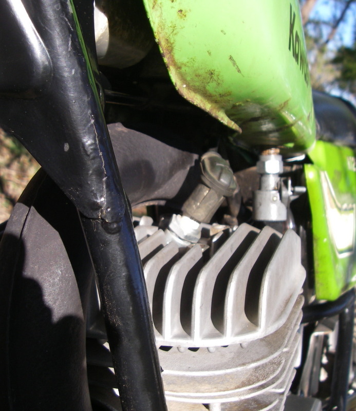

David Lahey wrote:My HT lead rests against the fuel tank weld seam and I've always wondered how much of the spark energy leaks to earth via the fuel tank!!!
David, probably a good think that the tanks are rubber mounted and use a non conductive fuel line!!!
Ross and Julz, re idle problem, my advice is to check the carby has no blockages or restrictions in any jets or circuits. Fitting the floats upside down may effect the float level when fitted the correct way.
Decided to post a photo of original spark plug cap fitted to FrankenKT, much better than the bulky cap I was using.

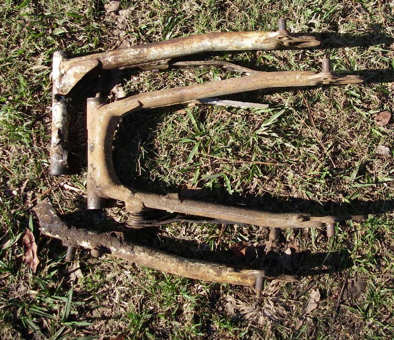

David, your "A" model is in really good nick, wonder how many others are still with the original owner after all those years. My "B" model came to me with an already broken swingarm. Here is a photo of it
IMGP7151 - Copy.JPG (164.99 KiB) Viewed 5972 times
with a 175 swingarm which is pretty much how the "C" model onwards gussets were made.
