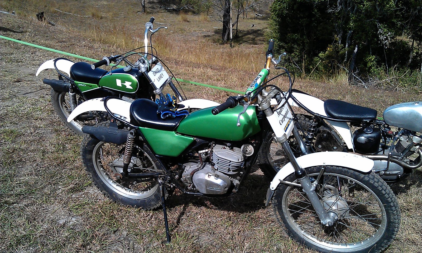

Especially for the KT250 lovers - there was a slight concentration of KTs being enjoyed on the terrific sections at the CQTC Queensland Mototrials Series event at Calliope this weekend. At the end of day one, both KTs were still going strong

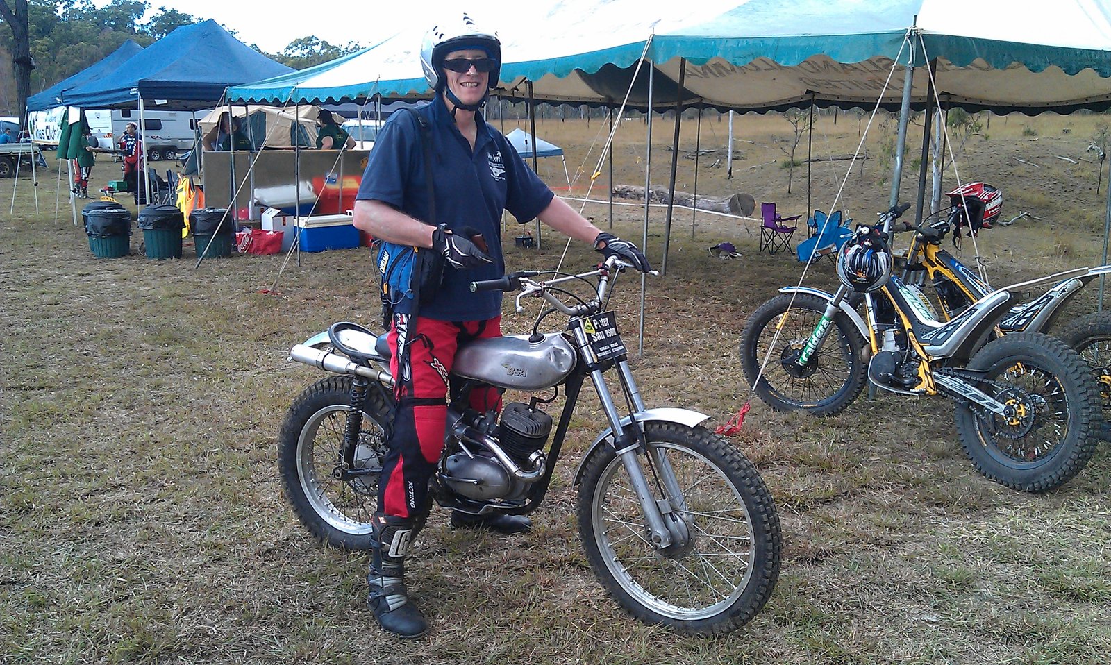

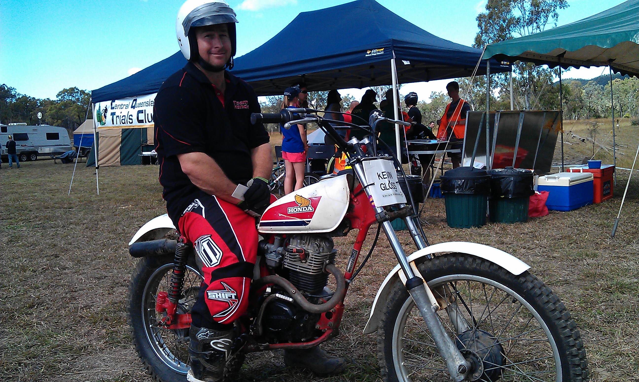

Some more twinshocks at Calliope today - Kevin Gloss on his amazing AG bike, or more realistically, amazing Kevin Gloss and his AG bike. Second photo shows two of Kevin's family riding team

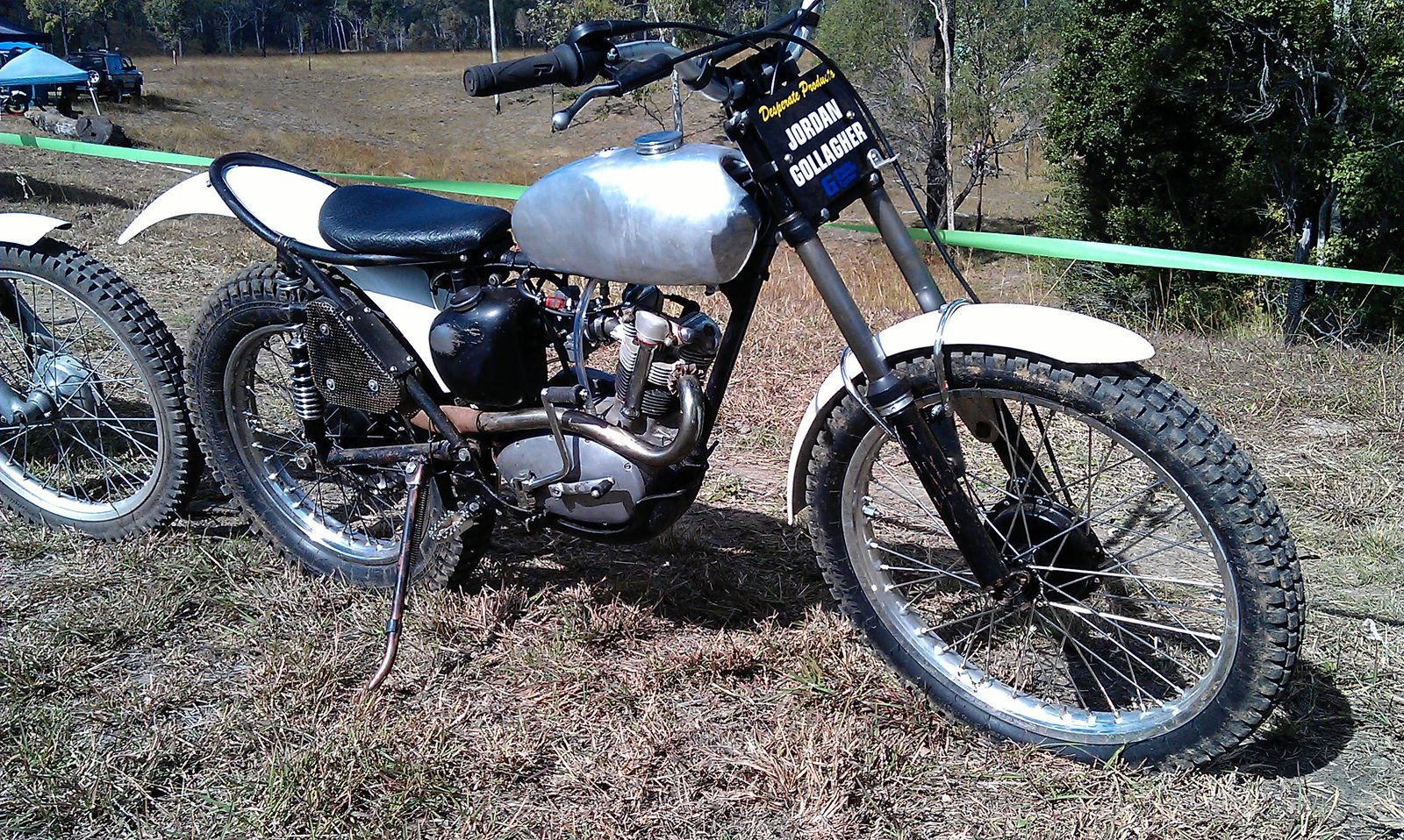

Posts: 4118

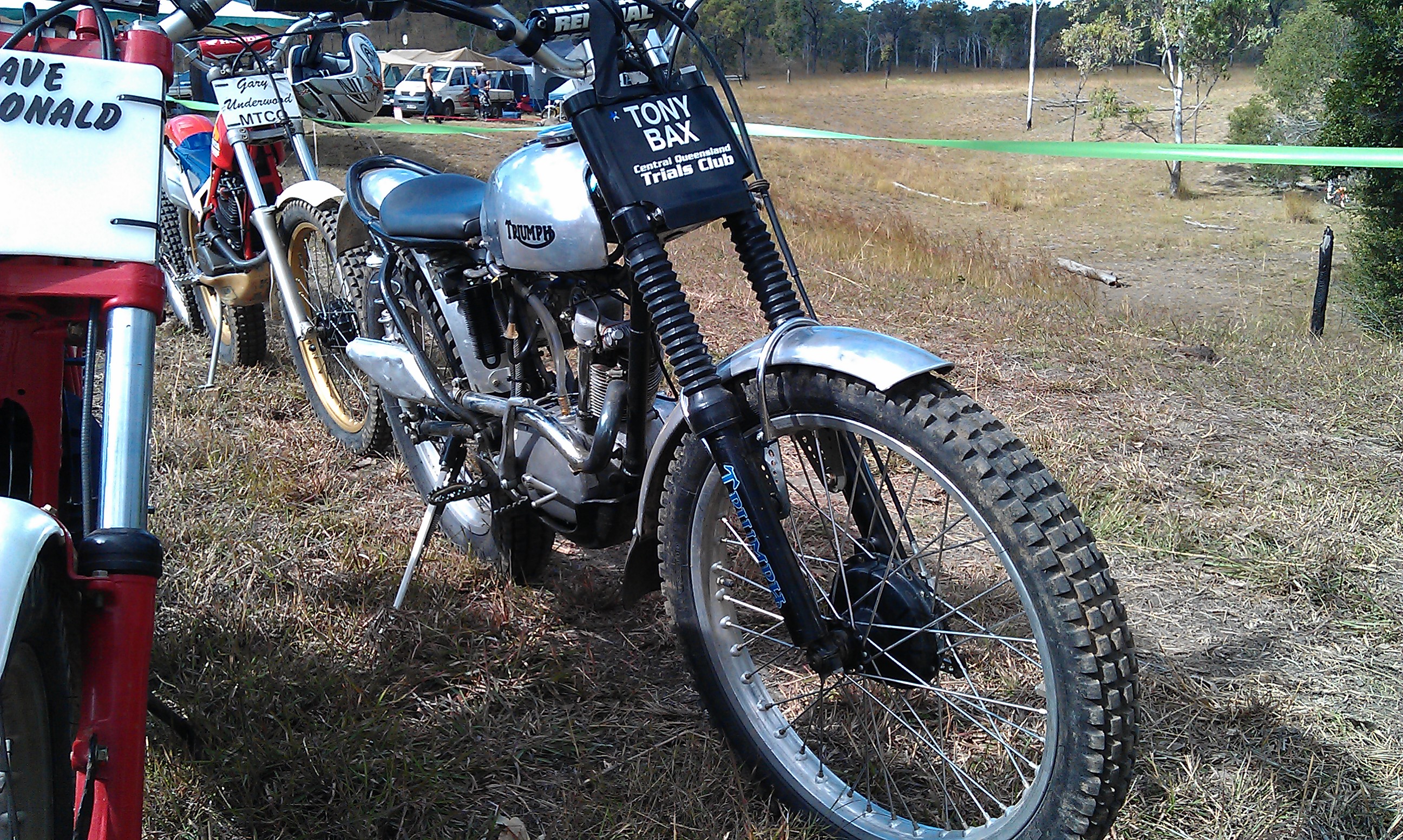

Peter Sampson on the only two-stroke Classic P65 at Calliope today, riding amongst a sea of Triumph Tiger Cubs

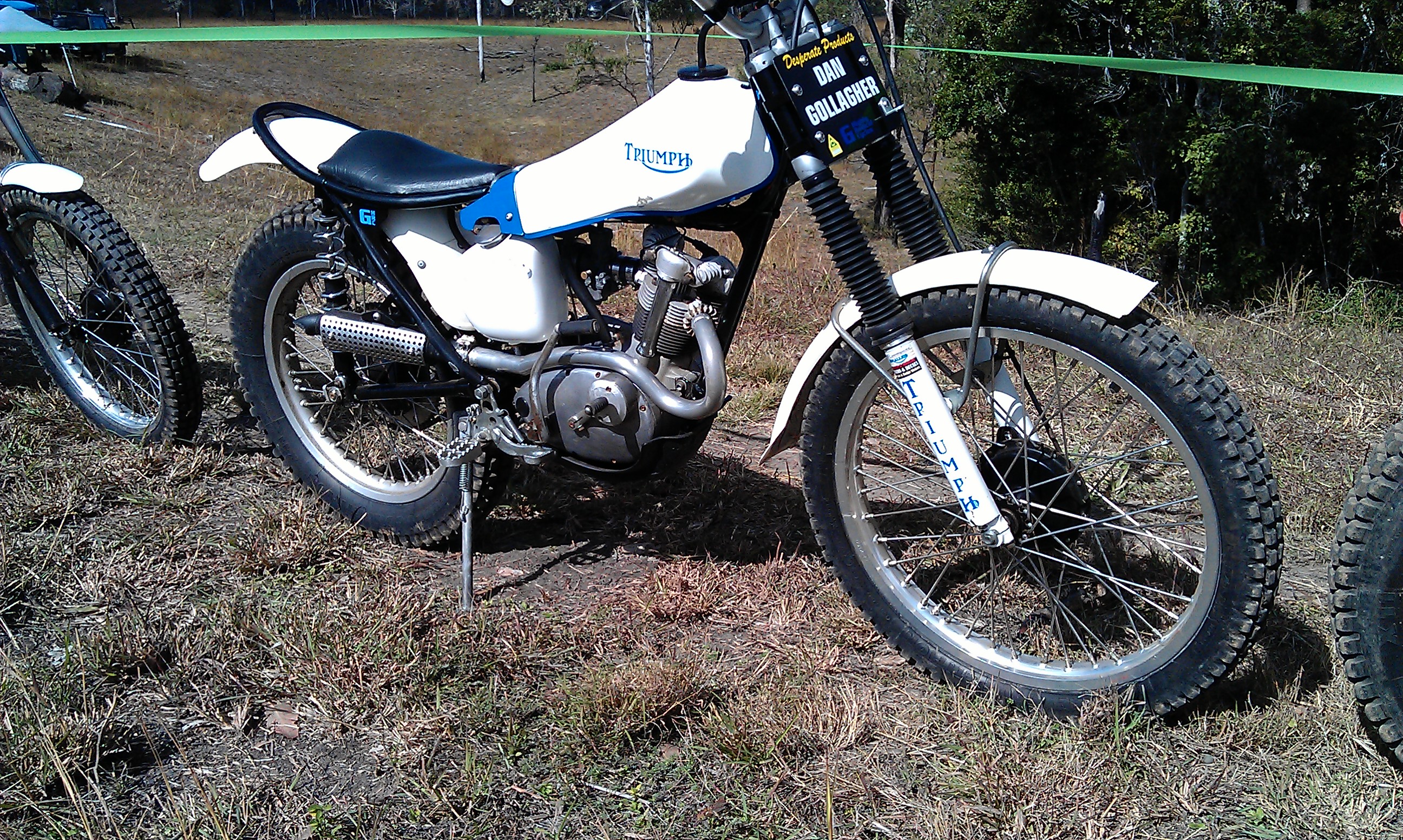

and the Tiger Cubs

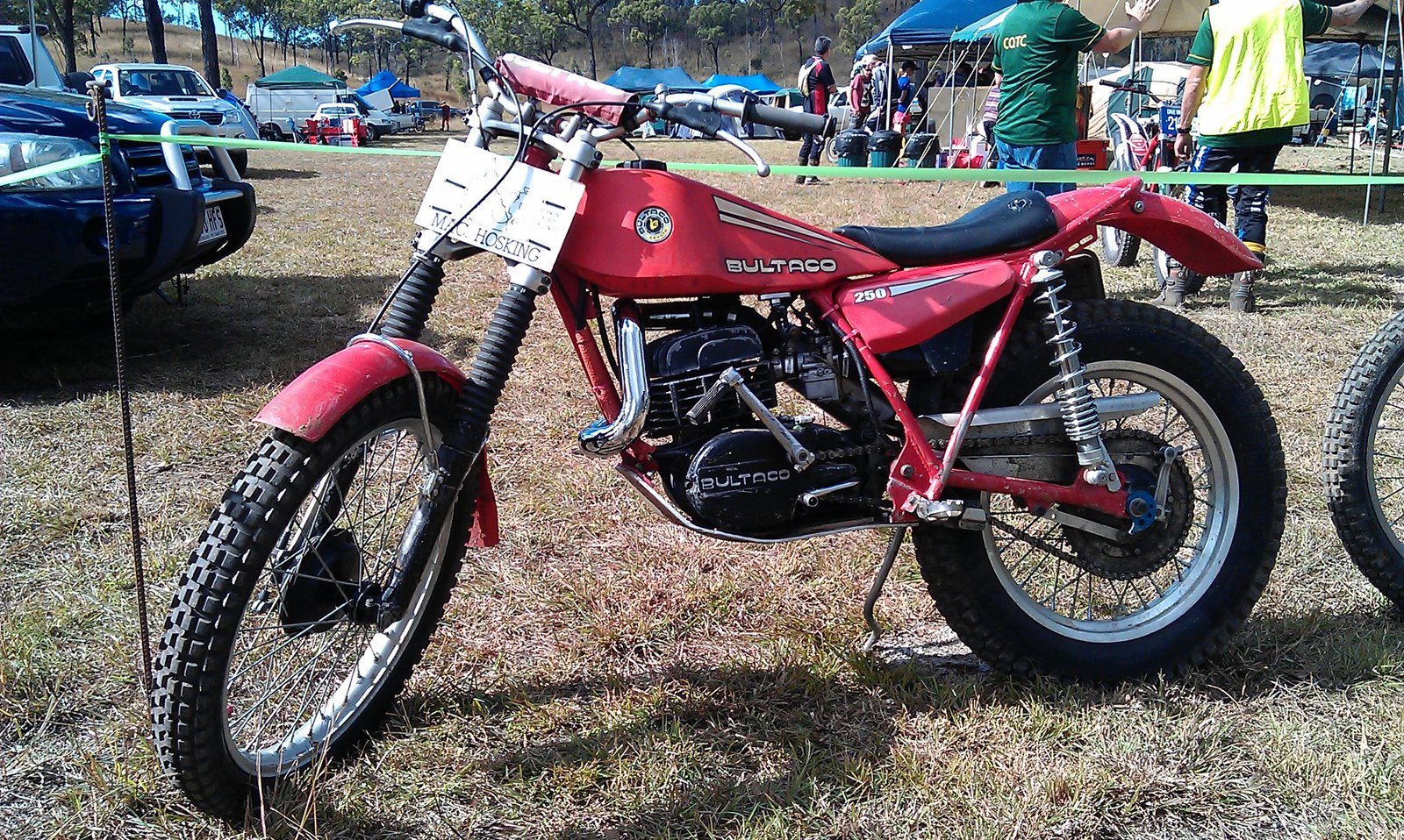

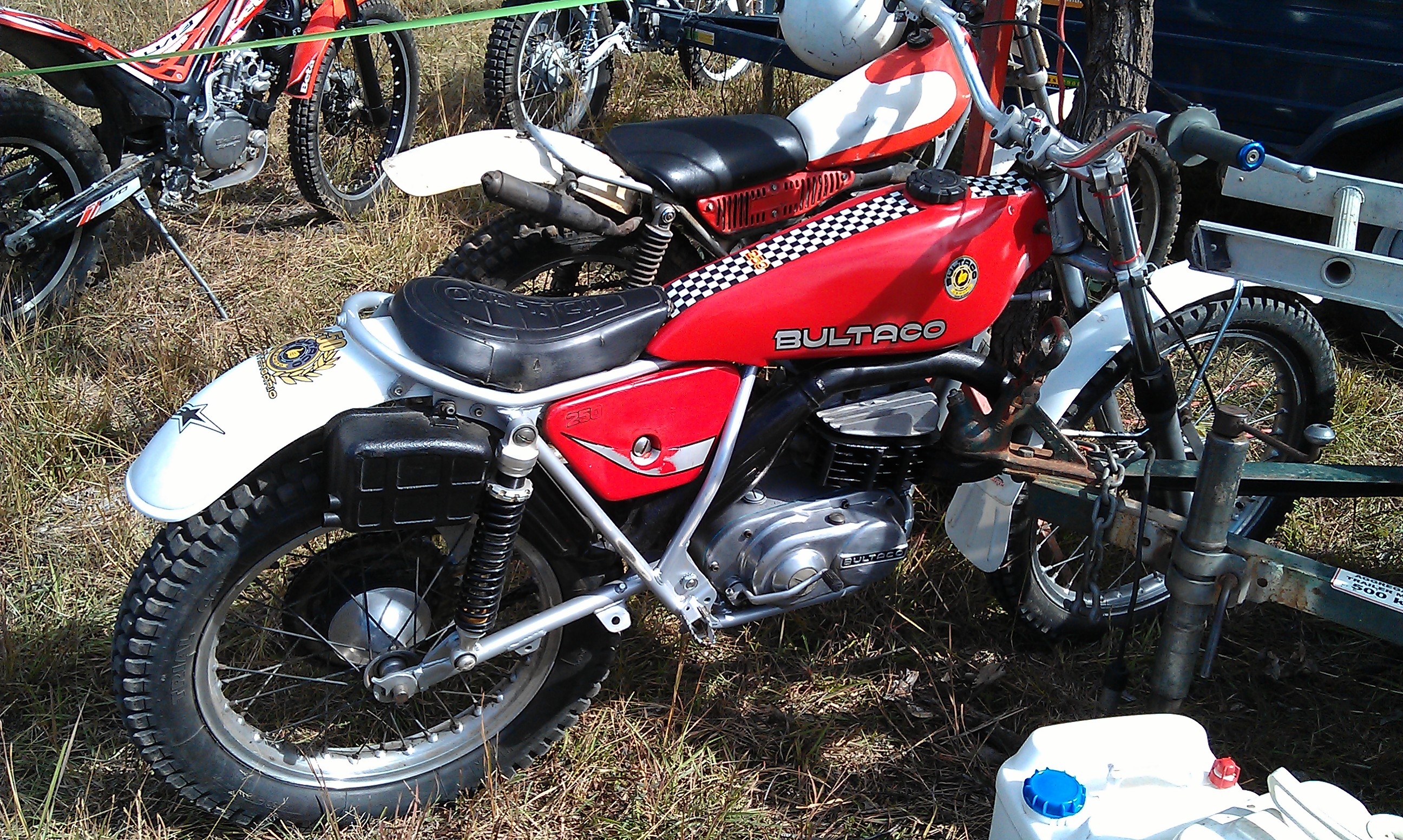

There were two Bultacos
