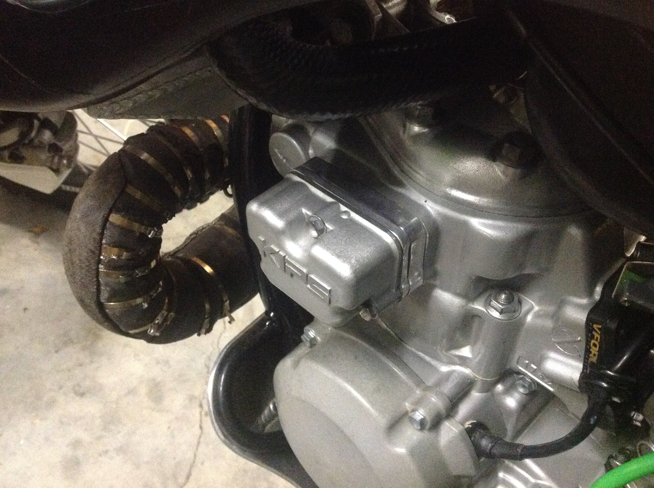

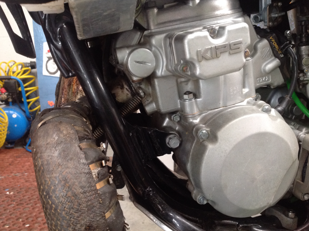

Never did get to map that.
Went from stock to 15mm. With out ever knowing I would say 5mm is not enough 10mm is better and 15 is close. 20 may be it.
Tuned it the normal way:
Make a prediction adjust Watch.
It achieved what I wanted so never touched it since first test to the max setting first to see what it does.
I think opening the powervalve earlier may shift the KIPS balance.

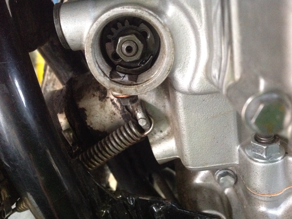

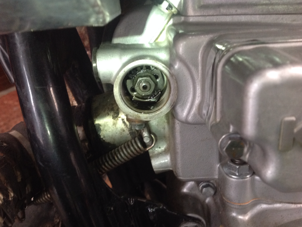

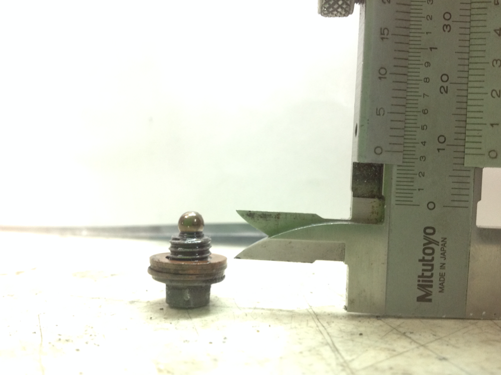

The easiest way is to loosen one of the governors.
Tioli
Posts: 756
Bike: ty175je , KDX/KX ,,,
Location: Tas

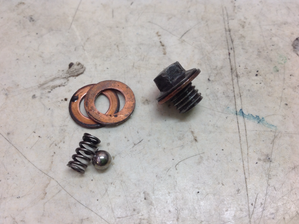

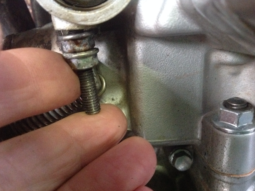

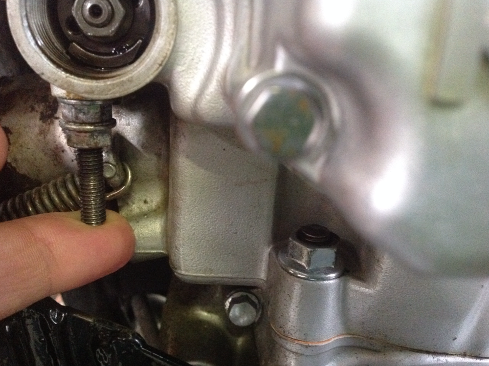

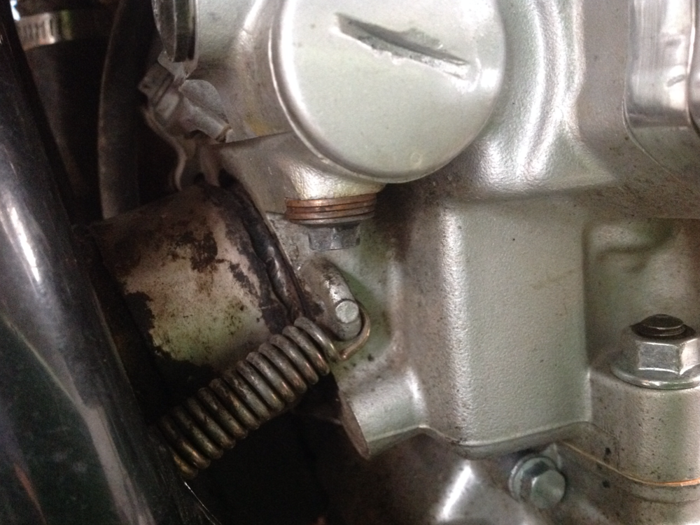

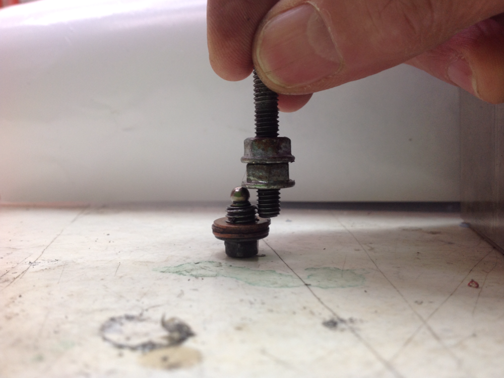

Post by Tioli »
Seems I have been hear before. Two washers is standard I think.
Clean enough seems good.
So if it's that. All it dose is put preasure on the power valve shaft to slow its opening.
Tioli
Posts: 756
Location: Tas
Post by Tioli »
It's a bit hard to get to so if I
Then tweek it up till it stops rocking
I'm done
That looks like one more washer.
Or just remove it all togeather.
Peice of paper in there to check clearance and alls good.
See what happens.
