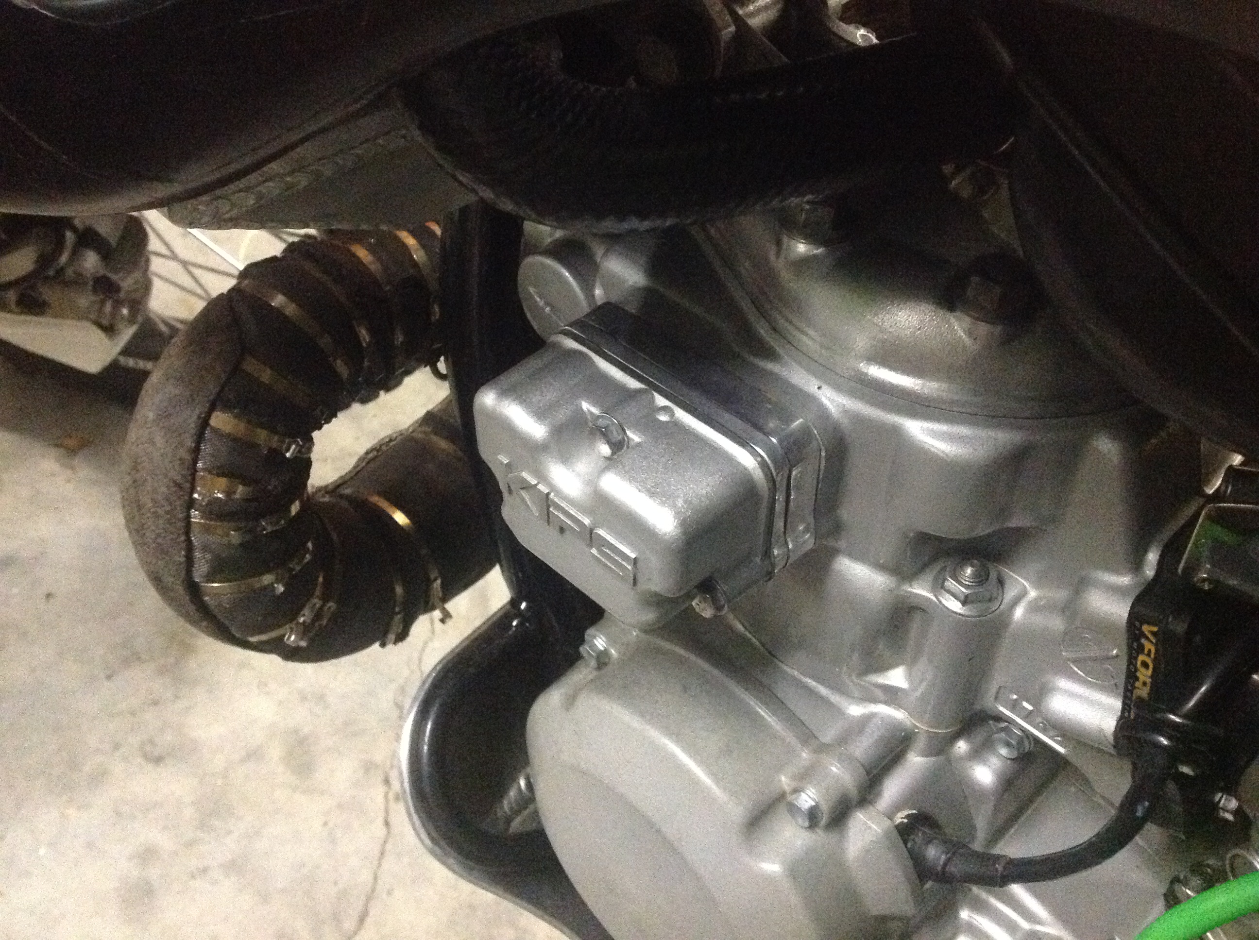

I finally get that motor. It's what I wanted, bang like a trials bike down low and sing like an angel up high.
It bla bla blas faster till ignition.
It's all that carburettor below half throttle it acts like a trials size carb.
The volume may be less but the increased crank case preasure makes up for that and at 2/3 revs it ignites.
It's not how much it gives but that is gives so much.

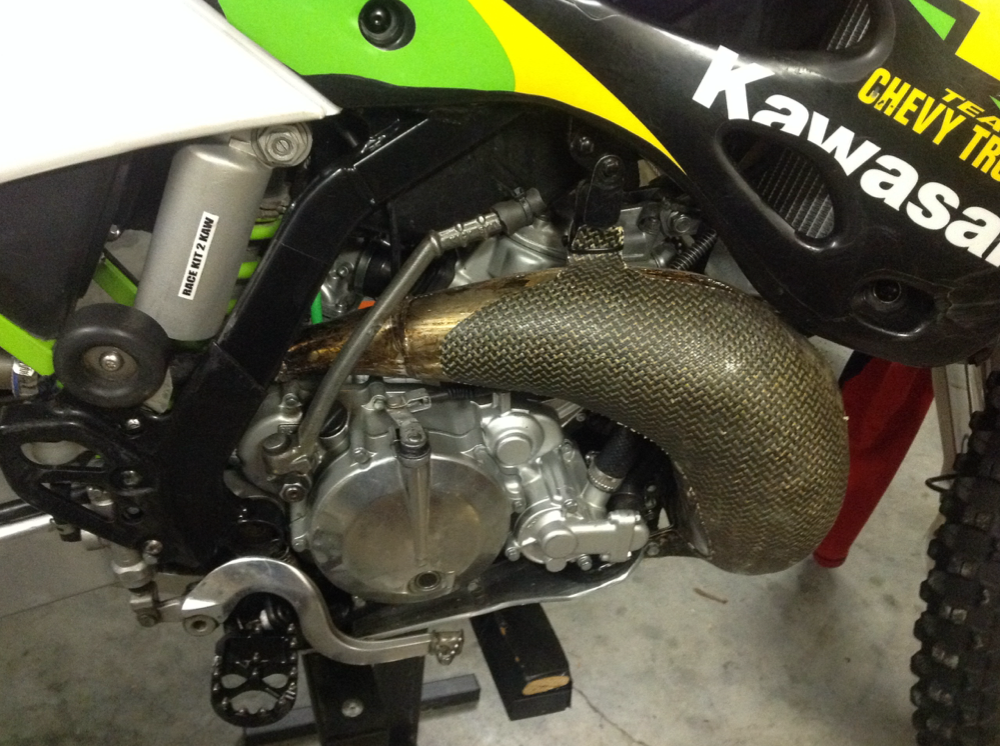

Posted: Fri Jun 08, 2018 9:35 pm
by Tioli
The way it lights shows its at full power. Open the power valve earlier for more.
My friend on a Ktm300 says "god that thing's sharp. Yer but so is yours. Not like that it's not "
Posted: Fri Jun 15, 2018 8:50 pm
by Tioli
Never did get to map that.
Went from stock to 15mm. With out ever knowing I would say 5mm is not enough 10mm is better and 15 is close. 20 may be it.
Tuned it the normal way:
Make a prediction adjust Watch.
It achieved what I wanted so never touched it since first test to the max setting first to see what it does.
I think opening the powervalve earlier may shift the KIPS balance.

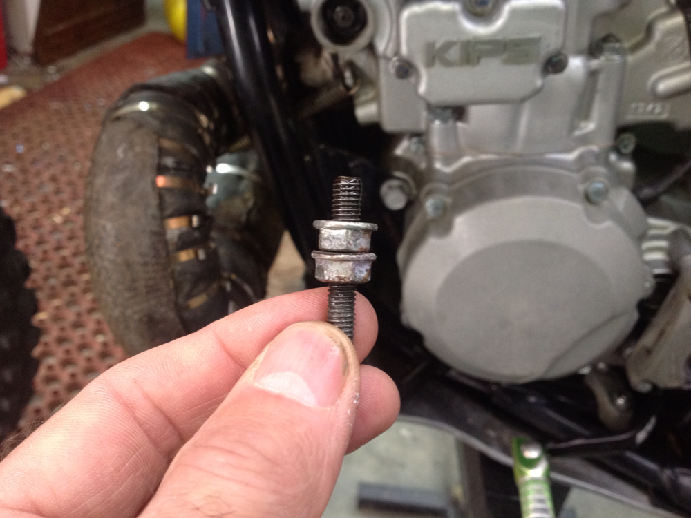

The easiest way is to loosen one of the governors.
Posted: Fri Jul 20, 2018 8:55 pm
by Tioli
Seems I have been hear before. Two washers is standard I think.
Clean enough seems good.
So if it's that. All it dose is put preasure on the power valve shaft to slow its opening.
Posted: Sat Jul 21, 2018 10:44 am
by Tioli
It's a bit hard to get to so if I
Then tweek it up till it stops rocking
I'm done
That looks like one more washer.
Or just remove it all togeather.
Peice of paper in there to check clearance and alls good.
See what happens.
