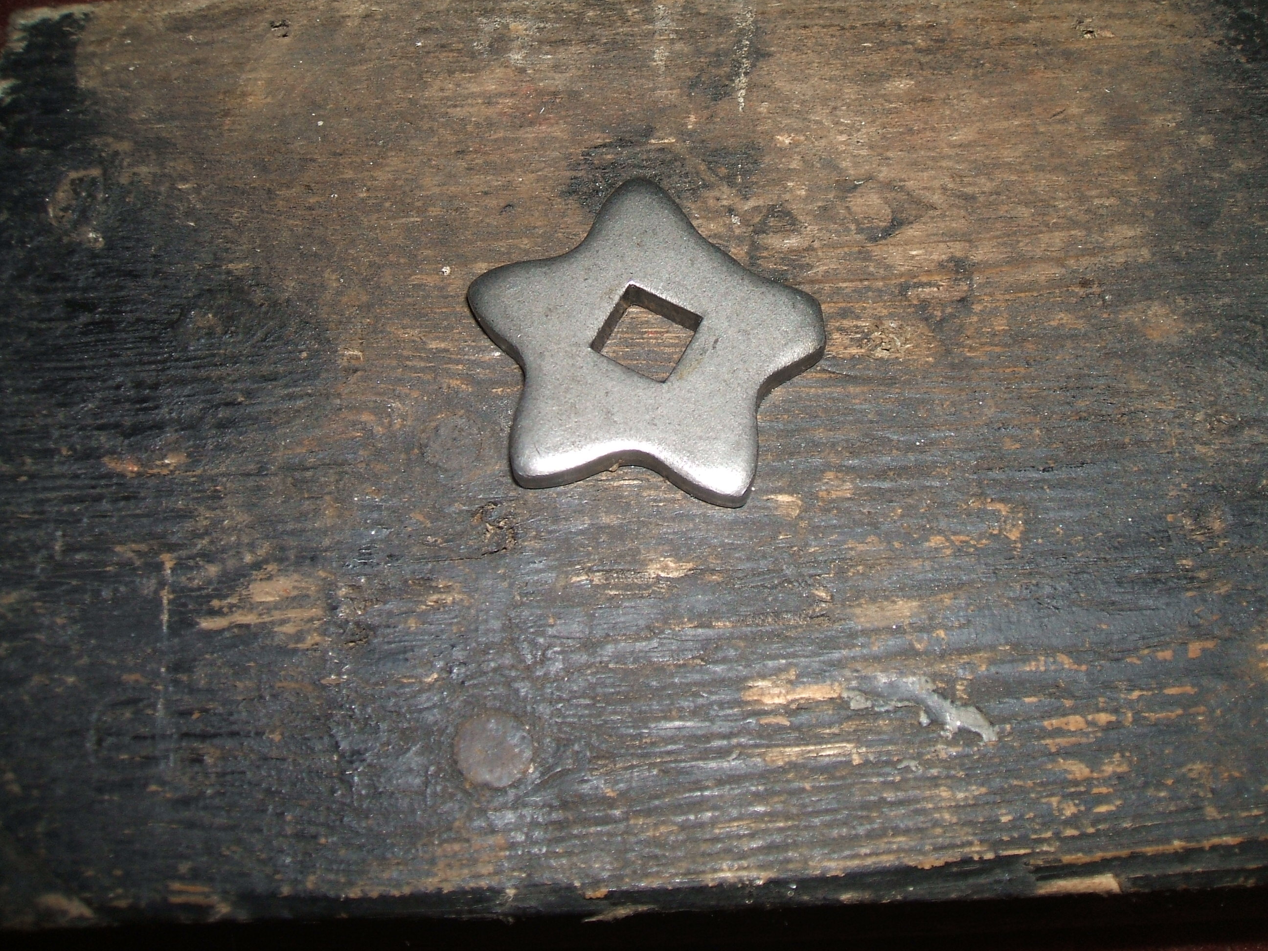

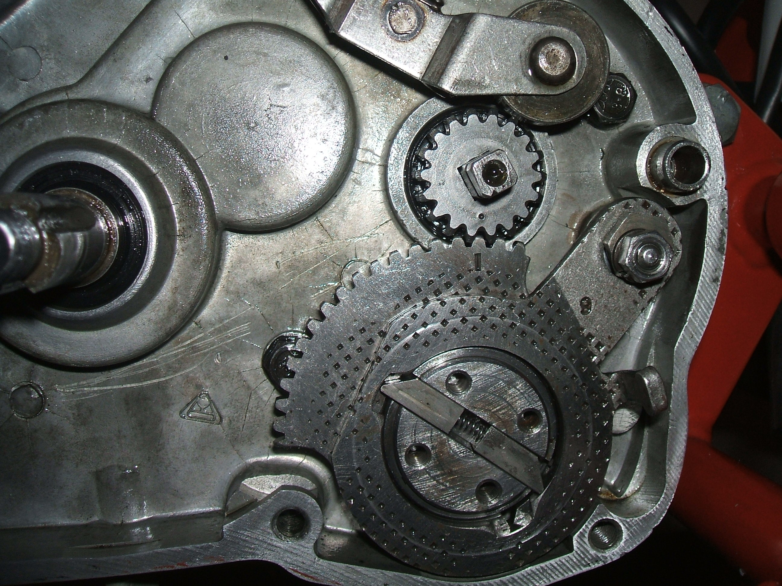

hi,
I have a Ulf Karlson 1982 Montesa 349 does anyone have a picture of the correct set up of the gear selector when the bike is in neutral. the stamped marks are aligned on the selector gear, but what's the correct position of the (star plate) that sits under the roller when in neutral ?

Post by Kombivan »
Pages 2 & 3 show the photos of a 79 349 and the position of the star is the same. The selecter mechanism that hass the spring anchored is different to the later 349's 80 onward. But the star is the selector rocker thingy and sits the same. as the earlier model. :montesa

Post by Kombivan »
Looking at your own two pictures just rotate it 180*

Rod wrote:
Kombivan wrote:I think I have it set up correctly. In the manual there is a spacer behind the gear shaft this must be to compensate for the change in the position of the shift plate. :D I don't have to pull it apart again.
{A kind note from Southwest Montesa
Bill,
First off, in the states, we refer to the 1st model of the 349 as a 1980 model. (the fuel tank had the fuel level indicator) the 80' model used the same shift components
as the 79' Cota 348. This had the fixed post, screwed into the case for the return spring. Very late 1980 and 81' models used the 5166.01302 plate that had a tang
that took the place of the screwed in spring post. Only other change was the shift shaft. 1980 models used the 7366.118 shaft (this is the mx shift shaft) Later models
used the 5166.118 shaft. This later shaft had the spring post hole mounted in a different spot to take in account the different spring mounting on the plate tang.
Mixing the two shafts will put the 0266.014 spring in the incorrect location to work correctly.
Later shift assemblies also used a washer (5166.138) behind the 2166.03601 shift mounting to slightly space out the shifter. Also there was a bushing (5166.137)
that went between the plate with the tang and the case. Both pictures are correct. Later models with the spring tang on the plate were mounted on top of the selector plate.
(plate with the teeth) opposite of the 1980 model. Hope this helps.}
Cheers,Jared
Very helpful fellow that Jared, what's that old saying, a picture(diagram) paints a thousand words.
