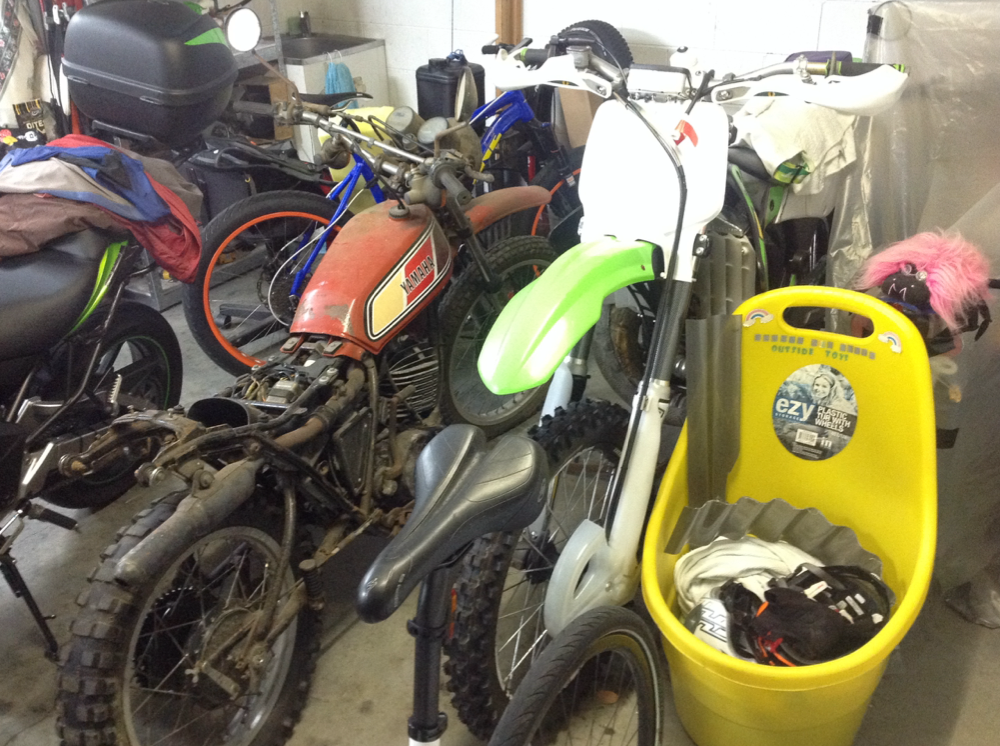

This is how far it lasted till it made itself known.
If I am ever going to restore a TY against I have some lessons to learn
And this is it
If I am to learn this lesson I need to know every turn. Some of my truths I take from reflection and there is a problem in that.
If I'm going to mess it up then I should know where

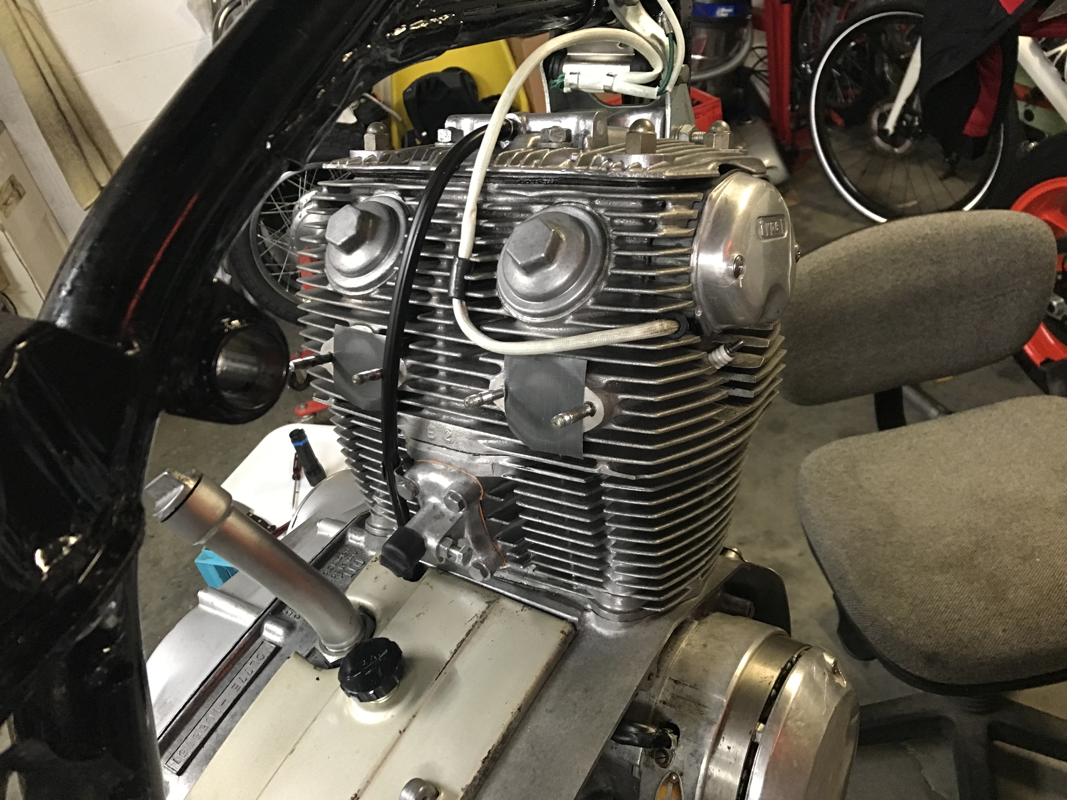

It’s been awhile but I’m back just realised my project fits hear so this is it

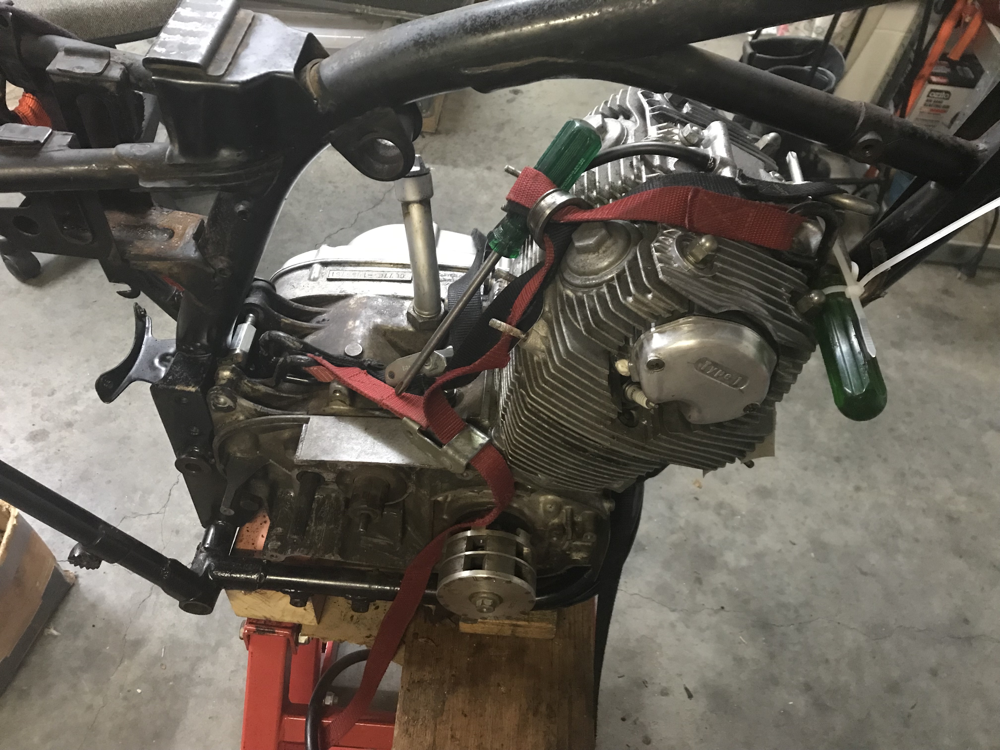

The Story of the “twin cylinder trials bike”
I’m in a vintage club and it appears to me that it’s not really a vintage bike after the 60s. Hence the need for a vintage bike that can sit on 100 and go bush As usual a bike made itself known, Honda twin import it’s condition is low mileage, old in design, been sitting for along time under cover but with dust on it so it’s rusted.

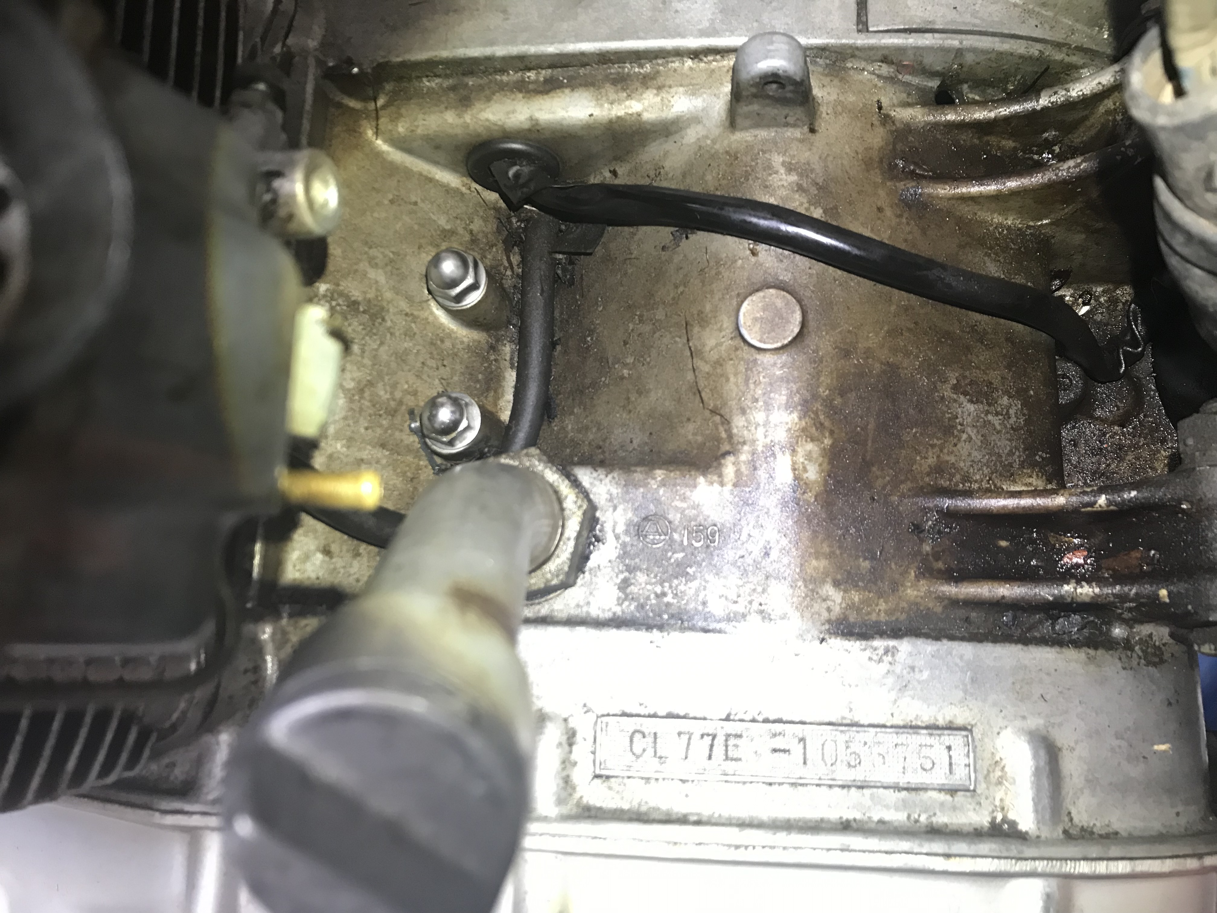

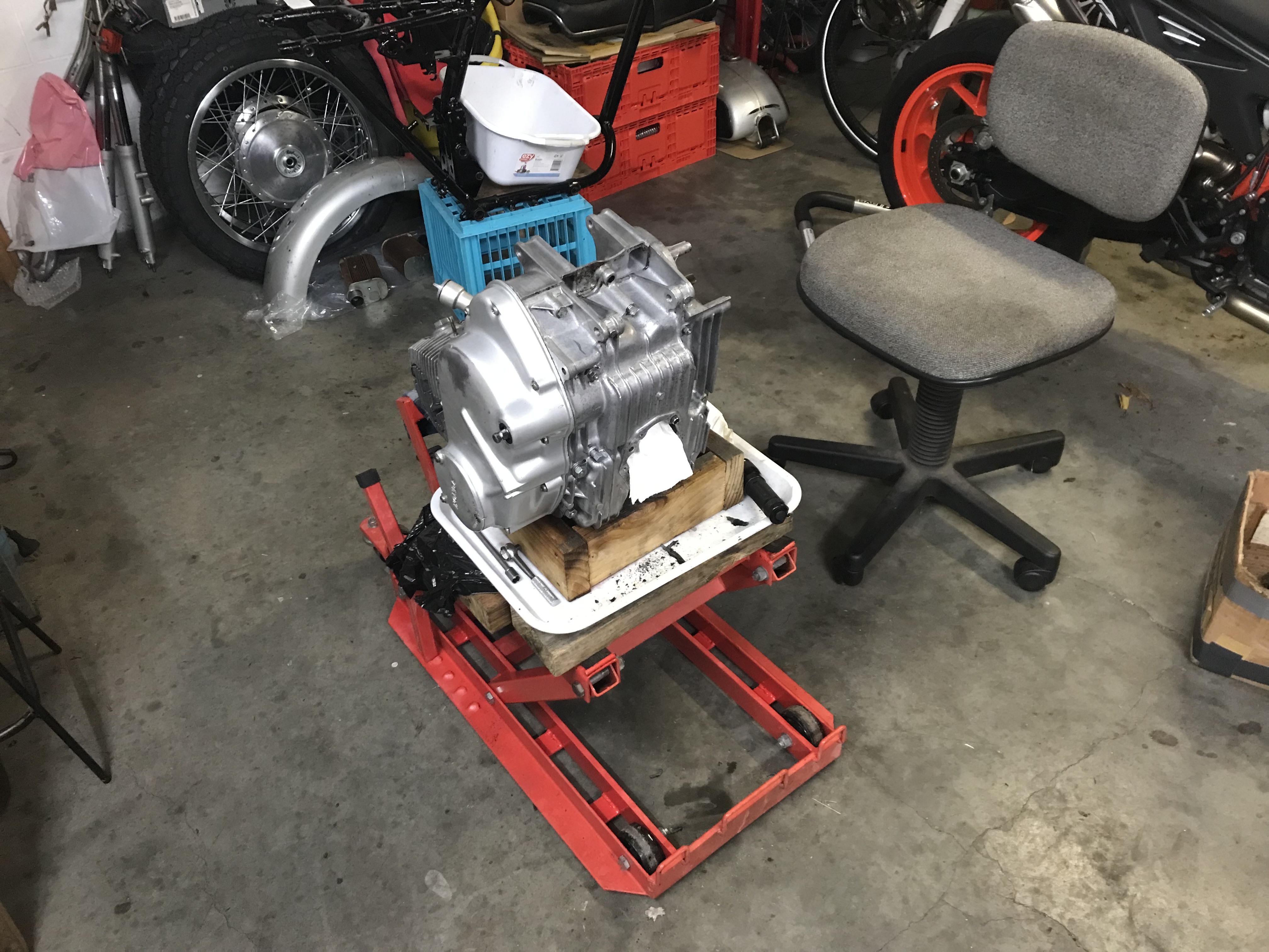

Setting up for hoysting note the condition

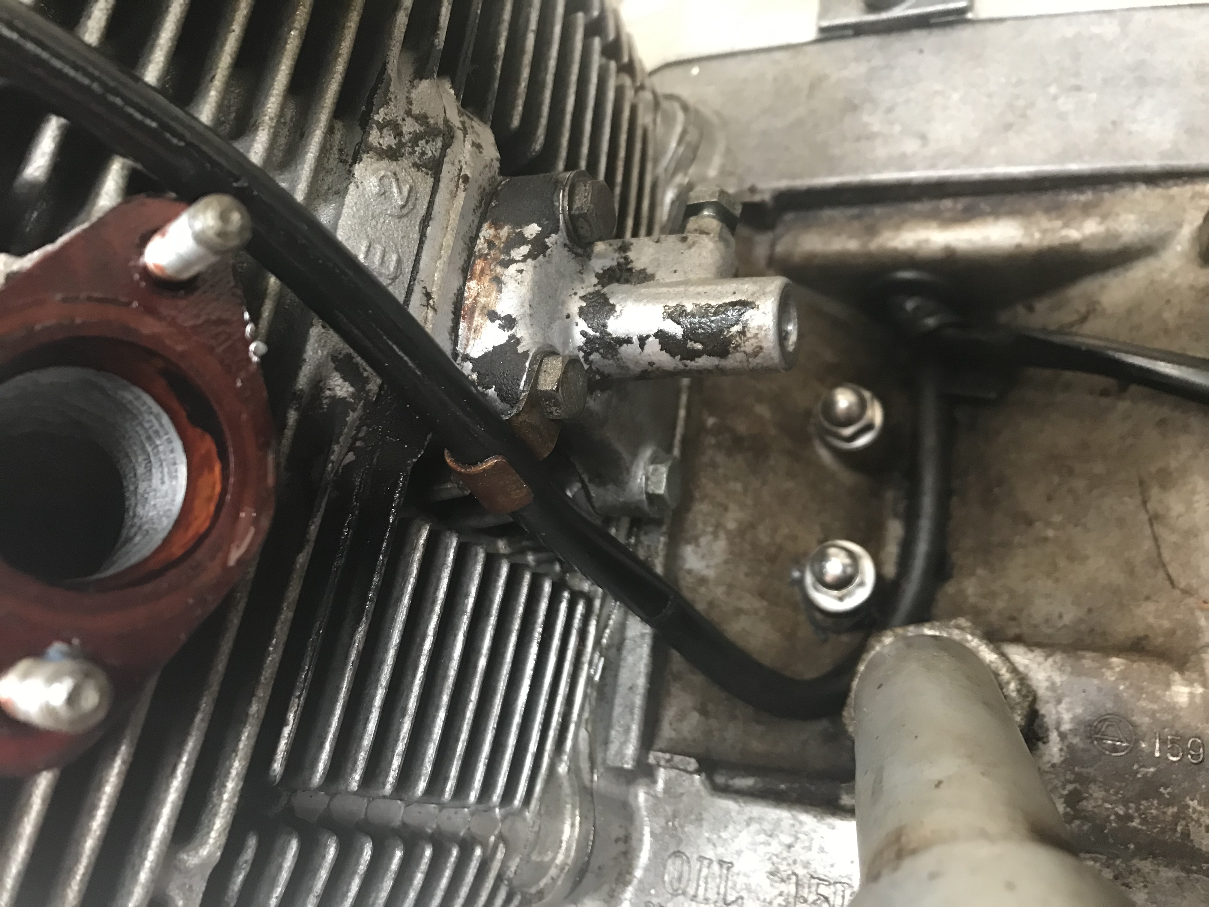

A lot of cleaning pulled some panels off for inspection and wiping internally best I can as it has a layer of black grunge where it’s not splashed with oil. In those days you didn’t use multi grade oils with detergents.
The cleaning and preparation for assembly goes some thing like this:
Petrol scrub
Parts cleaner scrub
CT18 scrub and scrub and scrub tooth brush where needed
Rust treatment varies as the paint is not modern paint and can dissolve from contact with some common chemicals.
After being cleaned like I have a problem the open pores are coated with either Penetrol, lanolin, or ACF50. Everything is coated with something after cleaning.
All ready to go back together

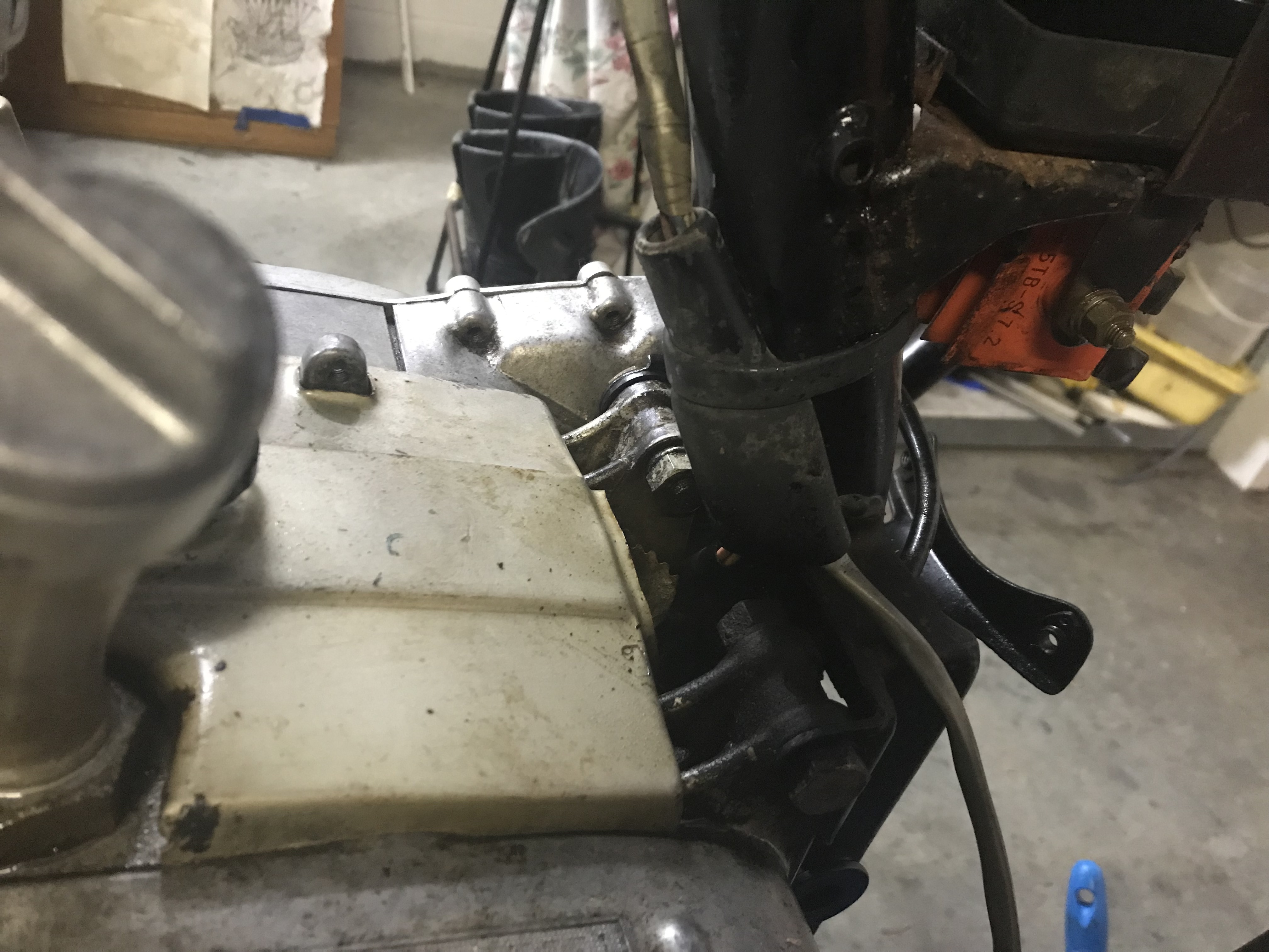

The aim is take photos as I dismantle it as a record for reassembling then take again after I have cleaned and serviced it.
The frame has a film over it but it’s still corroding so I clean it and coat it with a protectant I only use one of three.
I will keep the sprocket as it still has some meat on it.
Had to do some repairs to the generator lead wire sleeve for being had and cracked. Other than that it’s clean and protect. I can get it dirty in the future that’s just the bikes history continuing.

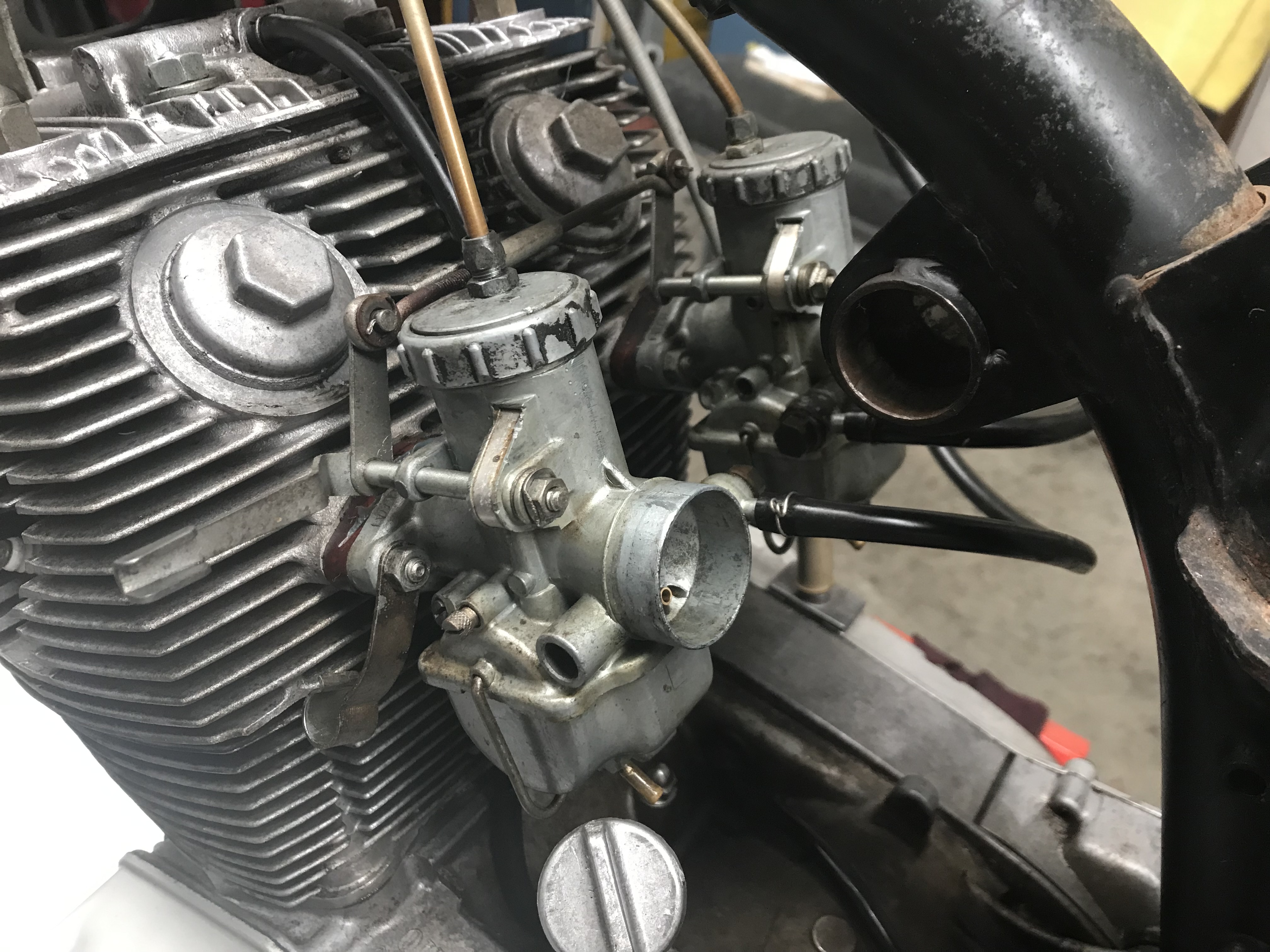

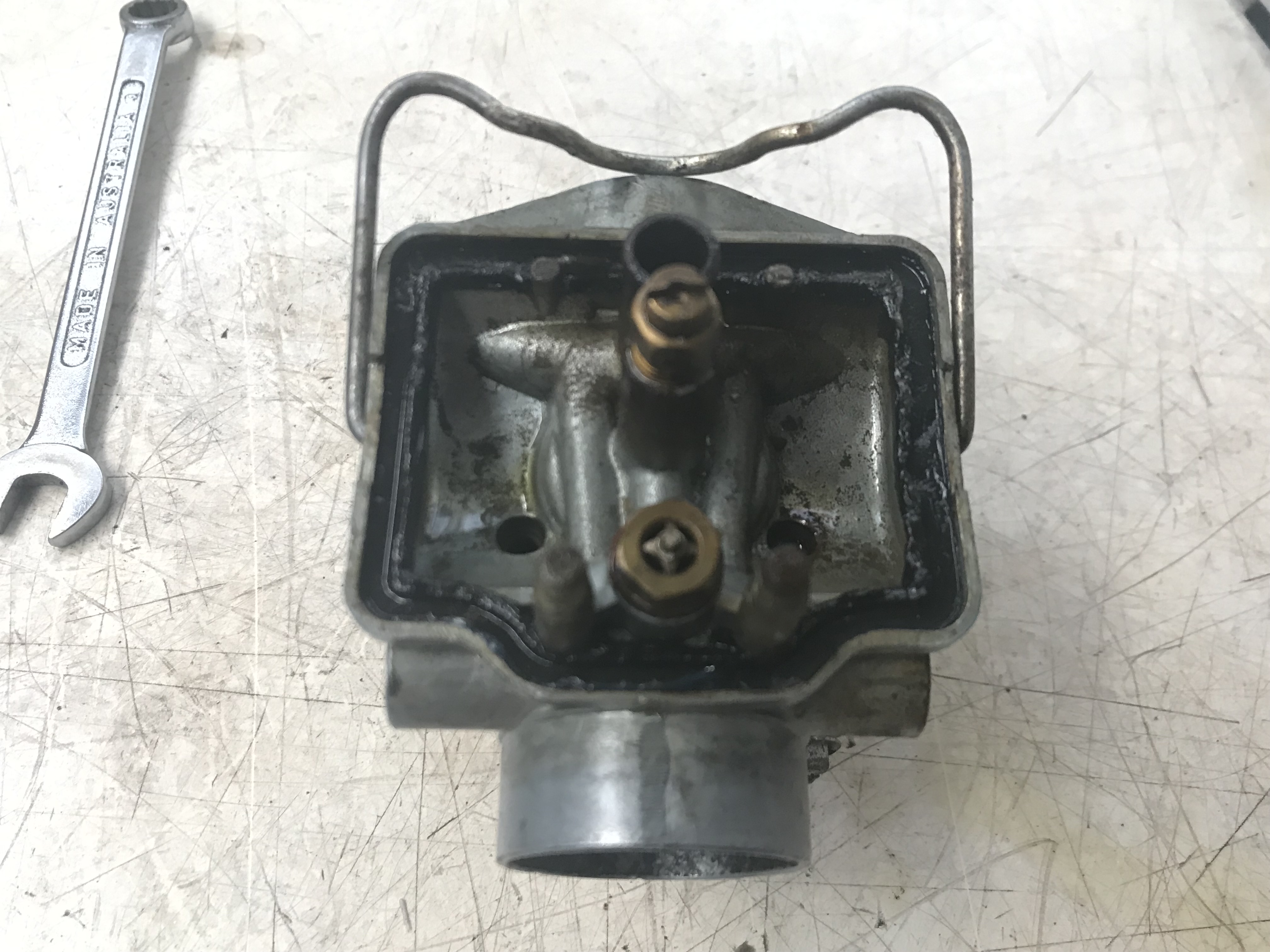

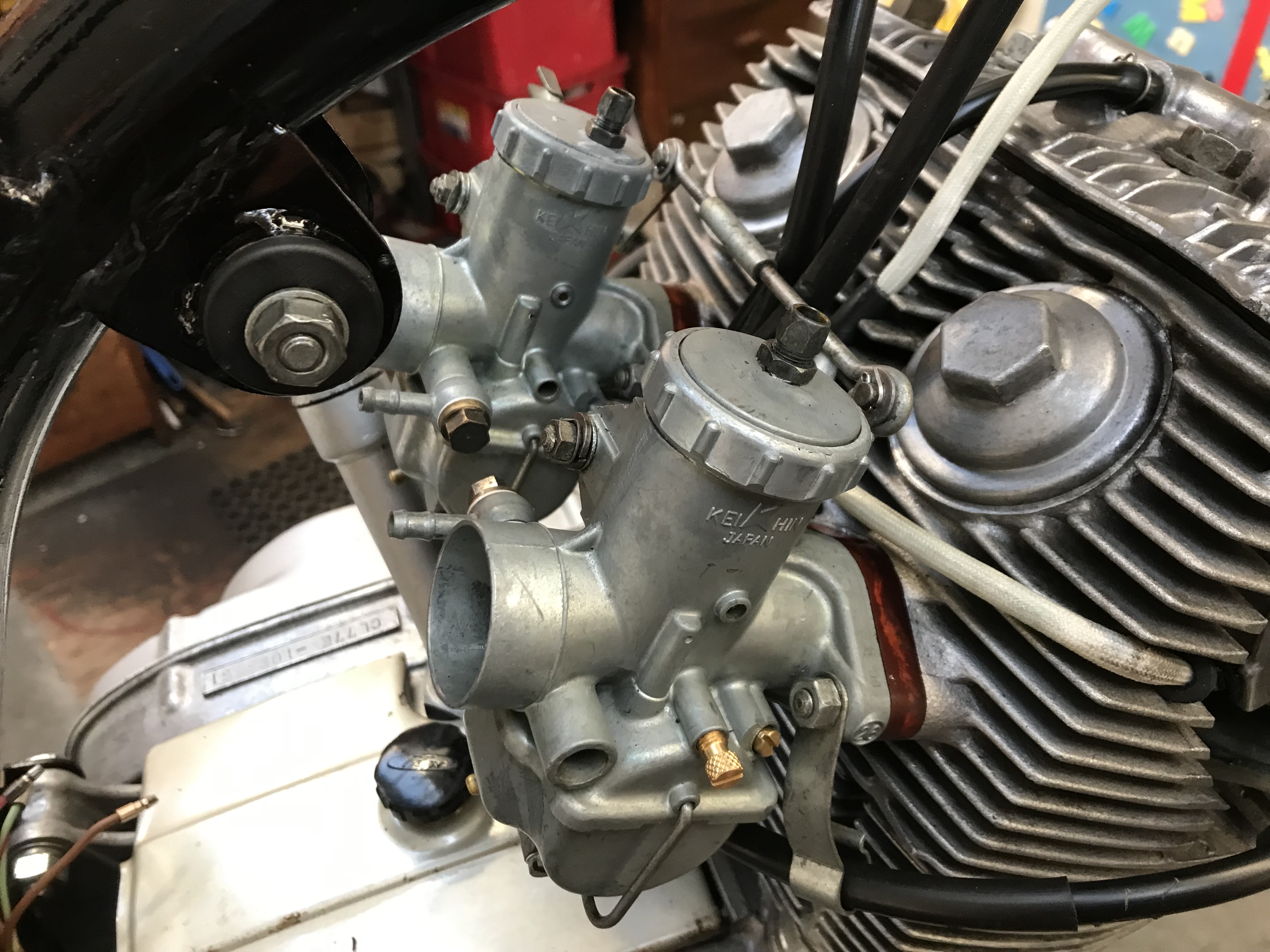

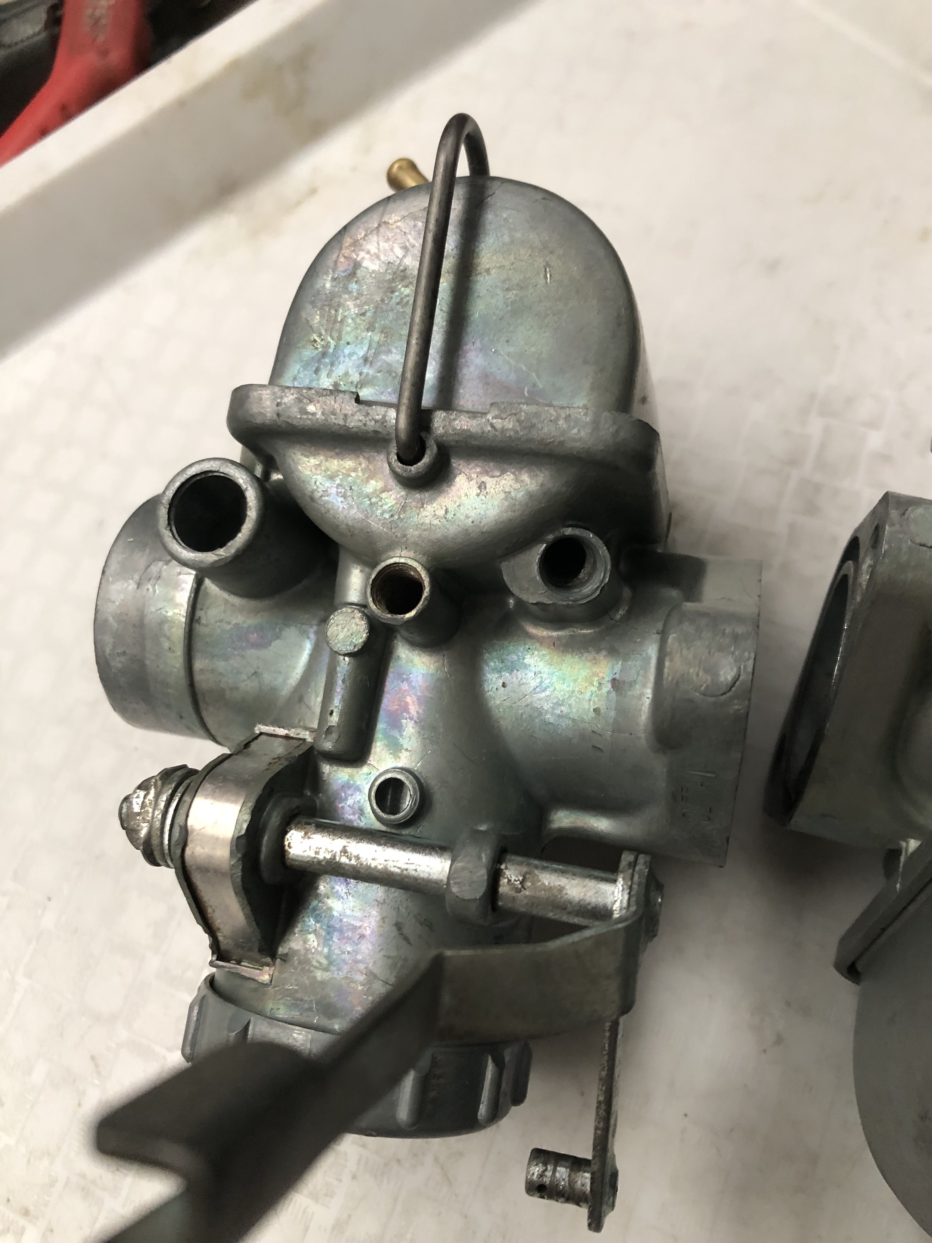

I take a particular interest in carbides and these were looking good
Inside was good little meaning full corrosion and the rest just needed cleaning.
If you clean well enough, polish with a tooth brush and detergent long enough you can polish the pearl out of them.
Full card kit including float bowls. The old parts are good spares.

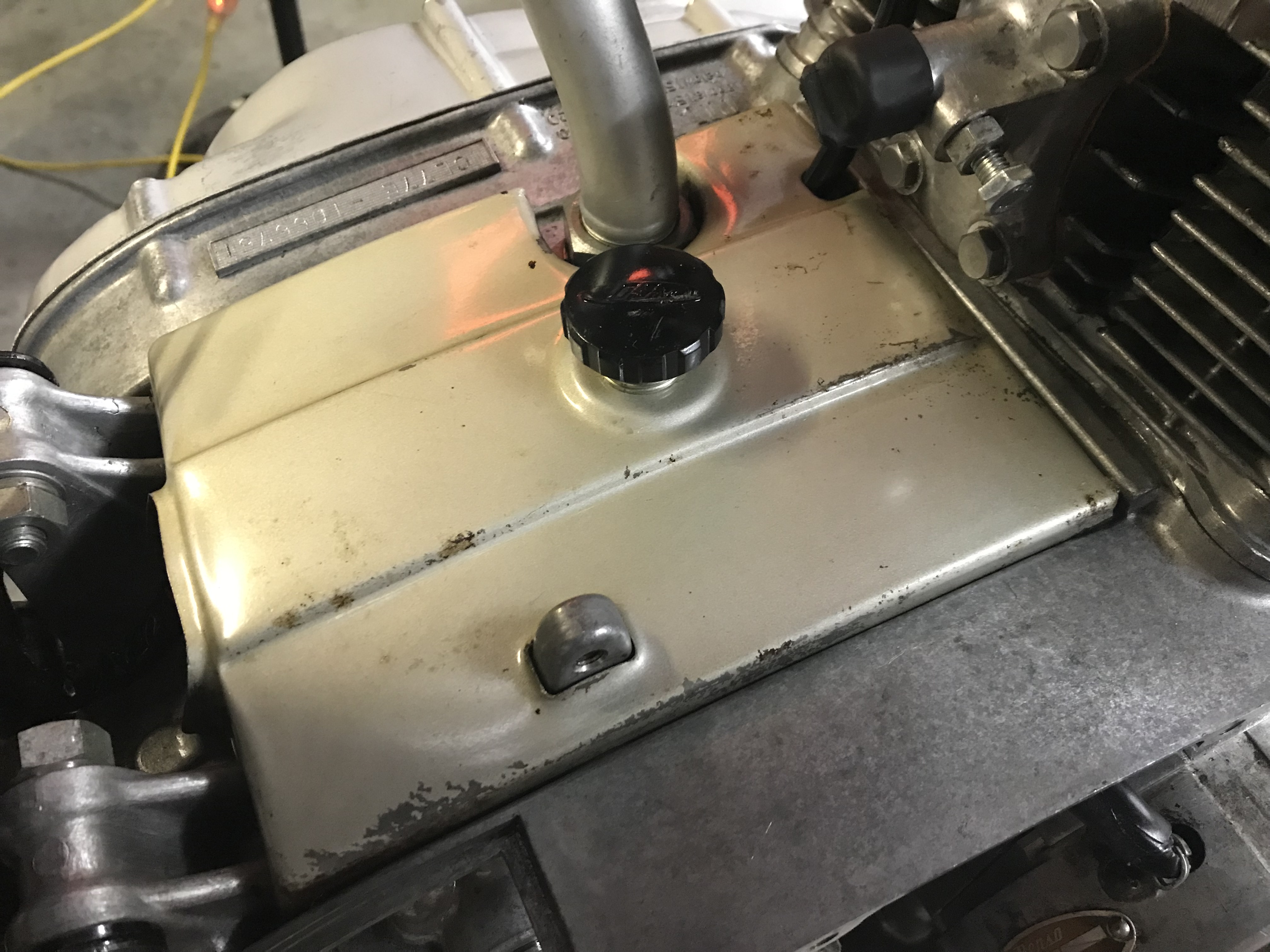

There is a cover plate under the carbs
I guess that’s 60 years
The history of this bike is born from Mr Honda returning from Europe and knowing what he needed to make.
High on the list is no leaks so Orings are extensively used. This is how Honda entered the big boy European market. The response was “Jap crap it will neve last”
Posted: Sat Jul 13, 2024 1:10 am
by Tioli
All I could do with the cover plate is clean de rust best I could. The paint is the delicate type so rust converter/ eater has to be applied carefully. Do the best I can light cut and polish add protective coating and enjoy the patina.

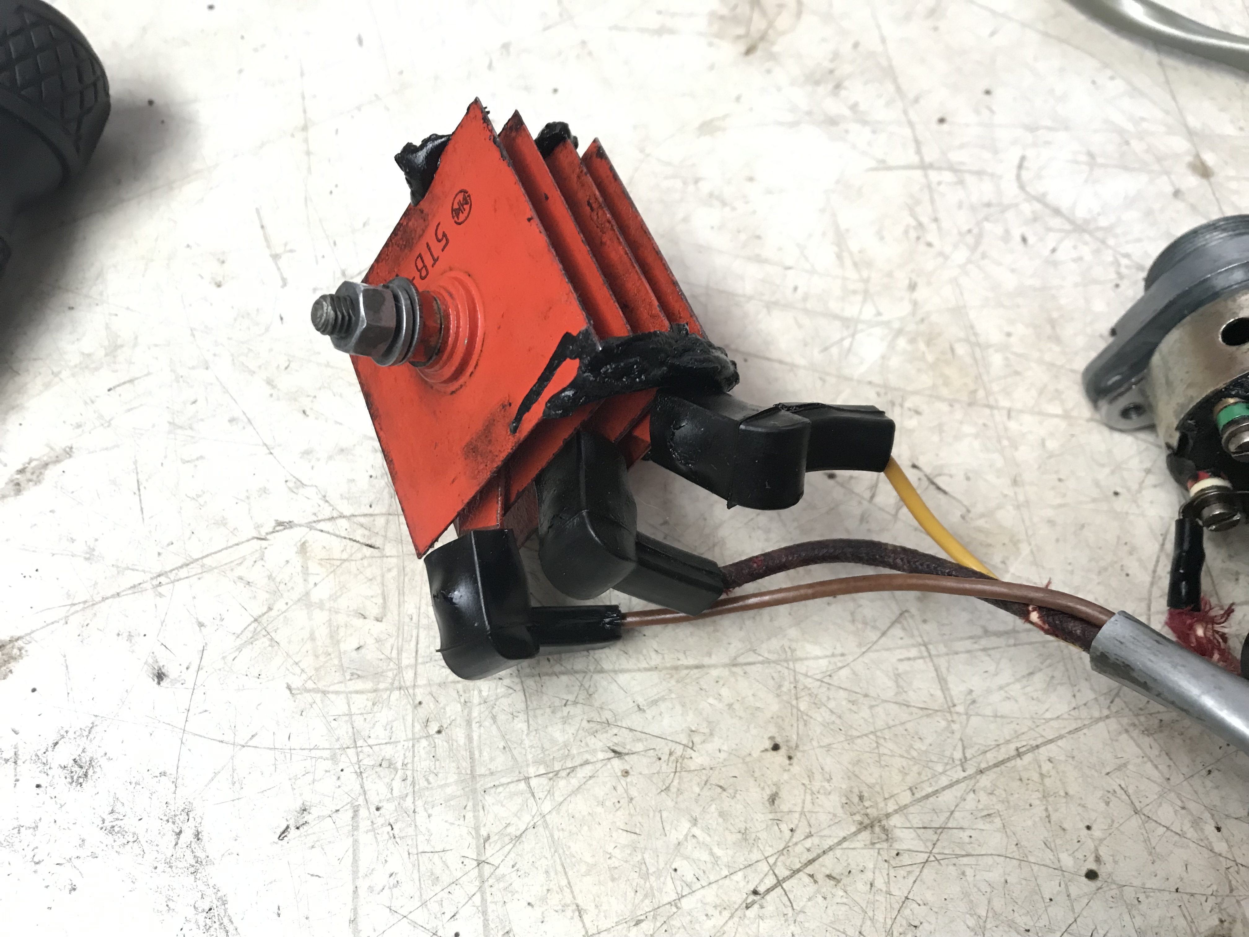

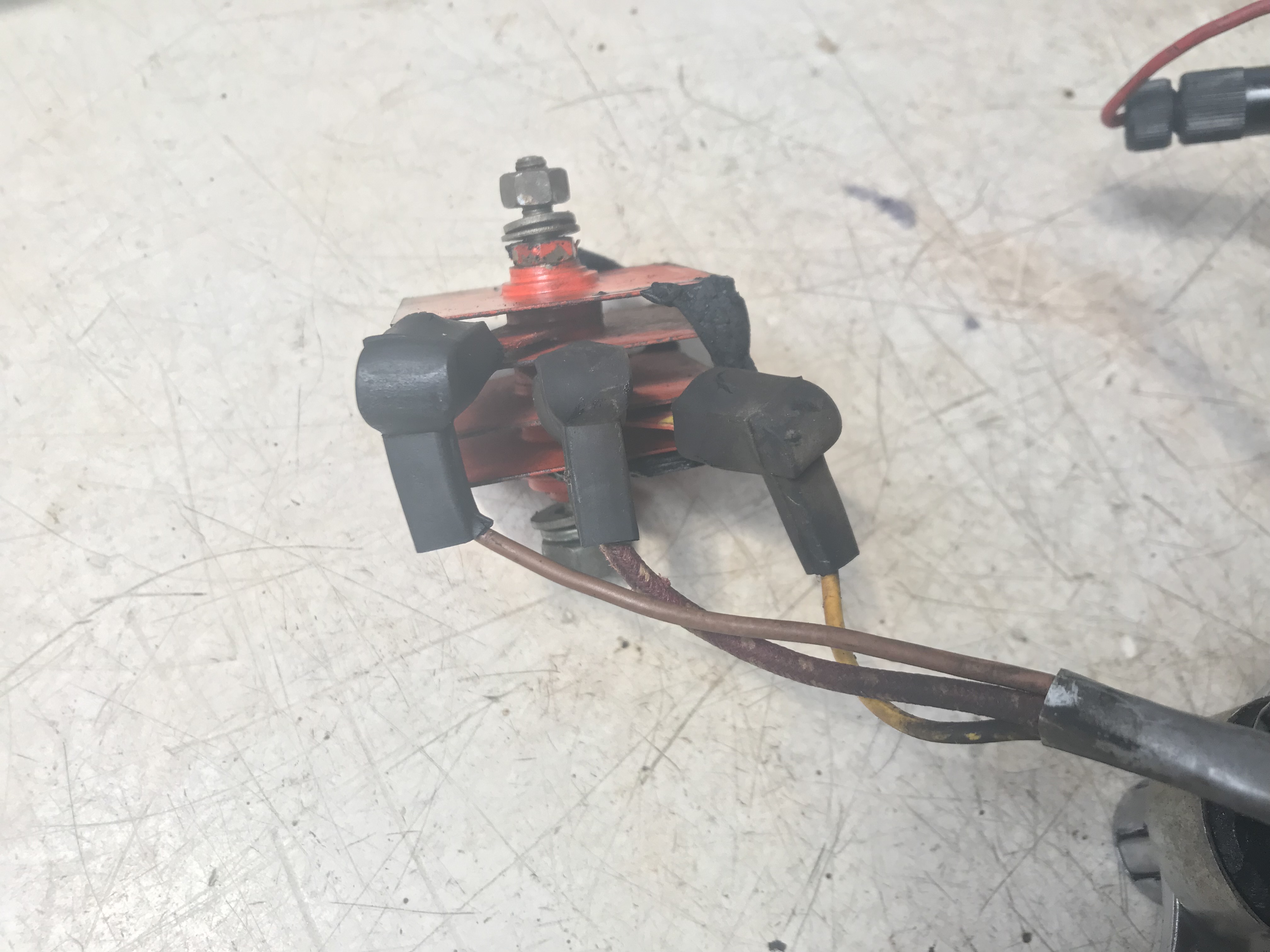

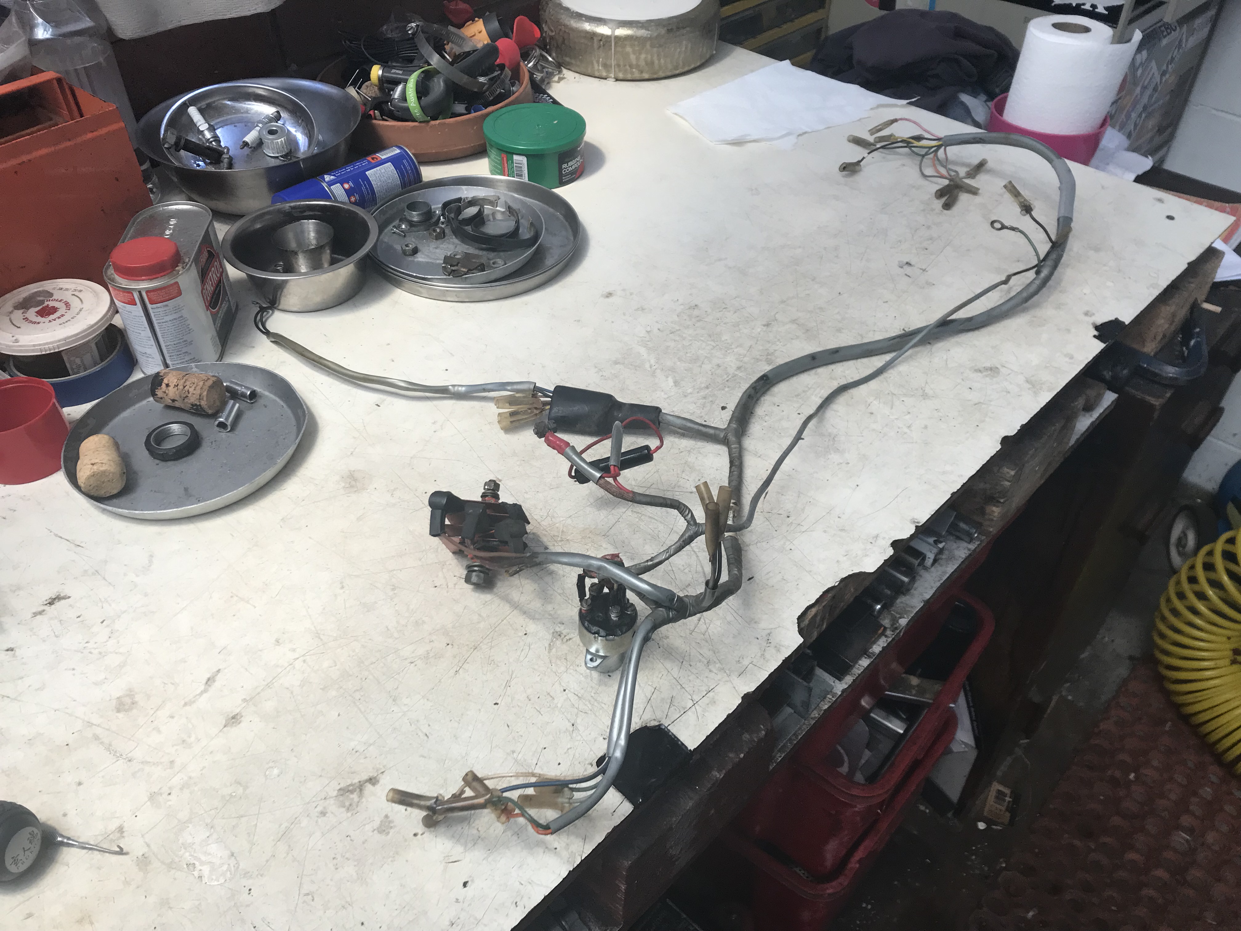

The wiring harness has additional wiring for indicators which the CL77’s don’t but do for the domestic market.
Before cleaning
The attachment IMG_3009.jpeg is no longer available
After meticulous cleaning
Before
After

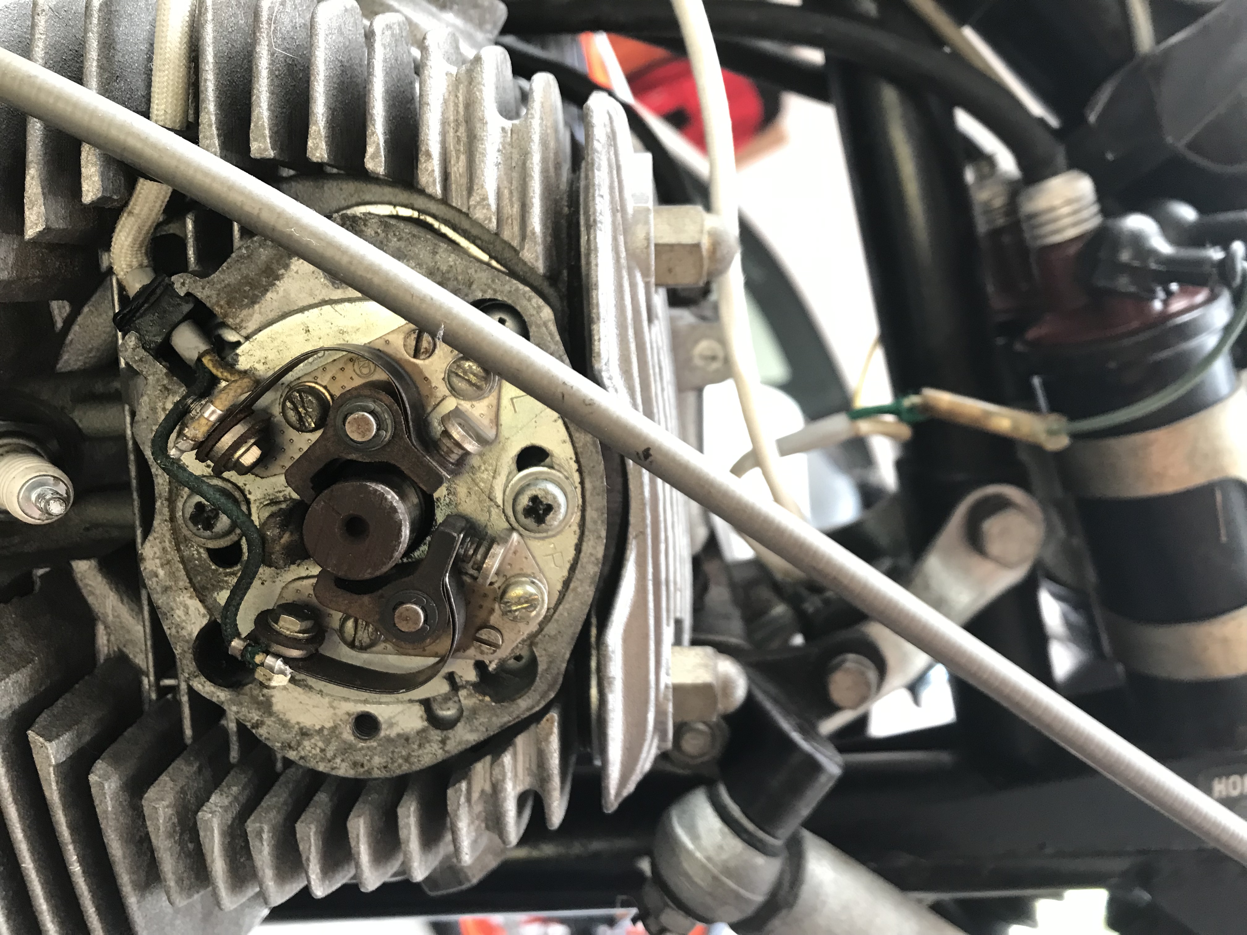

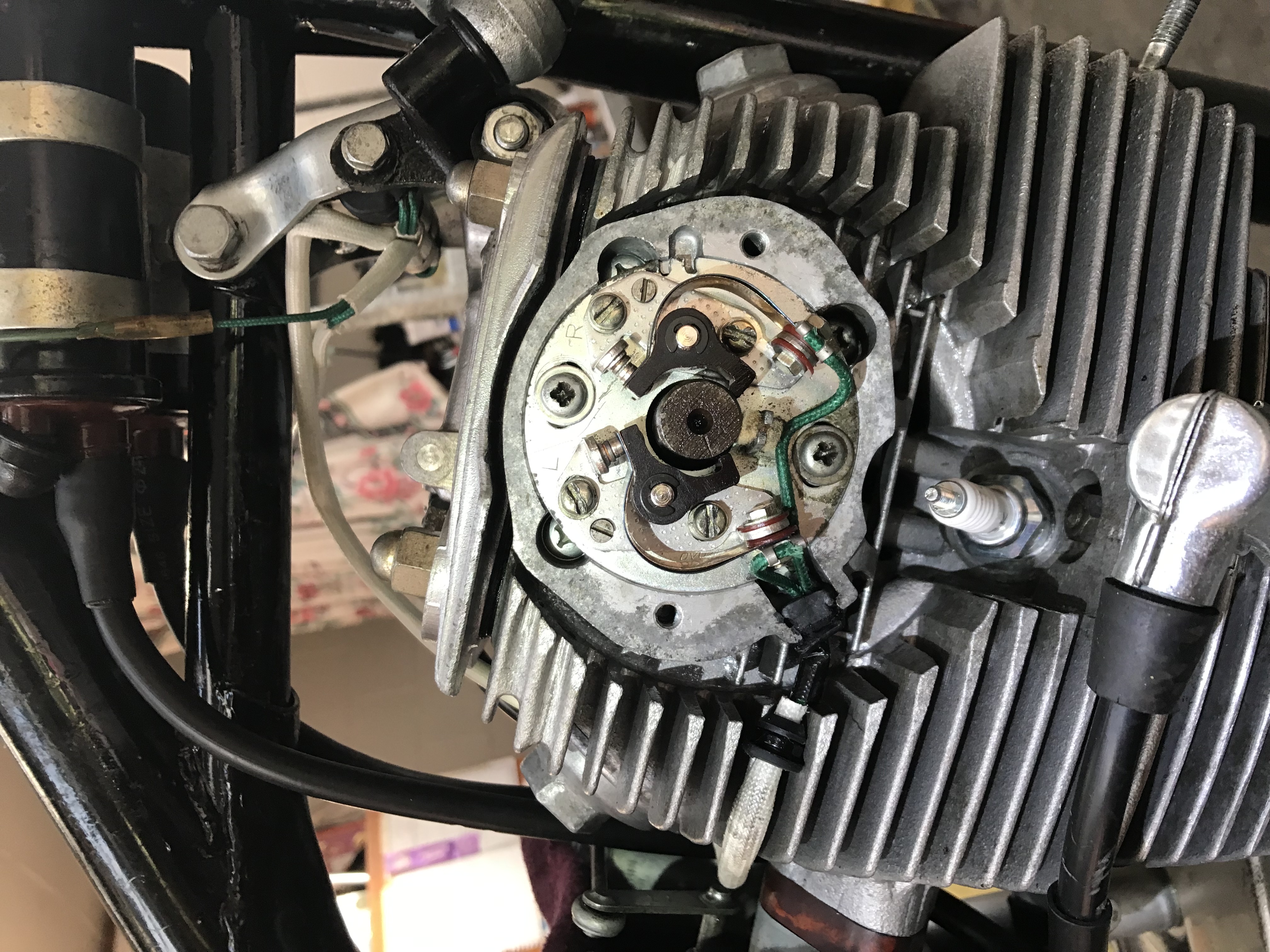

Old points
New points
New condenser

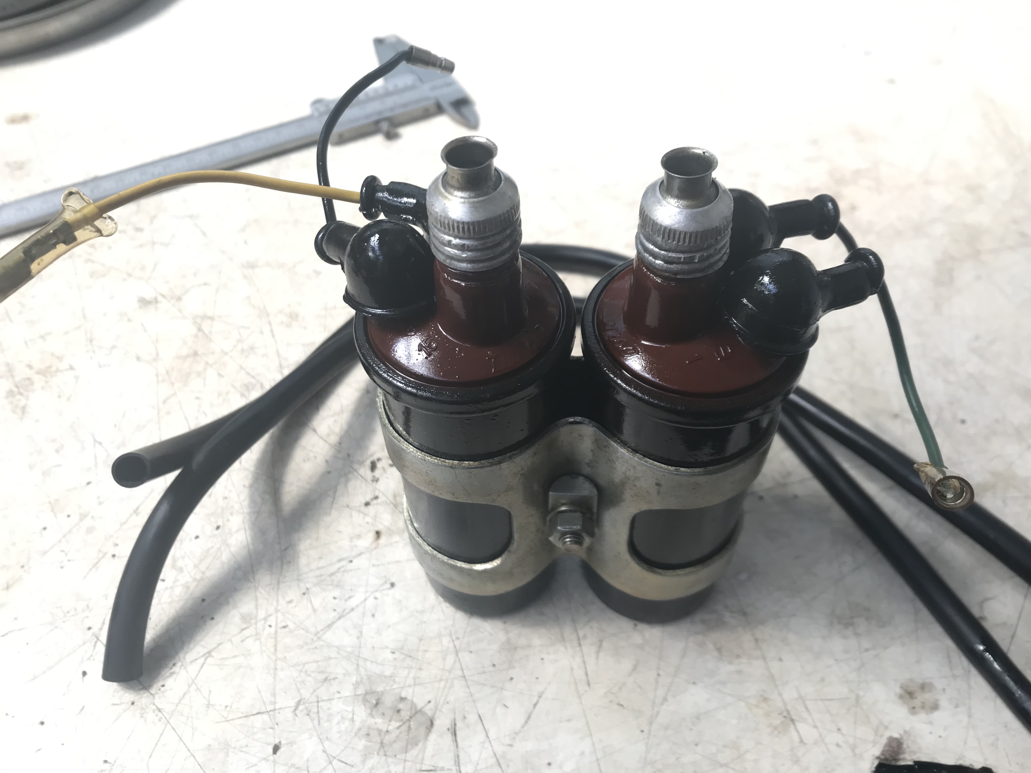

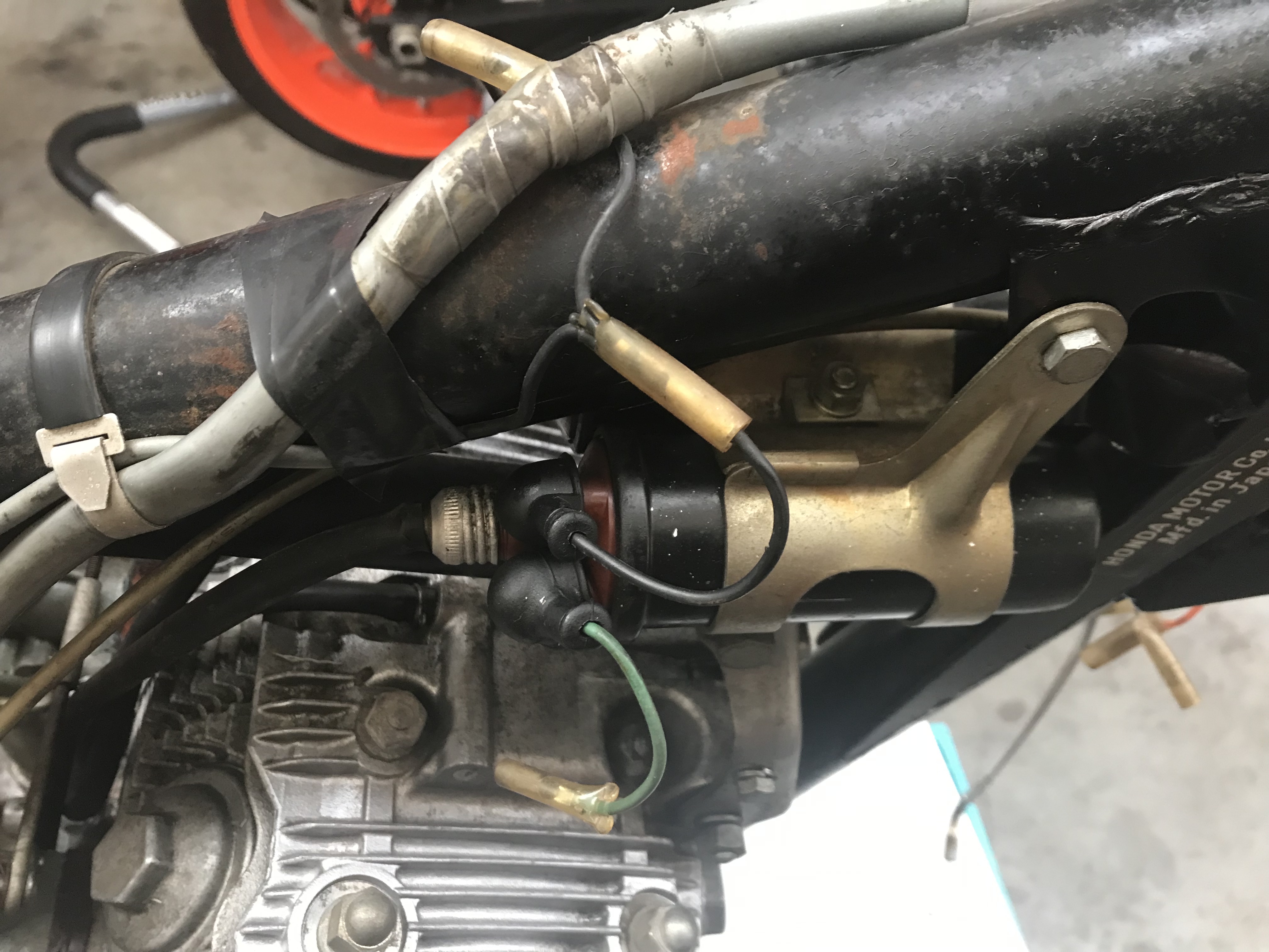

Old coils
Cleaned and Leeds replaced
