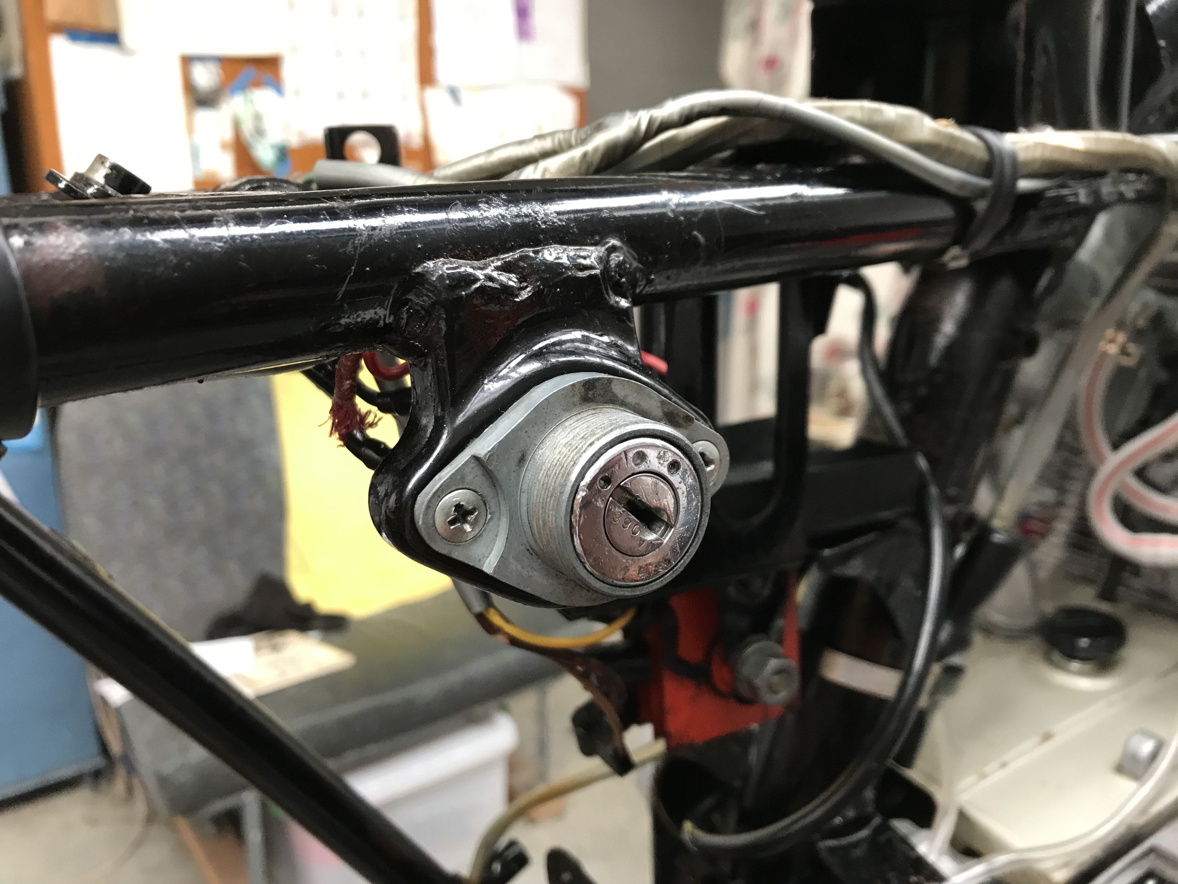

The ignition switch is upside down for some reason
Before

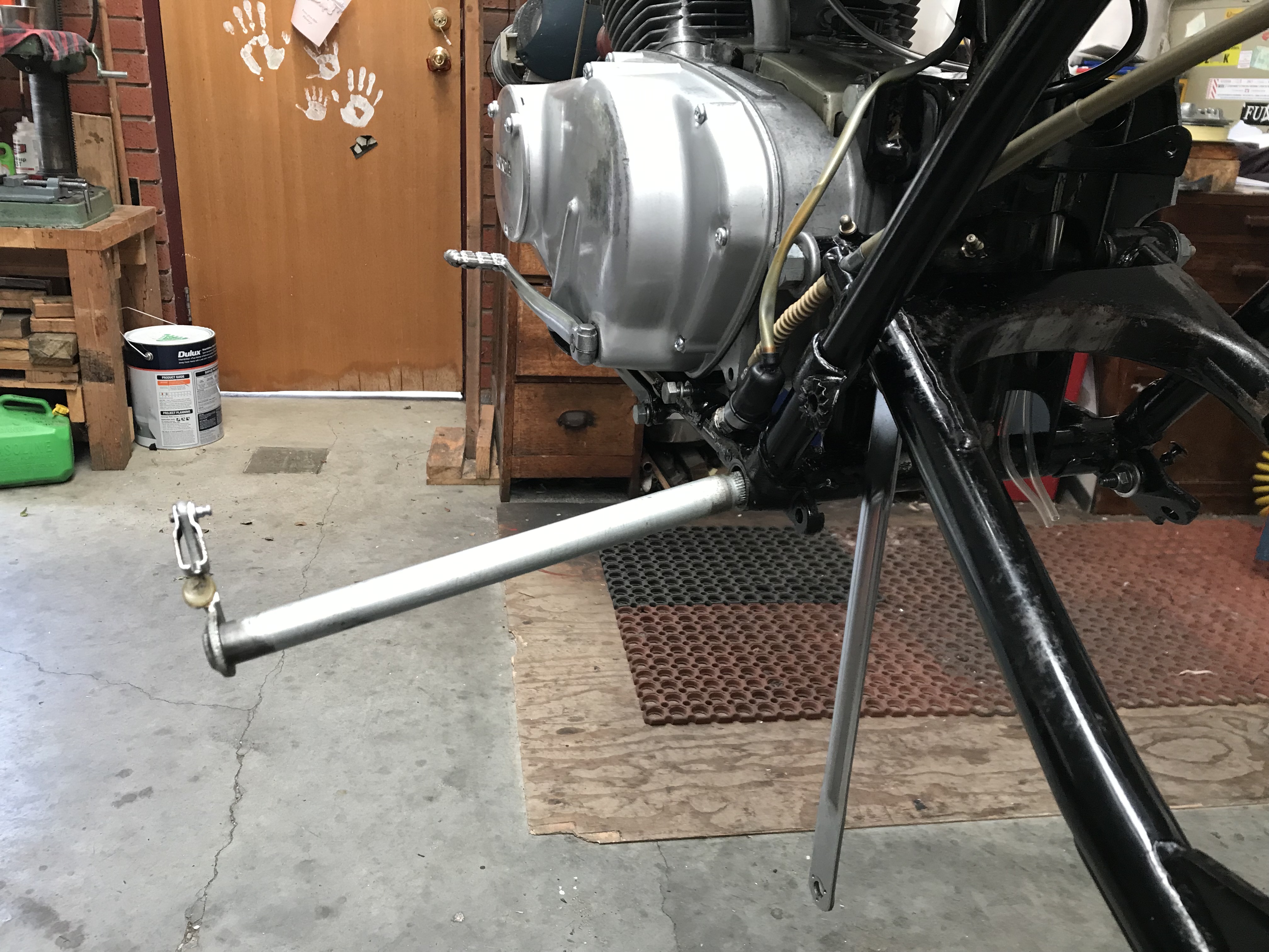

The foot brake is cable operated with a shaft through the frame to the other side.
Before

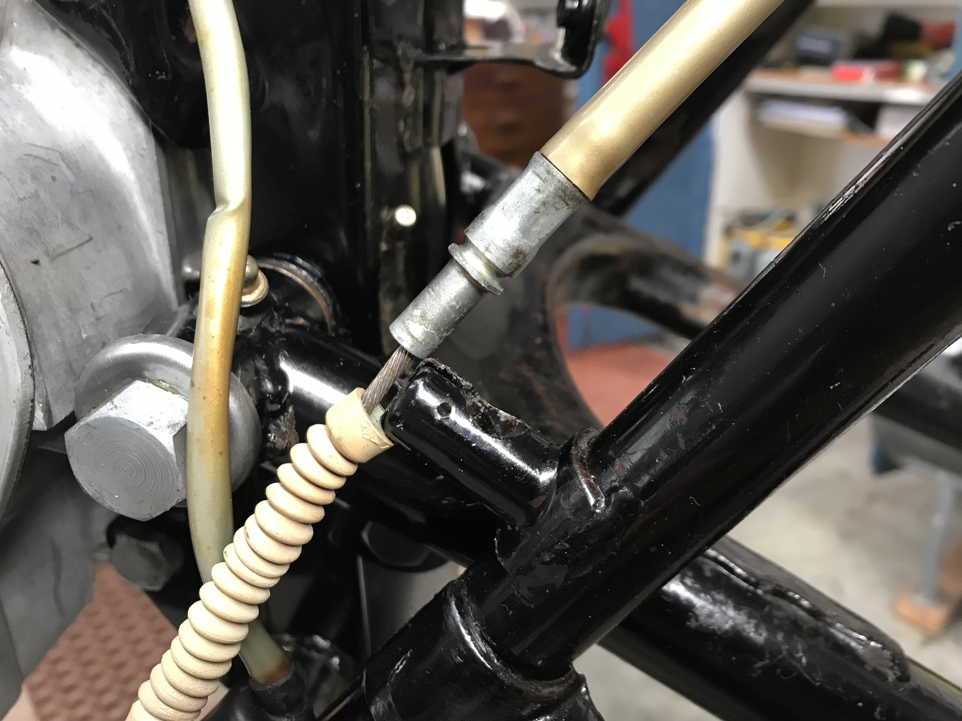

The cable is attached to the frame and locked in place with a pin which doubles up as a spring mount.
Before
After
Grease the shaft and push through
The cable end is attached and notice the split pin hole so the cable can’t come out of its mount.
Before again
The spring is there so the foot brake leaver is held up and brake switch depressed independently of the brake drum shoe springs.
After
