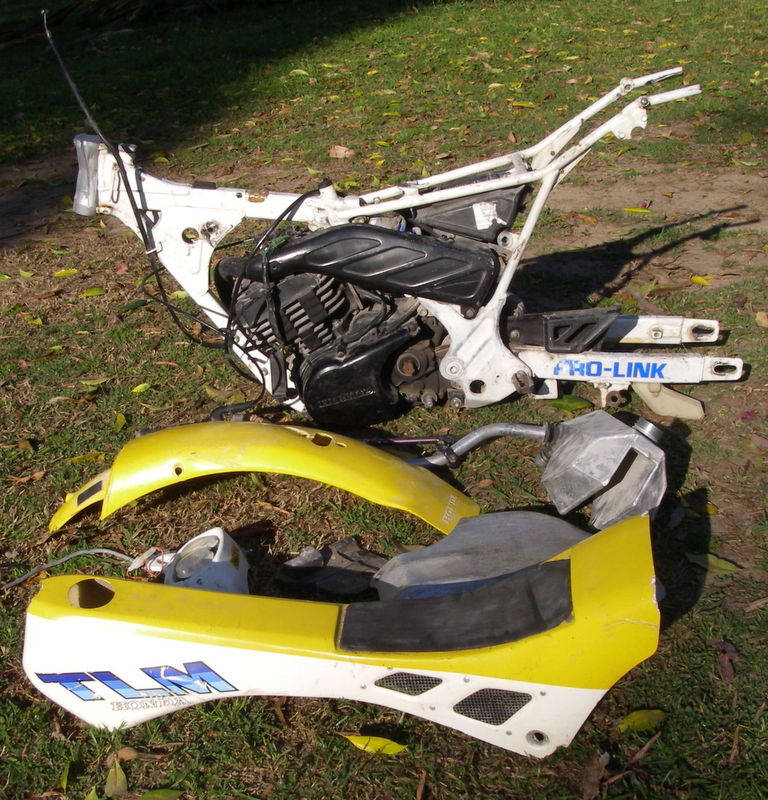

Just sharing Donna's latest acquisition, an incomplete TLM 200! The plan is to make a bike out of the spare parts we have and offer it for sale.
Had some spare time last night and cleaned out carby and had a look through inlet and exhaust ports and all looks quite healthy, compression seems fine but I am not getting any spark. The coil is missing and 260 coil is different to the 220 one on the Totally Loved machine, so we will have to source another coil. Meanwhile I will try swapping parts in the hunt for spark as I am keen to hear it run.
