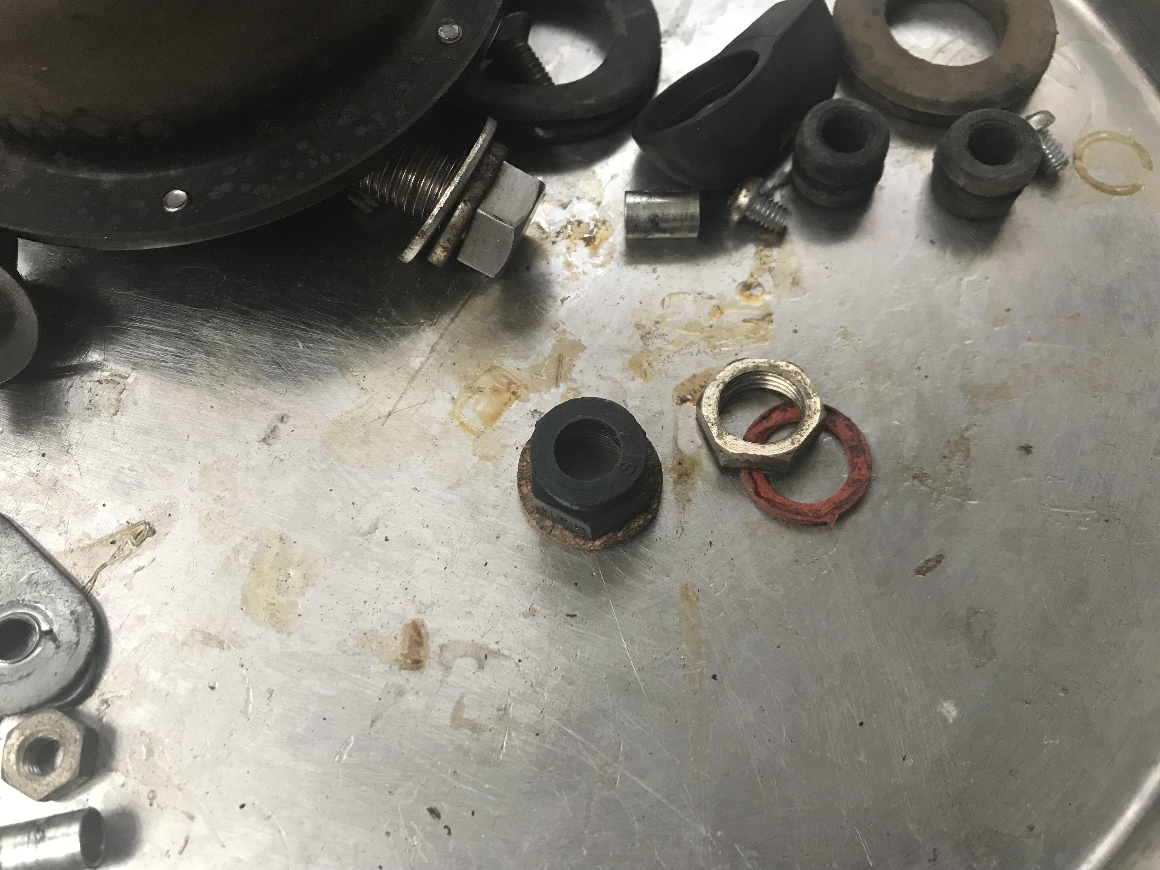

Old head light
New
The bike was throughly washed and what you see pretty well sums its condition up.
Cosmetic damage in good order.
The horn is nicely sprung not connected to the head light at all amazing.
