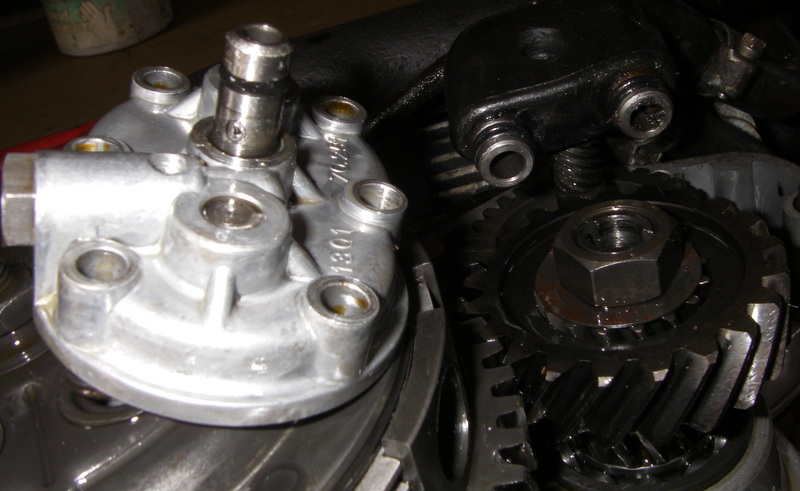

Decided to pull the rocker cover off and I am very impressed with the job Gerard has done on the rocker shafts and blocks, but there was a distinct lack of lubrication. Topped up oil directly over rocker shafts, put some oil down the plug hole and cranked it over with a drill and no oil was moving. Laid it on it's side and removed the clutch cover to have a look how the pump works, only to find the 3mm roll pin that is driven by the crank is sheared off. Found an old TY shock to raid the roll pin and fitted it to the pump and bolted it back together.

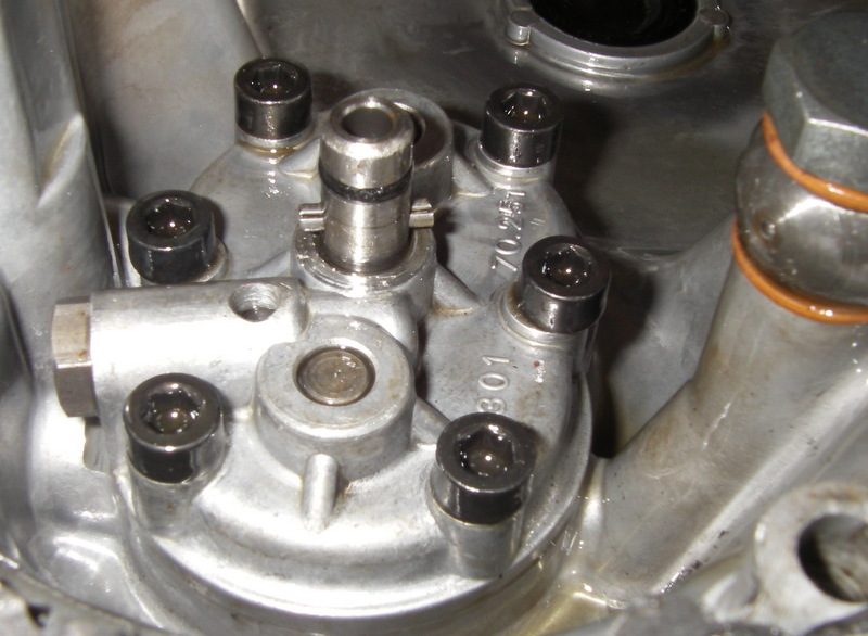

Found the broken bits, primed the pump and cranked it over with the drill again, so now the lubrication is flowing. This simple sheared roll pin is probably what killed the rocker shafts and blocks causing the valves to stop working, but fortunately the bottom end is lubricated by a wet sump.

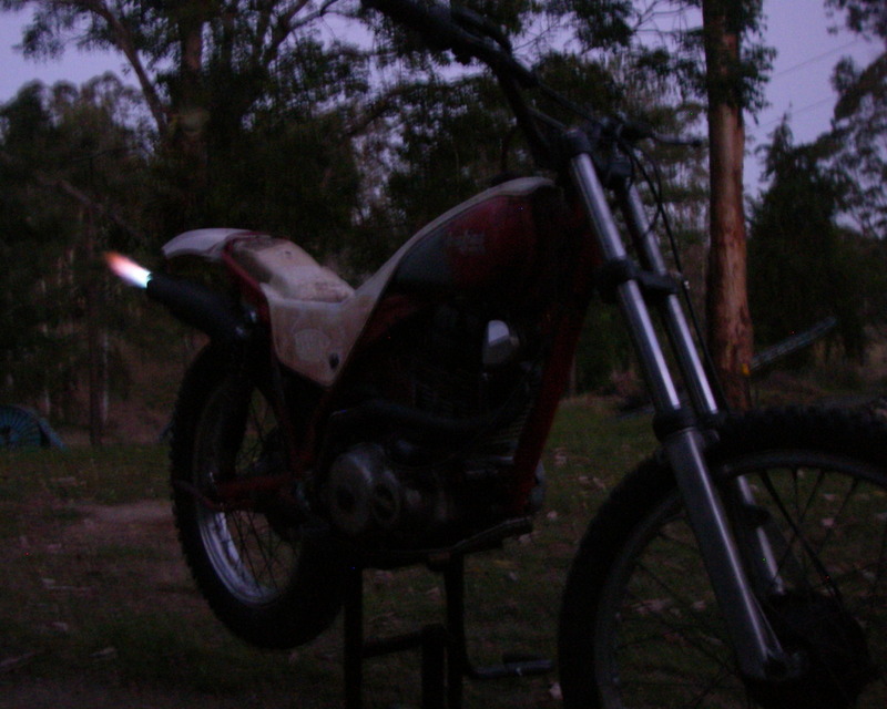

First kick! This was late in the afternoon after working on it most of the day, so I had to take a photo, I think you just out monstered Franken KT !

Is that exhaust flame photoshopped or real?

I have just one question I forgot to mention, and that is the flames coming out the rear of the exhaust. Does that mean I might be able to attack that hill climb at Conondale, or is that just trick photography??? I thought you were on a total fire ban in your area!!!!

David, Yes real flames and No I don't know how to photoshop!

Because there were no bolts sticking out of the sides of the ITALIAN STALLIAN to connect my Lightning Rods to like Franken KT, I was thinking that Grappa would be the Ultimate fuel for the Monster. Turns out it starts and runs really well on BP Ultimate!
Perhaps this is a better way to depict the motor running?

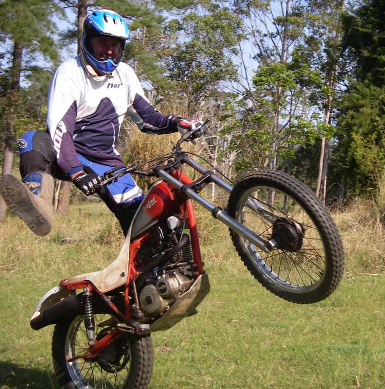

I don't see evidence of the motor running so much as evidence of those anti-gravity boots you're wearing. The right one has even lifted to nearly handlebar height. Your left toe is visible under the bash-plate so I'm assuming you must have hooked your foot under the foot peg to avoid drifting uncontrollably into the upper atmosphere.Greg Harding wrote:........ Perhaps this is a better way to depict the motor running?
Its a good thing Chippy's bike has a bit of weight to it or you could have been lost to us forever.

I've never really worried about the size of my head since it probably makes no difference with it being empty.Greg Harding wrote:.......... Apparently my boofhead made the difference!
Gravity on the other hand can either be a friend or an enemy. I'd always assumed that since gravity had such a firm hold on my ample guts, that the little orange beasty would never leap uncontrollably in a skywards direction and unexpectedly dislodge me ...... That was until Conondale the other year when one of the sections went across a little dry gully and sharpishly up a little steep bank with an awkward turn at the top. Now the little beasty is not exactly famous for its explosive power, and so I grabbed a good handfull of throttle only to find the front wheel coming in a generally upwards direction and continuing to come up at such a rate that it spat me clean off the back while it continued to loop backward as it disappeared in a skywards direction with me falling backwards to the bottom of the gully.
I can't blame the beasty since it was only doing what I told it, so I guess I have to blame gravity. At least there was nobody there with a camera at just that time so at least there is no photographic evidence of my embarrassment, but I'm still wary of gravity. I'm not sure that its something to be played with.
