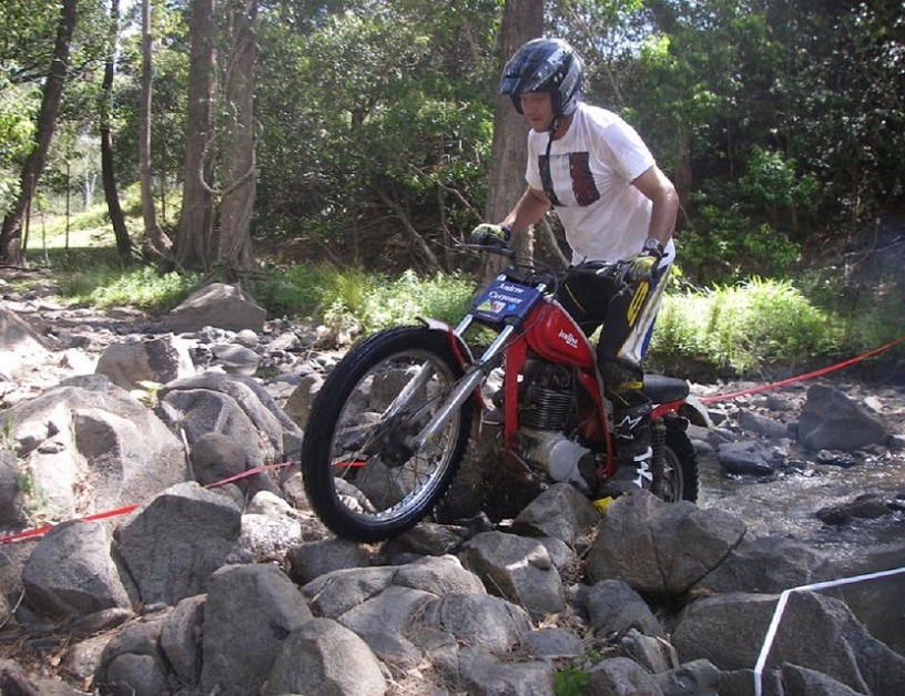

Here is something we don't see very often, an ITALJET SCOTT competing at a Trial ! Nice work Chippy!

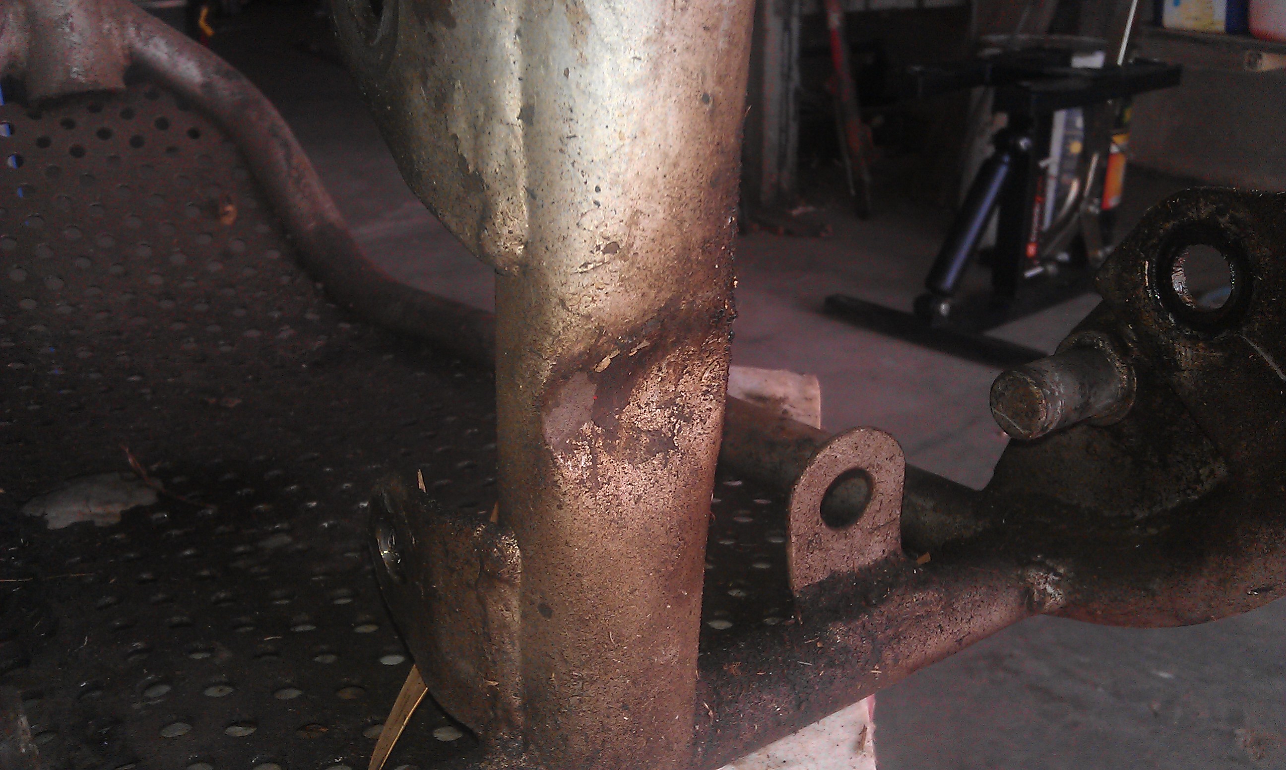

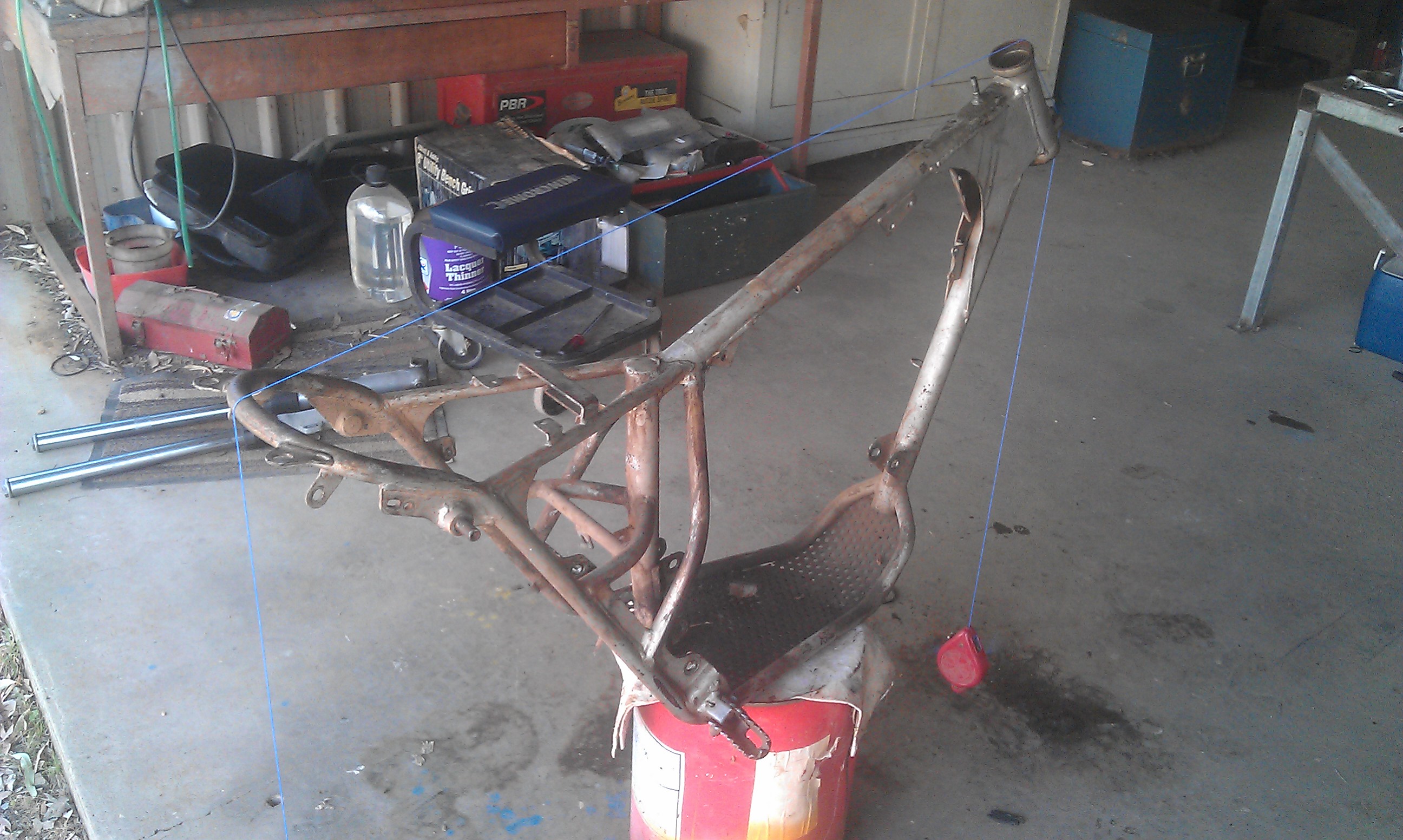

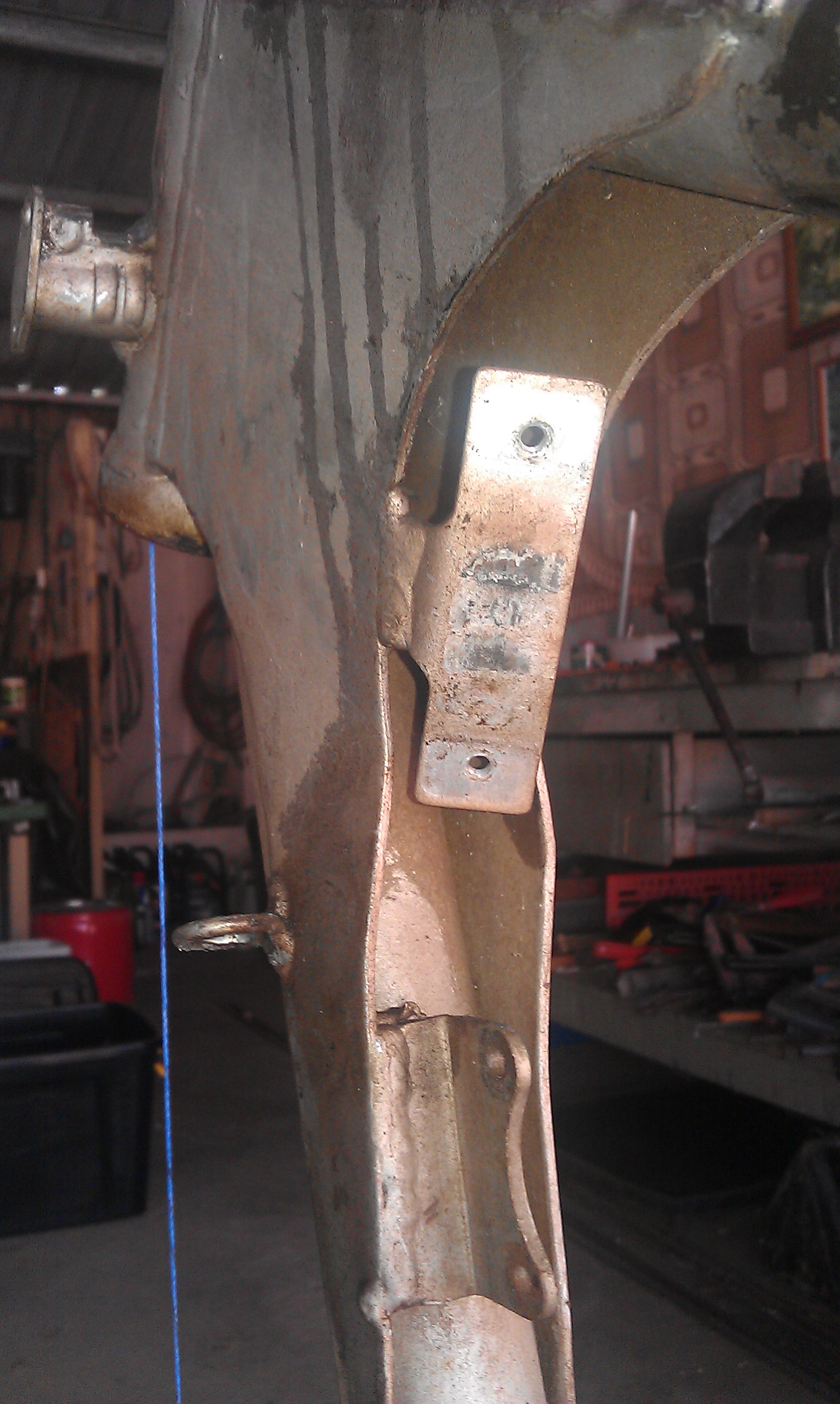

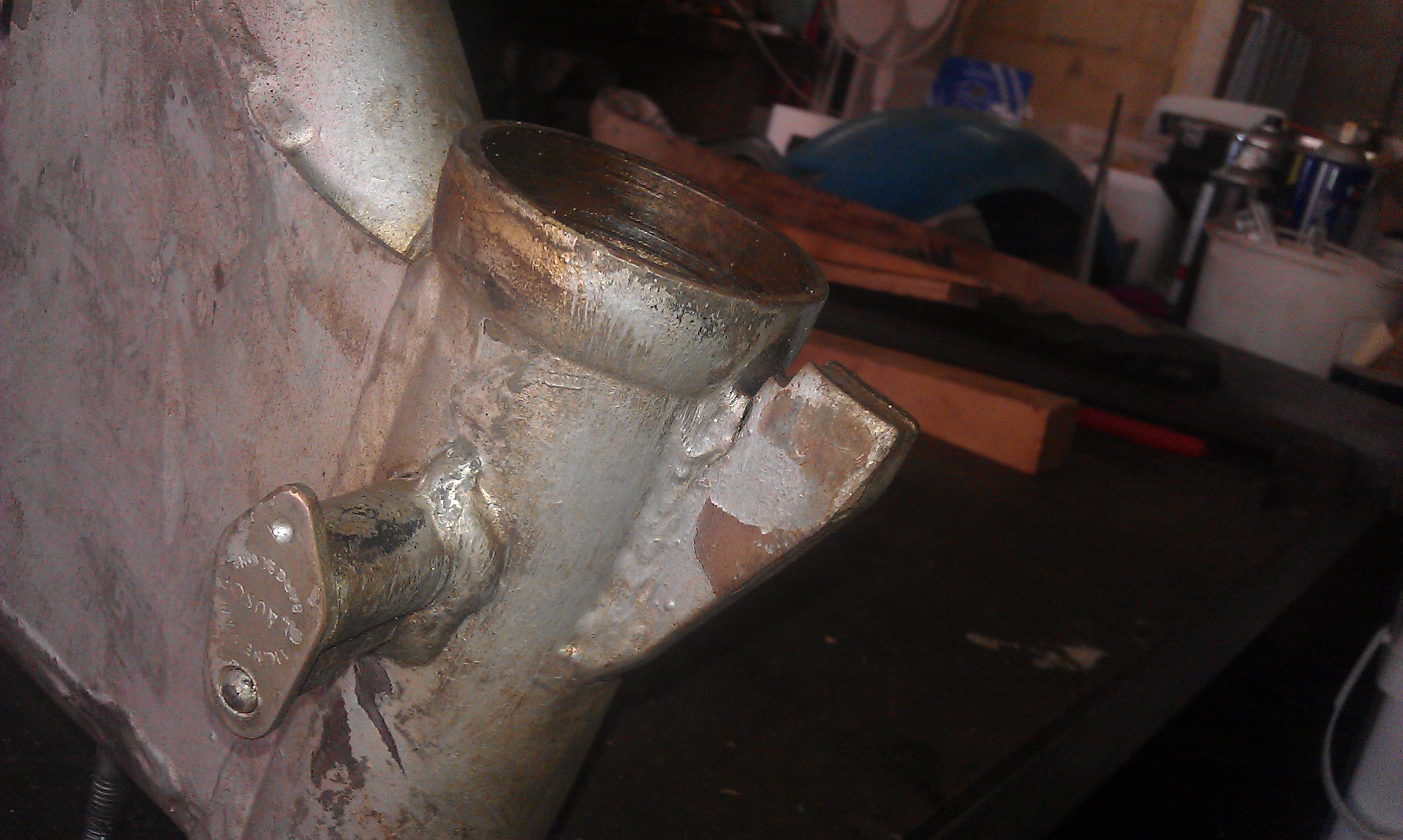

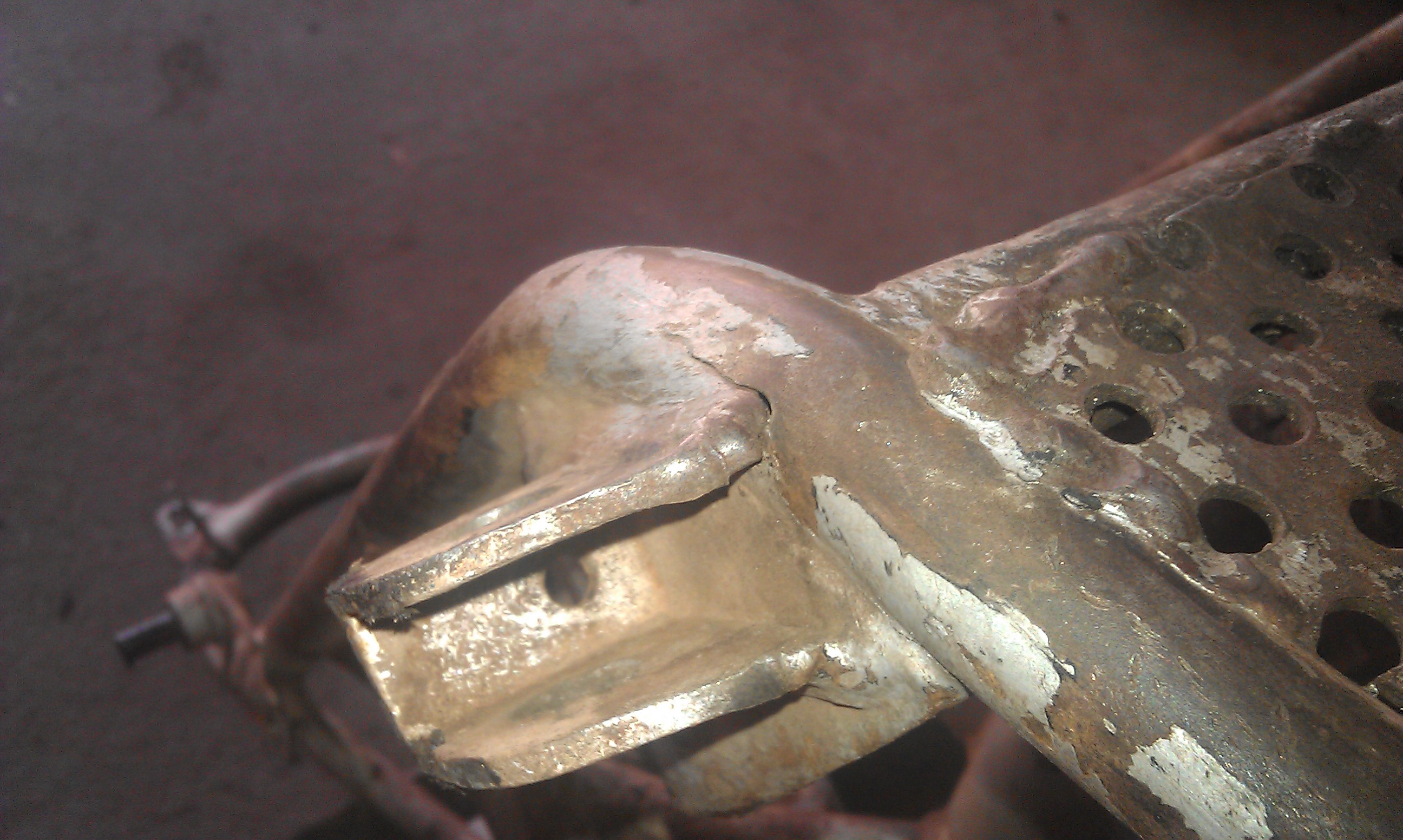

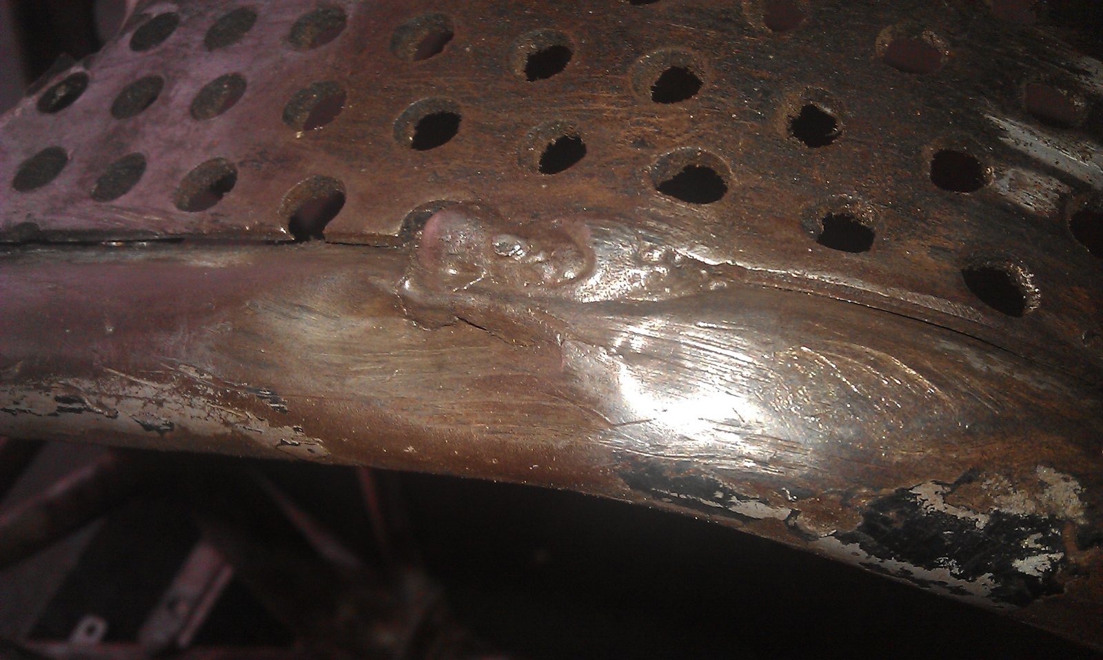

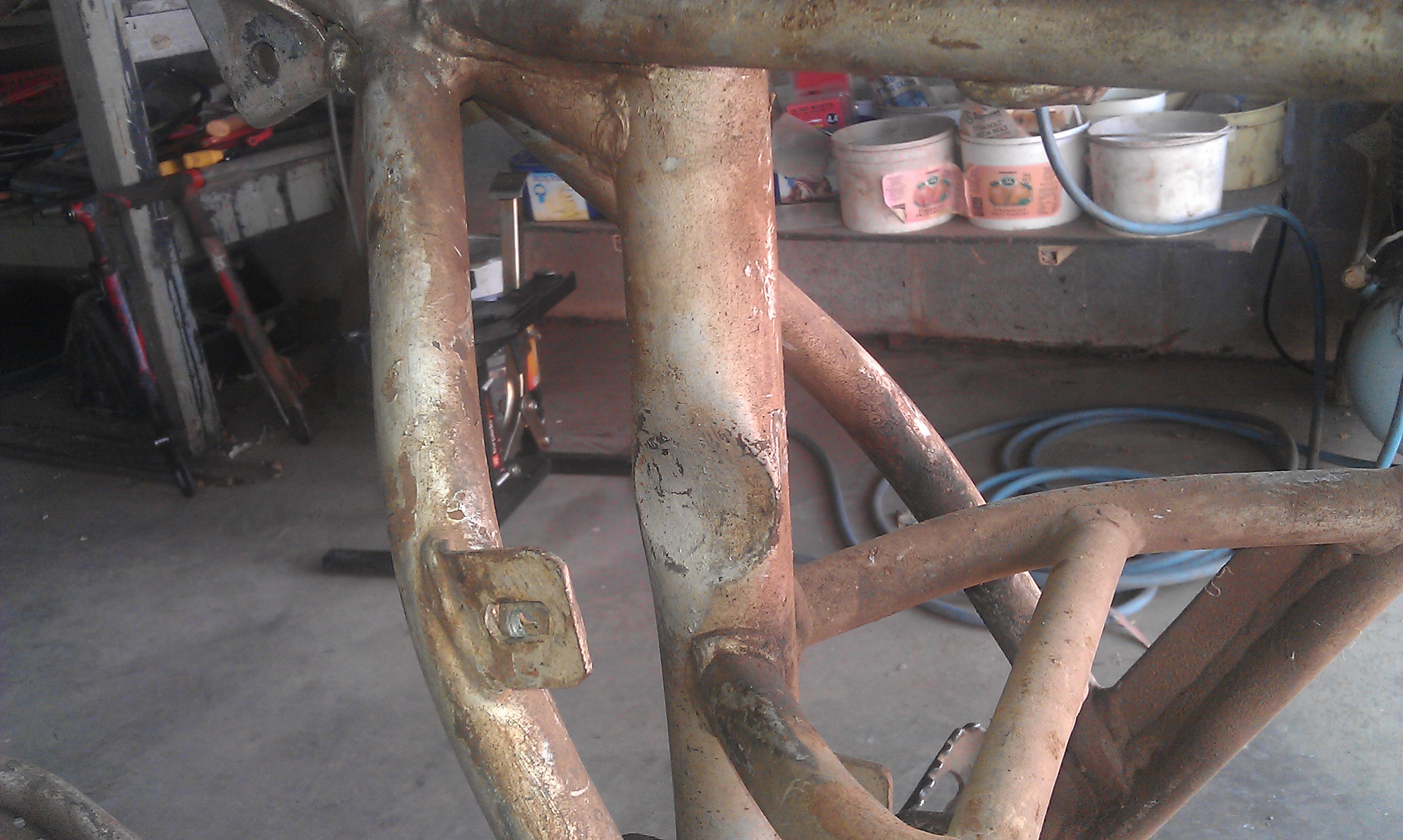

I've been restoring a M138 Alpina (1975 Bultaco 350) for about 15 years. I did the wheels, forks, tank, airbox, sidecovers, seat and motor rebuild over the years and a few days ago I finally got it running well with a new Mikuni carby, and am now doing the remaining cosmetic work, which includes repainting the frame. I pulled the bike apart yesterday. Today I had a close look at the frame and found a few things needing attention and took some photos:
Slight twist of the headstock away from vertical
Cracked steering stop
Cracked frame where the left footpeg mount attaches
Cracked frame from a rock gouge under the engine
Bent up frame tubes under the engine
Buckled steering head gussets
It's a fairly bizarre frame design, with deliberate dents made in the frame members to make space for the swingarm pivot and the airbox outlet pipe
