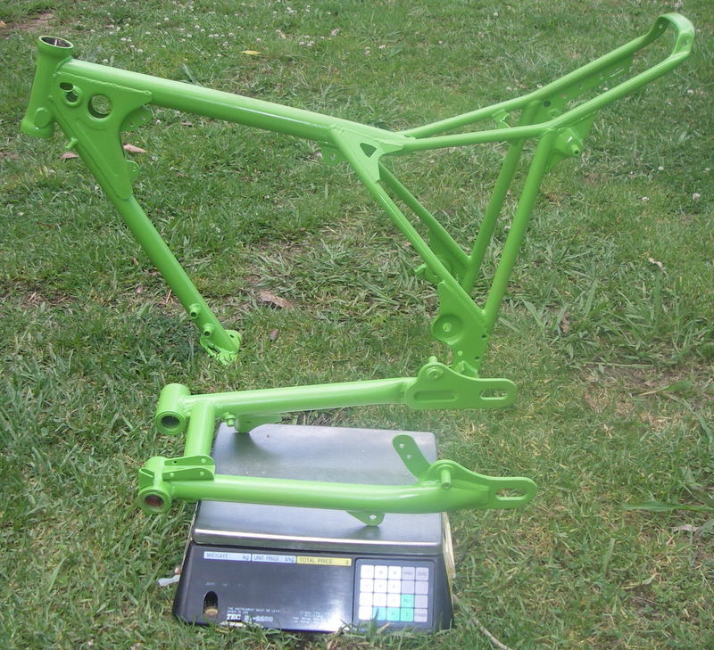

Here is a photo of Steve's ITALJET Piuma frame 6.990 kg and swingarm 2.960 kg

Greg - with a frame that light, it is no wonder it was called a Piuma, which come to think of it, is pretty close to being named after poultry (like a Bantam)
The challenge is on now to find a full-sized twinshock era trials frame lighter than the Italjet Piuma

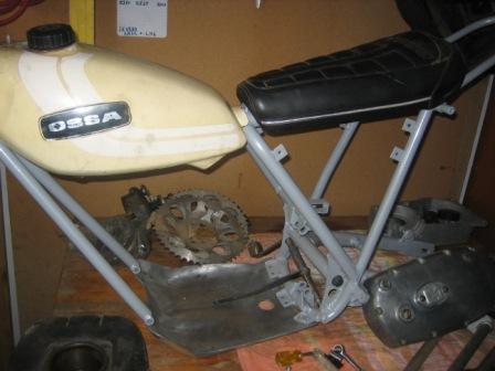

Here is a photo of my Ossa Mar 350 basket case. This is practically how I got it. THe frame has been sandblasted and powder coated, but as you can see the powder coaters only have a grey colour. Frame is about to be rubbed now for a coat of paint.
Ossa 350.jpg (31.48 KiB) Viewed 6582 times
