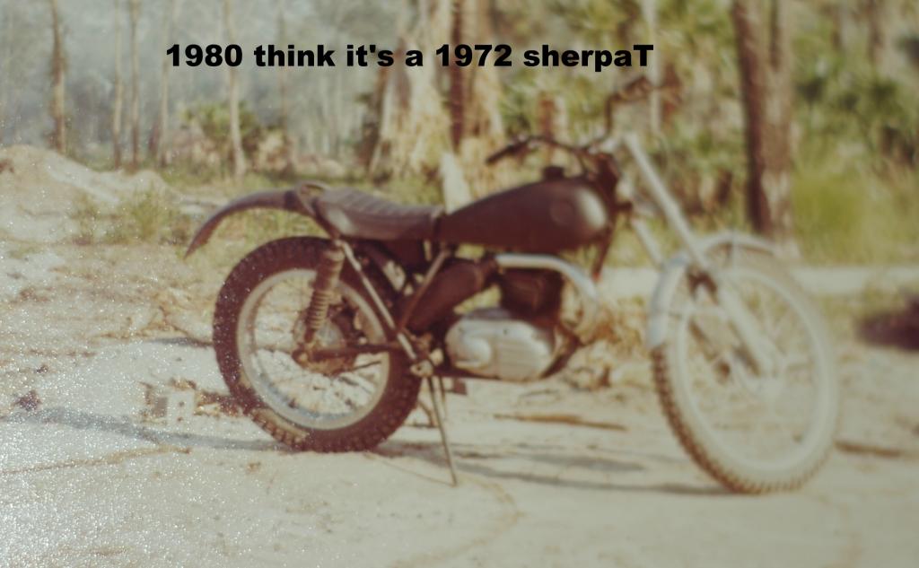

JC1 wrote:David, I'd have tho't it'd have to be an M91 (of '72-74) since it's got the extra tubes running down to the swingarm pivot, which the earlier models didn't have.
Tank of course is not standard - could be cut-down slimline tank or earlier M49 Sherpa. Difficult to tell from the pic. Seat is something different too. Doesn't look like a Sherpa one - perhaps off the first model Alpina.
M49 tank has central filler, the slim one-piece tank has an offset filler like the one in the photo

I'm sticking with M91 for that black bike. If you have a closer look it still has the central down-tube under the seat (& the old style air-filter arrangement), but it has the extra Y-tubes as well which came out part way thro the M91/92 production run - my guess is for the extra power of the 325 engine - & continued on the M124/125 & M150/151 models. It was simply a modification to M49/80 style frame.
The 2nd generation frame with no central downtube under the seat came out on the M158/159, circa 75/76. There are a number of tell-tale differences. At a casual glance the M91/92 & 124/125 & 150/151 frames look similar to the 158/159 & later style but on looking closer they are very different. Much easier when you see them side by side.
The seat could be anything. The very 1st Alpina had a small single seat not much bigger than a Sherpa T seat, not like the longer double seat on most Alpinas, but it could be M49 Sherpa w extra padding & a diff seat cover.

it doesn't have a vertical post as the post goes straight up not on an angle, its not a 325, i still think 74/75. That white bit on the air filter box is just sunlight coming from between the tank and the seat creating an alusion that there may be another pipe there. The bike is facing west and the sun is low see the shadows of the wheels.
I wasn't suggesting it was a 325 - that's obvious from the round 9-fin barrel which the 325 never used - just that the extra downtubes in the Y-section as you call it were added to the slim-line models' frame to cope with the 325's power, & the 250 used the same frame.
The "white bit" you mention is indeed light. If you know what you're looking for you can see it's the gap between the front face of the airbox & the back of the central vertical down-tube. You can see that vertical down-tube again behind the engine & see that the engine is a long way forward of the swingarm pivot to give room for it. (On the new generation Sherpa frame of late '75, the pivot is much closer to the engine.)
I think you'll find there was another Sherpa T frame that you've forgotten about. I'll go over to the other thread & post pics for you to compare with the black bike.

Kombivan wrote: ^W^ can anyone tell me what year model that Black sherpa T is in "trials for back pain" post, i think it was a 72 but never knew for sure? It was 5 speed with the same frame as a 1972 and cut down tank and a comfortable seat put on it.
Thought I would move the photo closer:

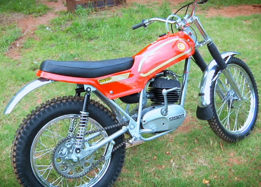

There must be a connection with Gregs and :montesa as they have just restored a 247T on American Restorations
Now they have finally got the spanner going the right way, plus both Rick and Greg rode the 247T like it was meant to be ridden almost makes up for leaving the rear guard off the coin operated Italjet!

I did one myself a few years back 2006, 247 trials cost me $10,000 because i had to buy everything nos as I only had a frame and tank to start with. My other 247 in 2003 cost me very little about $1500. If you want a concourse resto basiclly everything has to be replaced or reconditioned. In about 6 weeks I will have a brand new 1980 cota and I don't want to do the maths.
