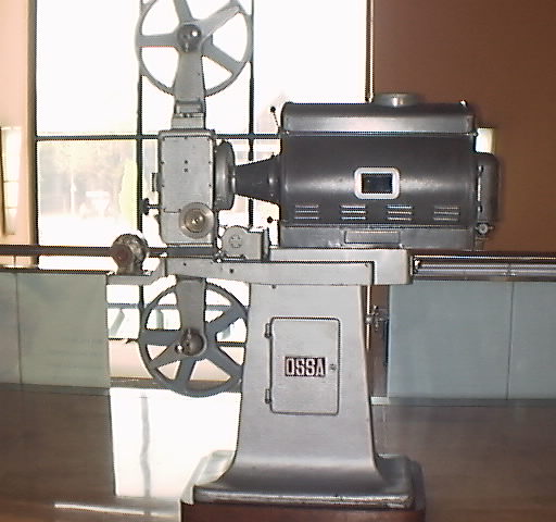

GRAPHIC AND PUBLICITY HISTORY
Throughout its history, Ossa has used numerous logos and graphic resources in different advertising media. It’s
image has always been based and had as main protagonist the symbol mistakenly known as the Ossa “clover”. But
in fact if we look at the beginnings of the brand, this element is really representing one of the pieces that were part
of the cinematic apparatus that the company made.
(Still looks like a clover to me?)

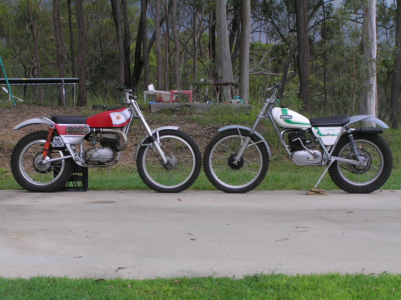

To illustrate the development rate of trials bikes in the beginning, the photo shows a 1968 Bultaco Sherpa T and a 1974 OSSA MAR.
At the time the first MAR came out (1972?) it was regarded as the trials superbike by many people, and as well as the massive increase in ground clearance, the OSSA was also quite different to ride compared to the Bultaco and Montesa trials bikes of the same era

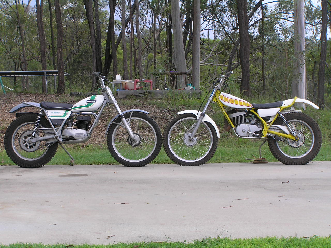

Another photo shows the development made in design between the 1974 OSSA and a 1981 Yamaha Godden Majesty. Again a big increase in ground clearance, a further reduction in seat height, and an increase in rear wheel travel
