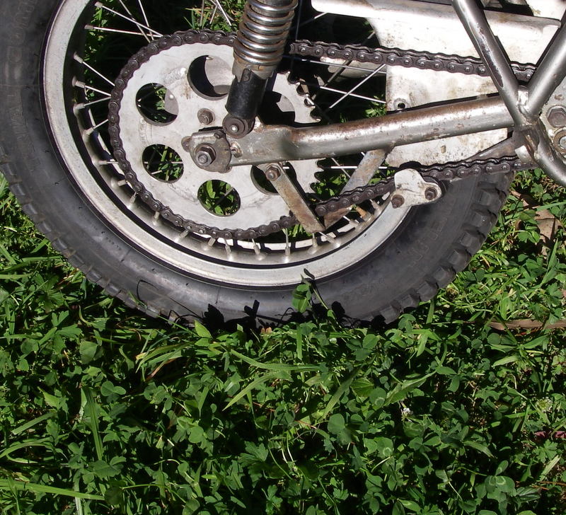

OSSA time is coming soon - well in a few months anyway - so today I started getting mine ready for the big weekend at Conondale.
I've noticed that Greg Harding has been making a big fuss about the rear axles woes on those OSSA MARs that he is getting ready for Conondale. Because I didn't want to feel left out, I've just fitted an old Sammy Miller axle bearing extension kit to mine.
I think I have fitted it the way that this one was originally intended (outboard of the sprocket). I think there is another type of axle bearing extension kit, that is intended for use with flat sprockets, and that one logically fits on the inside of the sprocket.
At the same time I fitted a new rear axle, because the old one was looking pretty sad - I remember straightening it a few times, and it probably had countless straightenings before I got hold of the bike. One useful bit of knowledge is that the swingarm axle from a TY250 twinshock makes a very good replacement OSSA MAR rear axle.
The spacer kit I fitted puts the RH wheel bearing 25mm closer to the swingarm, and it uses the same size bearing as the other two bearings in the OSSA rear wheel.
Another maybe useful bit of info about the OSSA rear wheel is that it takes the same size bearings as the front wheel of the Kawasaki KT250.
Anyway here are the before and after photos of the rear wheel:
