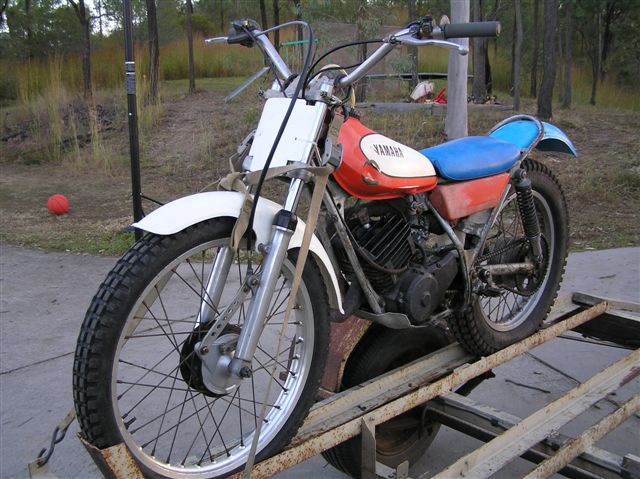

In the Greg Harding fashion, here is a bike I have just set up for a local youngster to ride. We met Timothy through Scouts and he has persistently asked about our local trials every time I saw him and lives a stones throw from one of our Trials venues between Gladstone and Calliope.
The bike will live at Tim's place for a while so he can practice after school, and he is keen to ride in our next event which is in a few weeks time.
Most of the bike came via Hagsta a few years ago when he had run out of room in his shed. Prior to Hagsta, the bike had been ridden up in Townsville and at some stage had been owned or worked on by Noel Pearce up there. It was quite an interesting setup when I first saw it because of some unusual mods:

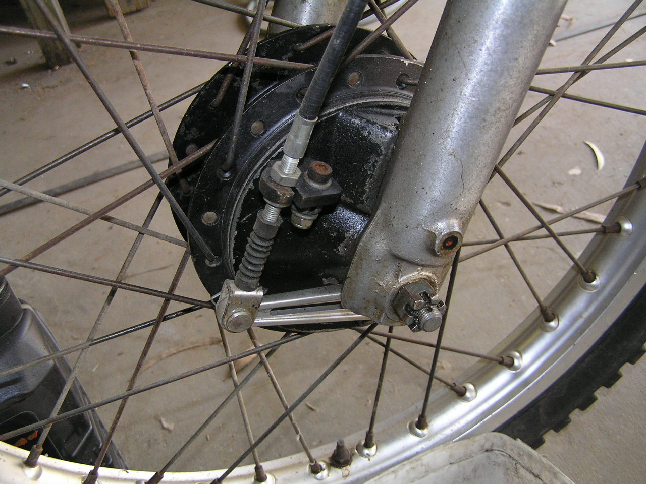

The front wheel was off a Yamaha dirt bike - (maybe IT125) with a lightened and over length brake arm and modified cable end holder to suit (amazing brakes)

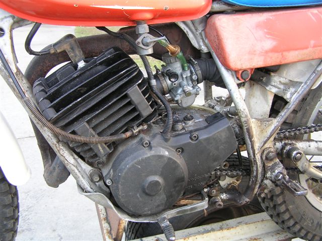

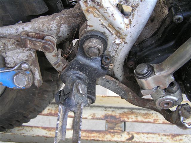

The motor is a combination of DT175E (barrell), DT175F (bottom end), AG175H(carby) and IT125/175 or YZ125 clutch cover. The different clutch cover required a new brake pedal stop to be made and this was part of the footpeg mount - quite a neat job actually.

I fitted a TY175 flywheel and ignition and trimmed the insides of the DT cover till it fitted over the TY flywheel. The jetting was all over the place.

The DT forks were quite short travel compared with TY175 and had a poor action so I fitted the forks off my normal TY175 (it has TY250 forks), and found a TY front brake backing plate so the wheel fitted the TY forks. TY cable.
I can't remember what bars were on it but I fitted nice high rise alloy bars from somewhere.
I fitted some nice tyres today.
The blue rear guard is a hand-me-down from my Alpina and the front a hand-me-down from another TY at home. The plastic side cover came from ????
Today I got stuck into the jetting and got it running very nicely. The carby ended up with standard AG175H (26mm OEM Yamaha-Mikuni) settings except for reshaping the needle to be the same as a standard TY250B needle.

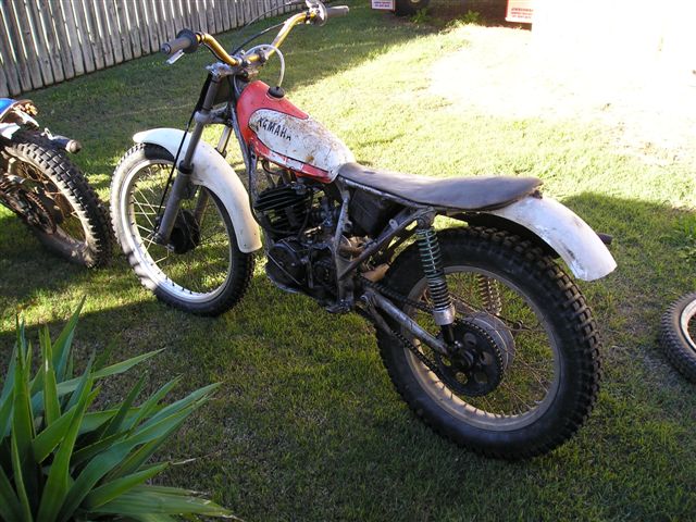

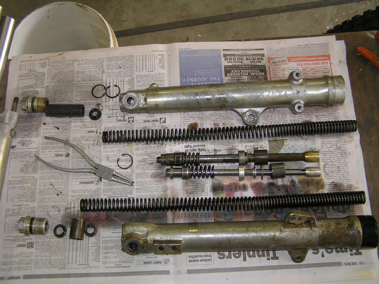

I know there are more before photos somewhere but for now all I could find of interest is one showing the front brake detail with the DT125/175 forks and another showing how different the forks are to the TY forks inside

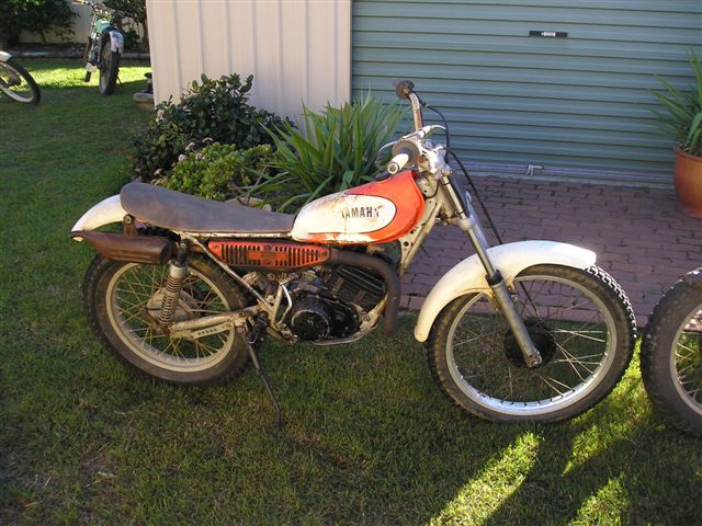

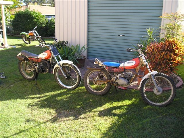

By courtesy of Lindsay Haig, here are some "before" photos of the TY175 featured in the post above.
