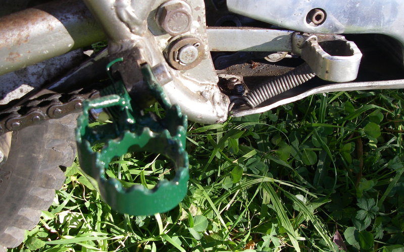

Re: Basket Cases OSSA FOOTPEGS
Posted: Tue Aug 12, 2014 9:47 pm
David Lahey wrote:They look fantastic Chippy. Can you do some close-up photos of the brake lug problem? Did you sort out the chain tensioner/brake rod issues?
David, working on old bikes can make you wonder WHAT were they thinking, the :ossa rear brake is one of them! Whenever making things, it is usually good to make them have more than one function. However the chain tensioner spring needs more tension than a brake pedal, when combined together makes the effort to apply the brake so great that there is little or no feel. My solution to the problem was to add another spring that helps apply the brake, here is a photo of the test jig:
