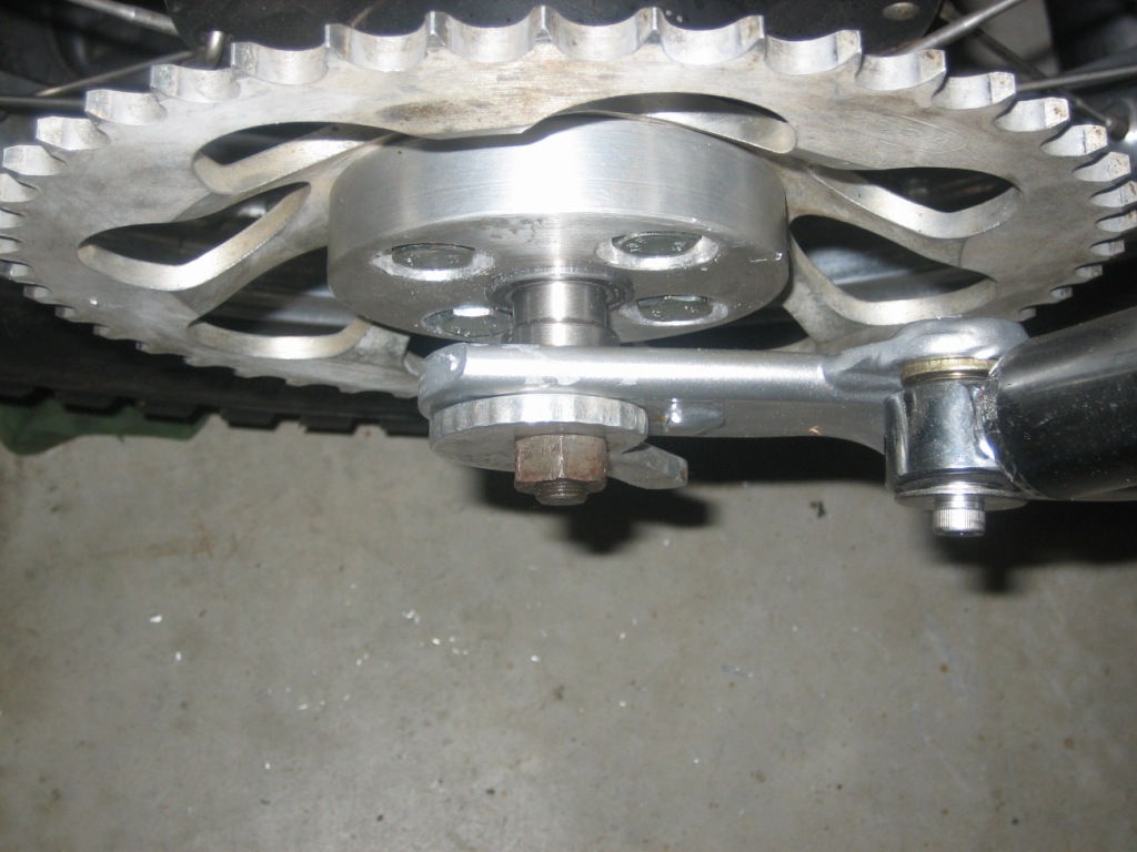

Getting back to the :ossa , yes they are very weak in the rear axle and Greg Harding has once again excelled himself and turned me up a rear axle spacer that attaches to the rear sprocket and also houses a bearing in it closest to the swingarm. You will see the detail in the photo below. If anyone else needs a rear axle spacer for their :ossa , I am sure if you contact Greg, he will be able to make more.
ossa rear axle bush 003.jpg (173.77 KiB) Viewed 6780 times

Yes chippy, The Avon Mudplugger was a 3 ply Trials universal which whilst apparently a great short circuit tyre, was a pretty ordinary Trials tyre. The ones i used were specials flown in from England and were 2 ply they were pretty good. I remember i couldnt stock up on them because they had to be "fresh" so the compound may have been diferent as well. The Avon T shirt on the other hand was great and i still have a couple, they do seem to have shrunk over the years as they seem a very tight fit now ( ha ha ). That Ossa axle mod looks the goods . They just seemed to have too long a length axle unsupported and if you were hitting things hard they woulnt take it.

The explanation given to me in about 1978/9 by Chris Holden was that the rear hub on the MARs was a moped hub and so was a little light-on for width and strength.
Sammy miller sold me an outrigger spacer with bearings, long bolts and a flat sprocket that fitted outboard of the spacer.
I still had trouble getting the axle out of the hub after it bent until I had Dave Gustar from the Elliot Turbomachinery tool room make me up a chrome Moly axle. Fifteen beers one night in the Duke of York, debt repaid.
My mates used to grind the diameter down on the stock axle so that it was a loose fit in the bearings so it was easy to punch out but that seemed to me to be a farmer's solution. Probably because Bun and Nick Symes were farmers.
