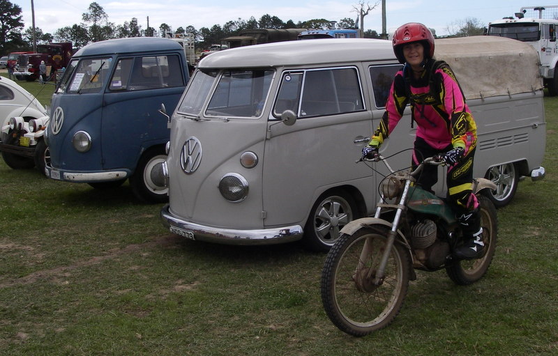

Well it has been a bit of a mission, but the
172 lives and runs quite well. After many hours sorting the kickstart mechanism, I was able to source all the parts needed from the parts bike (Red one) to get it working. Then it was just cleaning the carby and ignition system and fired it up. So we decided Donna would ride it AS we found it (Except for getting it running) at the:
So NOT YET CLEANED, RUSTY loose spokes, worn out LOOSE wheel and steering head bearings, LEAKY cracked fuel tank and almost 40 years of accumulated patina kind of makes Donna appreciate the TLM even more

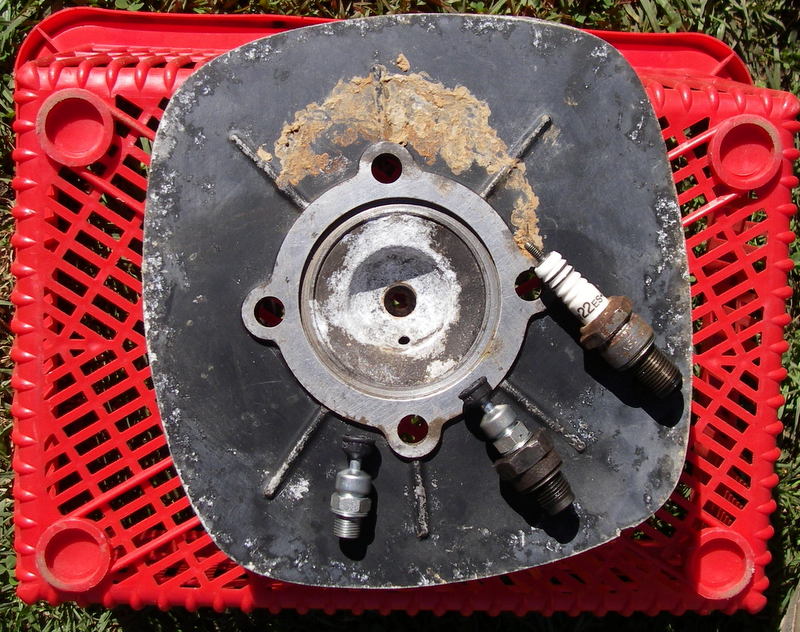

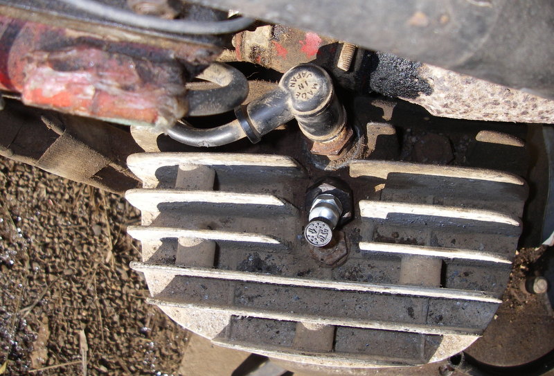

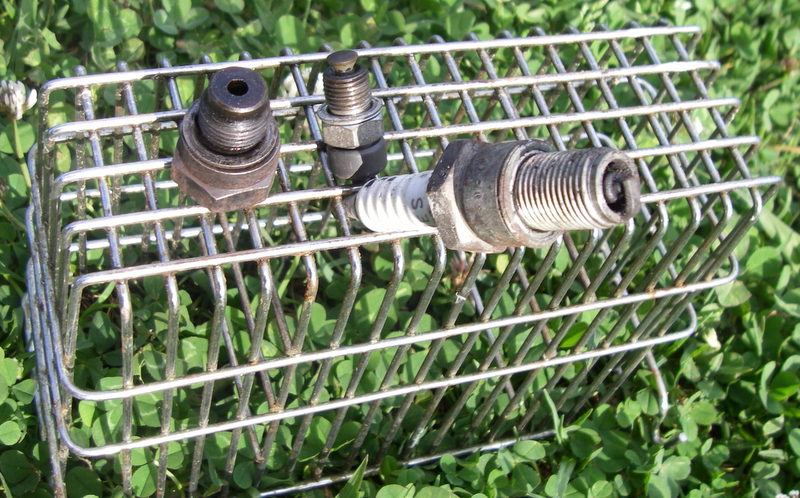

While I am talking about the
172, I thought I would share a little more about it. When the clutch cover was off for repairing the kickstart mechanism, it surprised me just how light duty all of the components are, no wonder the kickstart is the reported to give trouble. Luckily the spare parts bike seems to have not done much work and had all the bits I needed. Knowing that things don't improve with age, I decided to fit a decompressor to reduce the load on the gears, shaft and lever. There were a couple of options, Victa vacuum type, remote lever cable type and the chainsaw push button type that I chose because it is simple. The 172 has a blanking plug that is easy to get to, so I drilled and tapped 10 x 1.0mm thread in that, leaving a small port for venting but not big enough for the valve to pass through just in case. So just push in the button and when it fires, the button pops up closing the valve, good so far.
Here is a photo of the spare head etc and fully assembled:

Greg. Did it help much? My Ossa has a de-comp in the head and it stops the motor running when pulled in, no way it would start with it pulled in either.
Most 2 strokes with a starting de-comp have them half way up the cylinder coming in from the side. Early 360 Yamaha's had them mounted at the front and open a passage above the exhaust port into the exhaust.

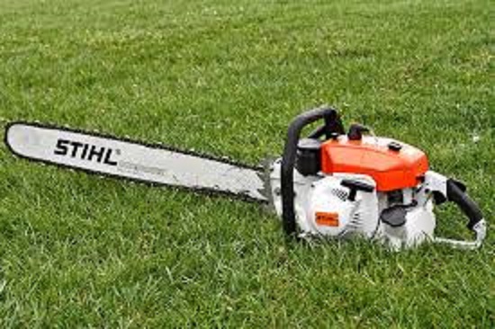

TriCub, All seems to work fine, not sure if you have ever kicked over a
172, they are awkward to say the least. Because the decompressor is designed to pop up in to the closed position when it fires, it is hard to tell when exactly it closes. It did stay open once with the motor running (sounds different) until I opened the throttle and it closed. My Stihl 090 chainsaw had a decompressor very similar and at 130cc, it needed it!The decompressors are cheap so I was concerned the valve might drop off and cause problems. The bung is limited in depth where it needed to be drilled and tapped so I worked on minimum clearance with the valve open leaving an option to add shims to adjust the clearance. Perhaps that is why it works along with the restriction of the ports in the head and the bottom of the bung?
What type of de-comp is fitted to your
and how big is the release port, perhaps it is too big stopping it from running? Stimulation can be a good thing so I fitted it to Chippy's
, It made it easier to start and still runs when held open. I am not sure if it is another left field
thing, but the exhaust is directly in the "V" created by the 2 sparkplug holes making it easy to burn your fingers depressing the de-comp, unless of course the head is on backwards Look forward to seeing you riding your

Re: Basket Cases Rusty Iron Rally
shkabir, welcome to the forum! What sort of riding do you want to do as it may help you work out what is the best bike for you?
TriCub, I was wondering why you fitted a de-comp to the
as they are pretty easy to start. Just looking at the quality of the lever and spline which are quite robust, they don't look like they would give trouble, having said that I have not looked that closely at the gears inside. Is there provision to adjust how far the de-comp opens?
Just sharing a photo of the Rusty Dungar that I rode in the Rusty Iron Rally Grand Parade with Donna. Rock hard tyres, loose wheel bearings and forks that were stuck on full extension YAMAHA TY250B. This is the one that I swapped my Honda XL250 Motosport for:
