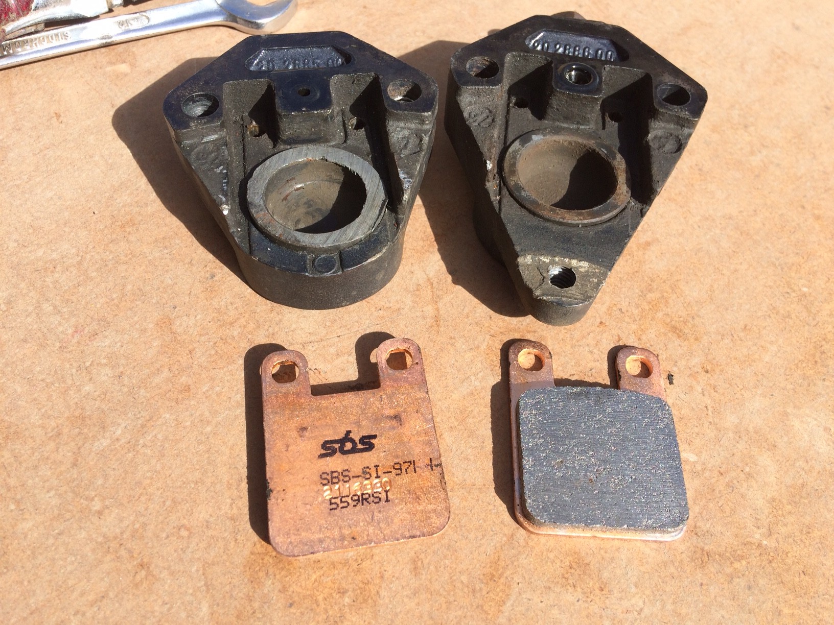

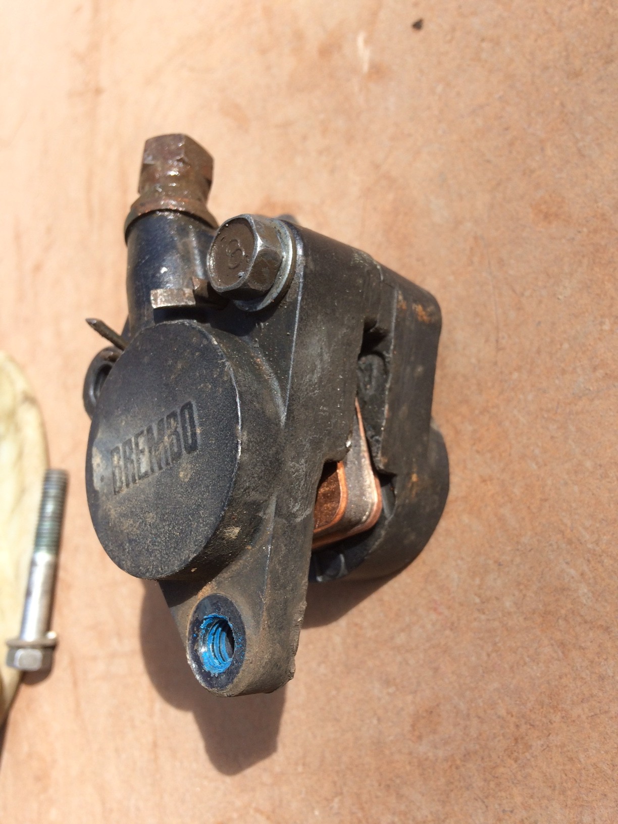

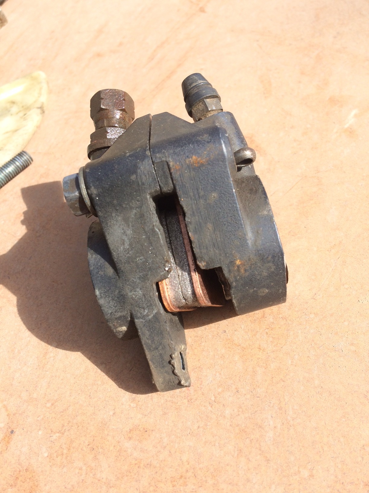

Re: 1994 TY250Z Advise / help required
Thanks Paul.
You are correct, the rear rim is 36 spoke. I will check out your website re the rim and footpegs.
Attached are some pictures of the rear Brembo caliper.
The diameter of the pistons is 32mm.
The disc pads are SBS replacement pads that my local Yamaha dealer was able to get for me.
Pretty sure the rear brembo caliper on the TYZ is the same as the front one and is the same caliper as fitted on the front of the TYR Pinky- in which case you can get new piston and seal kit from tytrials.co.uk. - OR you could swap the front caliper onto the rear and then fit a 4pot braketec or AJP caliper on the front and get a much better front brake. Mounting centres are the same.
I have the repair kits for those Brembo callipers in stock. They come with new 32mm pistons and the seals.
Our Part number is R260001
Thanks Andrew, I can remember Todd's sidecar, but can't recall having seen any TYZs ridden as solos, but then I spent the 1990s in the navy and only managed to ride a few trials in Vic on my bully outfit in 1992 or 1993 (hard to remember which year). I think Todd was still riding the TYZ when I came to SA in 2003 and started to get back into riding with the old Bully.
I am sure that when I get this one running and take it to a trial that someone will tell me all about it comp history.
Hell Team, thanks, I have just ordered a repair kit. I like to deal with locals before going off shore for parts.
