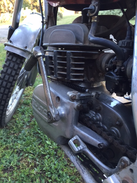

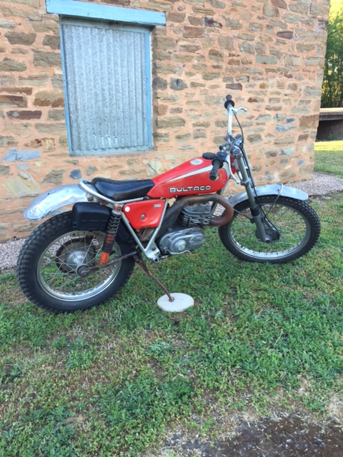

I know nothing about Bing carbies, but have been trying to educate myself on them lately via google, I still know nothing other than where I might get some replacement parts from.
Basically I have a soon to arrive(maybe tomorrow) 325cc '76 Sherpa T (183) which has a non std carb fitted and I want to fit an original T84 28mm Bing. I have bought a used one from flea-bay for/from a Sherpa apparently, but it needs a complete refurb.
What jetting/slide etc would people recommend please.
