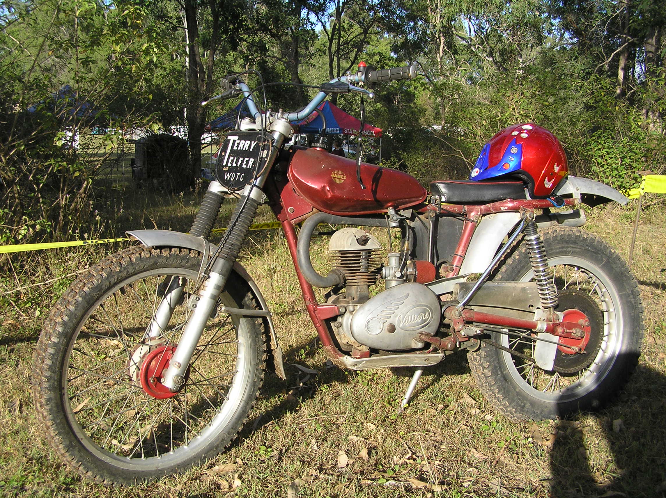

Terry Tefler, now owns my old 197 James Captain.

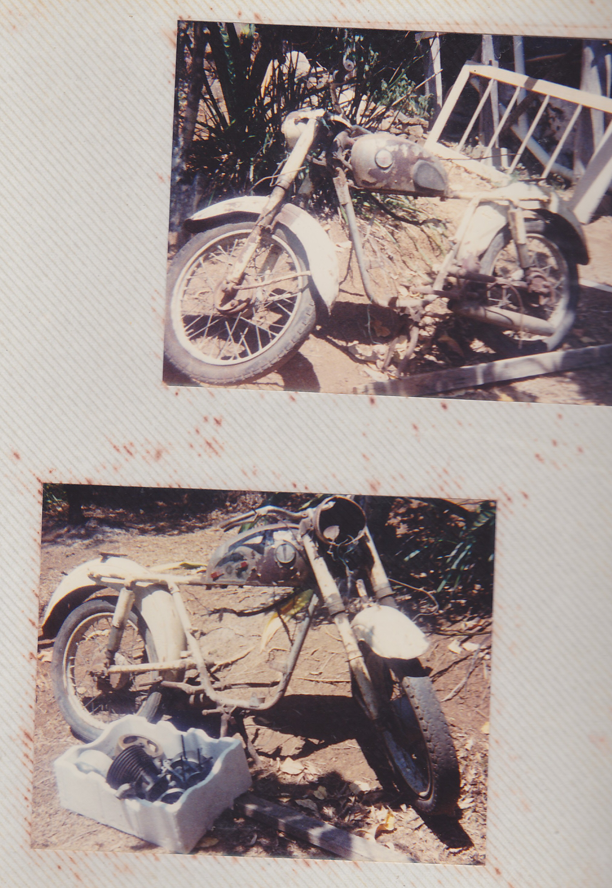

Roadster frame, from Brisvagas somewhere. 197 and 150 Villiers motors from Pioneer Cycles, Nambour, and weeks of work.
150 motor, went into Mick's CZ rigid. 197 into my James. both with 3 speed Villiers boxes.

I rode that James Captain last weekend. Was more than a little impressed how nicely it steered, handled and pulled up high creek banks. Nicely developed considering it was once a street bike.

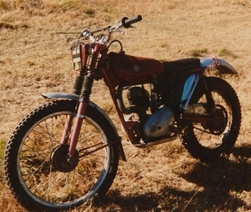

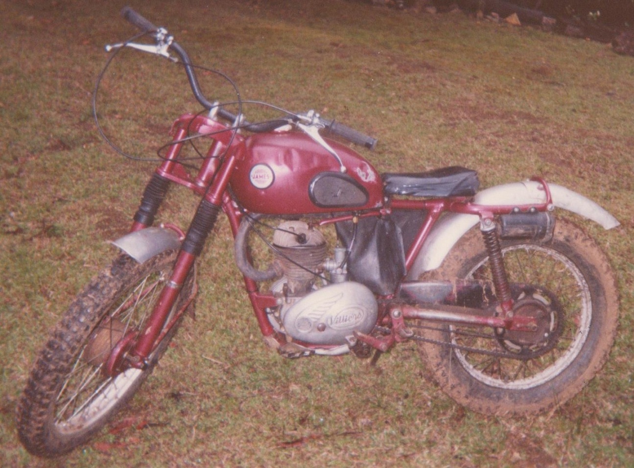

Hi JC1,
I tweeked the frame, heating the two steering tubes, then with a rope I wound it up and back till it was the same wheel base as the works James trial bikes.
I was hard on it, so broke everything I could break, then fixed the problems.Terry should never break anything.
It pull so much better than other Villiers 6E motor, Trial bike competing at the time. At on Trial, the barrel was removed and loaned for measurement made and ports checked. Think Ron Chadwick may have been involved.
Came back stock standard. I made the exhaust system.
Maybe be I just fluked everything spot on. Carby, exhaust, and timing setup.
I just dropped the base barrel gasket, and shaved a mm off the head, Did make up a full circle crank, adding alloy blocks to a 'T'
bob crank, and had it machined up. Don't know if Terry is running this crank.
Also it could swim quite well. See If I can find the pic.
Happy to see my Old James, still around, and being used, for what I developed it for. The roaster tank did leave nice bruises on my knees , at the end of a days riding

I tho't the rake seemed pulled in a bit for a street bike of the day. Who fit the Betor front end - you or Terrry?

I ran The stock STD front end. Rubber knee pads on Tank pic, was my ownership days.
Top seal being one 'O' ring, held in place by a split brass collar, made changing 'O' rings easy.
Loved the days of myself, having a strange idea/design, and lucky enough to have a couple of older engineers, retired, that gave me the time of day, to experiment.
Remember one saying, 'nothing is easy, when you walk in my workshop' any way the collar worked.
Not sure if Mick Butler or Terry made the changes.
The front bend of the exhaust was made by filling a exhaust pipe section with dry sand. wooden plug tapped into each end. Plumber mate heating with oxy and hand bending. Good old days.
