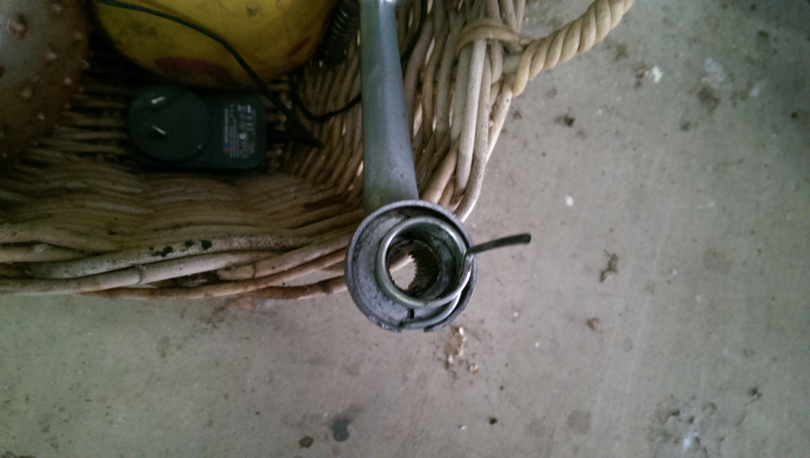

Now trying to fit the new kickstart lever return spring. The hook on the spring locates in a notch at the bottom of the lever (as fitted) and the other end of the spring locates in a hole in the casing. Problem is the spring has to be "wound up" about 180 degrees to get the lever in the right position, then if this is possible, when I kick it over the spring will load up another 180 degrees which seem way excessive. I believe the spring will fail quickly if I can even assemble it like this.
Does anyone know the correct assembly process?
Seems to me the spring isn't correct, but it looks like the drawing in the parts manual and is the one sold by Inmotion in England for this model.
Any help with this will be appreciated.

Re: Montesa Cota 247 kick start
I'm sure I don't wind mine up anything like 180 degrees before sliding it onto the spline, more like about 30 degrees.
OK I've had a look and will post some photos
Cota 348 and In Motion spring
- IMAG5529.jpg (951.52 KiB) Viewed 9545 times
- IMAG5530.jpg (1.67 MiB) Viewed 9545 times
Thanks for posting those pictures, I've sent an email to Pete at Inmotion - the hook on my new spring is in line with the pin, so at least 90 degrees "tighter" than yours, although it does look like the one in the parts diagram. Guess I'll wait to hear back from Pete in case I'm missing something - otherwise I'll have to modify it. Most kickstart springs that work like this (that I've seen) seem to have more coils with a slight spacing between them, this is quite different and gives the impression it's already wound up almost as far as it will go.

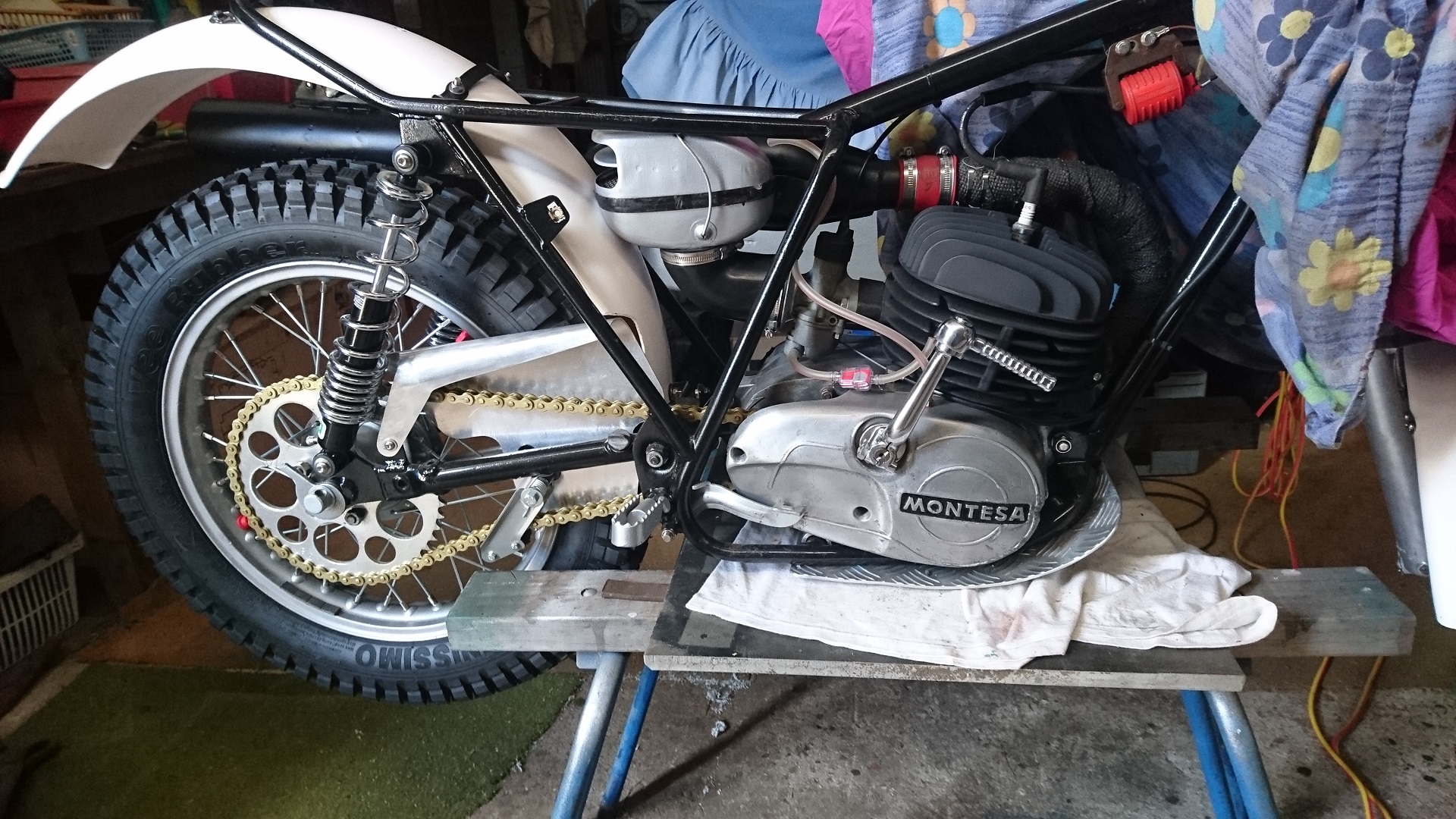

Got some pictures back from Pete at Inmotion and they showed the hook on the kickstart spring was a slightly different shape to what I had. Modified the spring and it's now together and working, only got the tank to go and I'll be able to fire it up.
