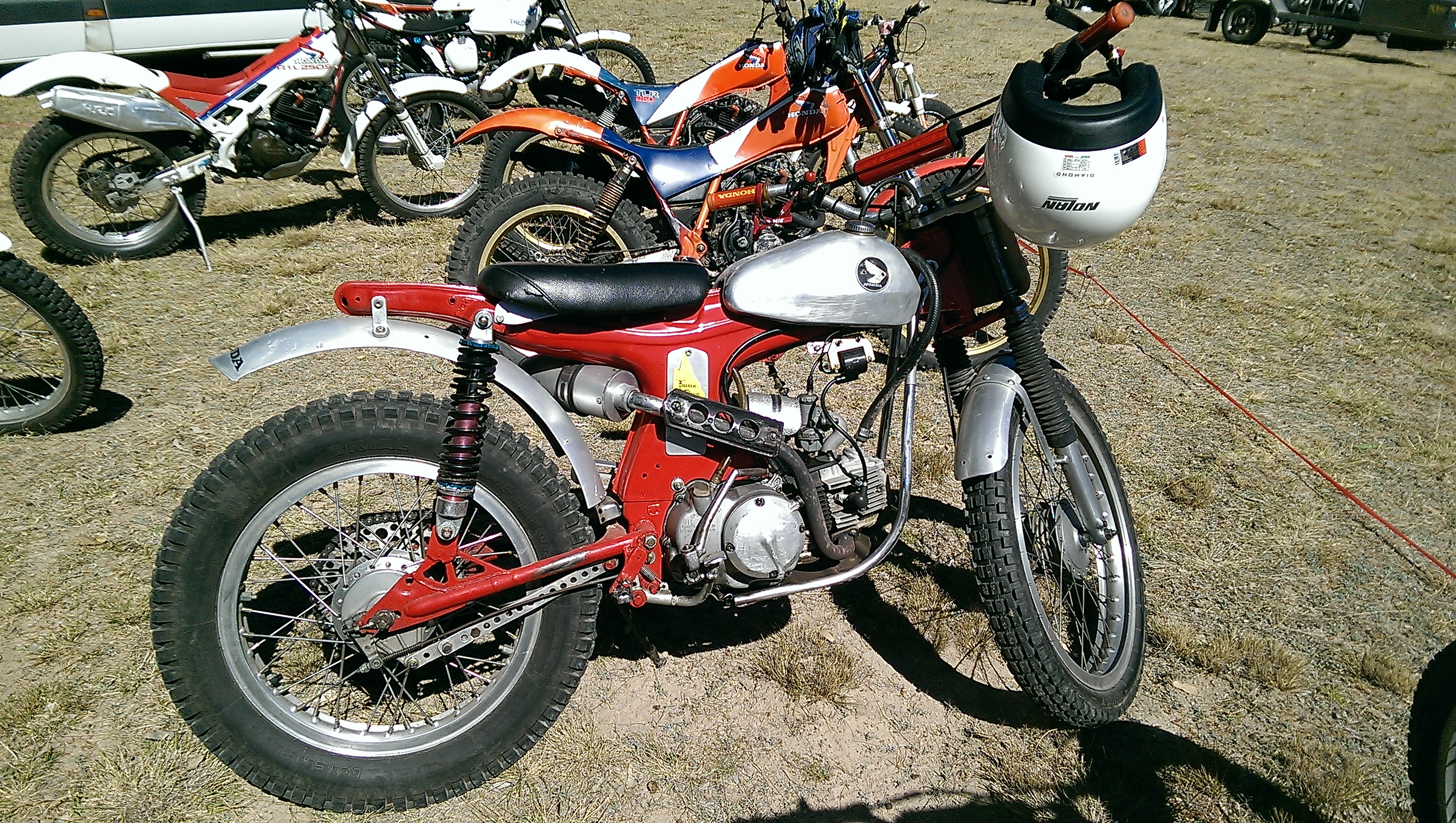

For info, here is a photo of an Australian Pre-65 Honda that is regularly seen at competitions. I know it's not based on a CT200 but thought you might not be aware of this bike.
- IMAG4667.jpg (2.69 MiB) Viewed 5162 times

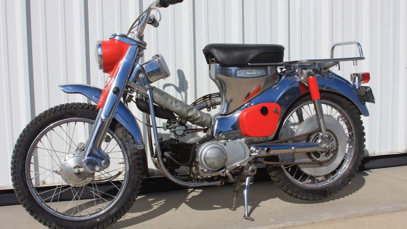

Here's a photo I just found on Google that might help with explaining what bike you are asking about
- lv0114-180249_1.jpg (77 KiB) Viewed 5162 times
