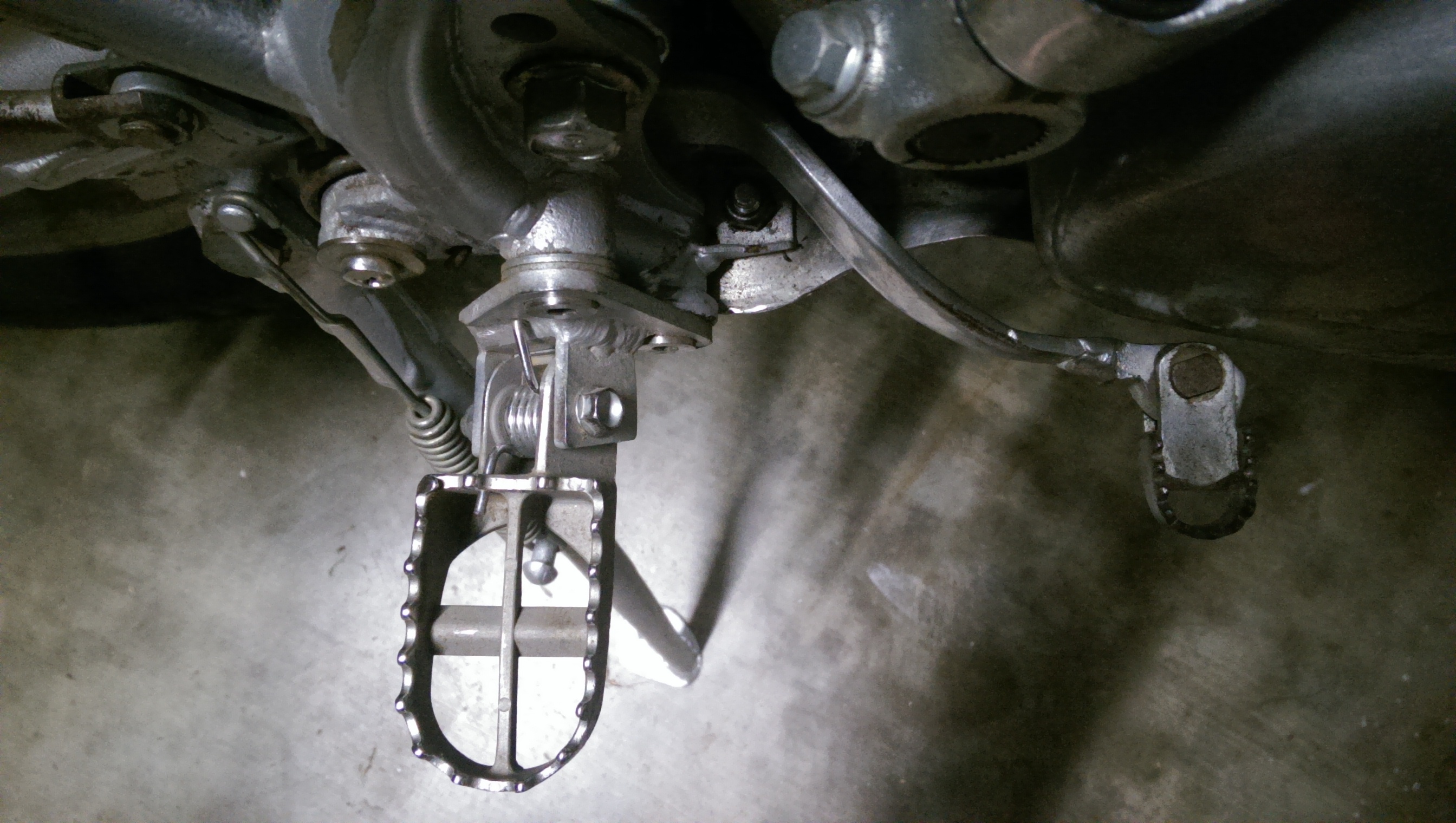

Another option is to make your own mounts. I've done this with a TY250 and welded standard universal footpeg mounts to it. The pegs in the photo are cast steel HEBO brand and came on a modern bike that my wife used to ride and are very nice but there are heaps of other nice big footpegs that fit the same standard mount hangers. The triangular mounting plates are made from 5mm steel plate and the upper attachment point is the stub from where I cut off the original peg mounts.
These peg mounts are low enough that I also had to remake the brake pedal so it cleared the rear right bashplate mount when the pedal is depressed.
As Kurt said it makes a huge difference to how well they go if you make the suspension work properly. The bike in the photo has just had some work done in that area and feels awesome to ride. There are magical springs and modified damper rods in the forks and some new 350mm Falcon shocks with 50 lb springs. In fact it was Kurt and Greg Harding who motivated me to stiffen up the front ends on my twinshock trials bikes and I'm loving it.
