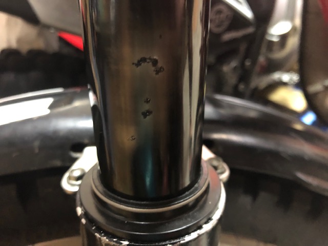

Hi Folks,
I’m trying to help a friend but their first Trials bike and $$$ are a little tight.
We’ve found a Gasser that seems ok, but both fork tubes have scratches. It has Marzocci forks with the black nitrate coating.
Has any body out there been able to repair the scratches or had the tubes recoated.
New inner tubes are over $300 each.
Any feedback appreciated
Gary

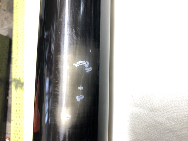

All fixed up now.
I had to file down gouges in alloy legs in a few spots.
I was advised to get some black Stewmac superglue from USA.
Thanx Paul
The stuff is great.
Took a few goes to fill with glue, wait to dry, file off excess glue round scratch, then redo to get damage filled really well.
There was 3 different places with lots of deep scratches in the Black Nitrate & alloy.
Image is of just one repaired area I repaired to give you all an idea of how well this glue worked.
New seals and no leaks.
My son's girlfriend is happily riding her Gasser now
Gary B
