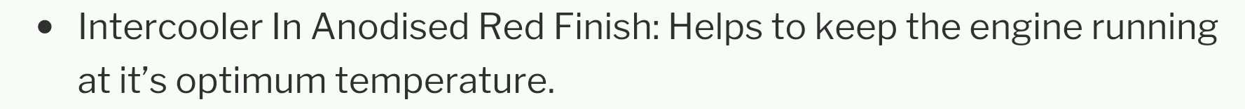

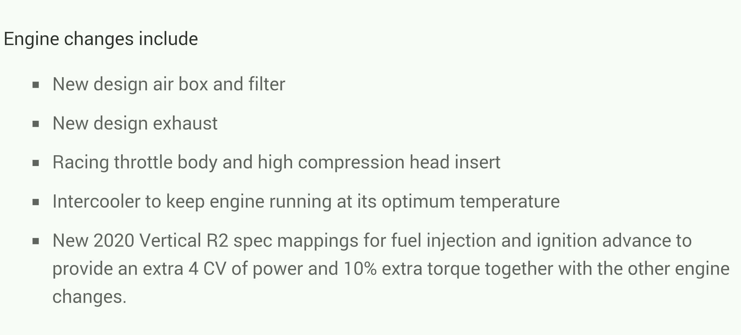

Can someone give me more information about this, number 4 on the list?
This is on the list on their website:

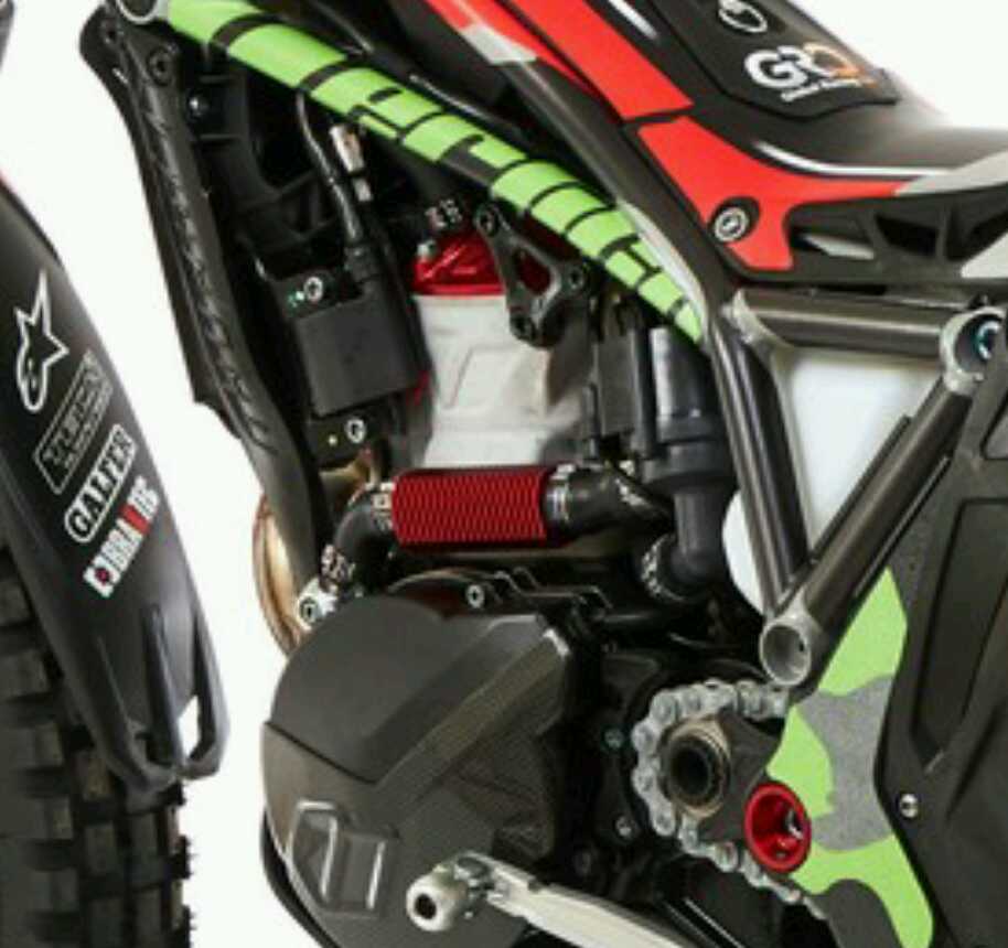

Centre of photo is what I think they mean? No not the head, Dummy.
Is something lost in translation? An intercooler to me is the air to air heat exchanger that is downstream from a turbocharger to cool/reduce the volume the air before entering the motor. Having said that, there is no mention of a Turbocharger in the blurb!
So I am wondering WHY would you have an intercooler and no turbo?
Or is it something entirely different?

Nothing new here, Hebo have been making this part for years. It is an inline coolant cooler. Available in red or silver. Here is the link on the Hebo site:
https://hebo.com/shop/es/trial/174-1067-refrigeratorrefrigerator-trial-enduro--scooter.html#/58-color-plata/82-talla-unica
