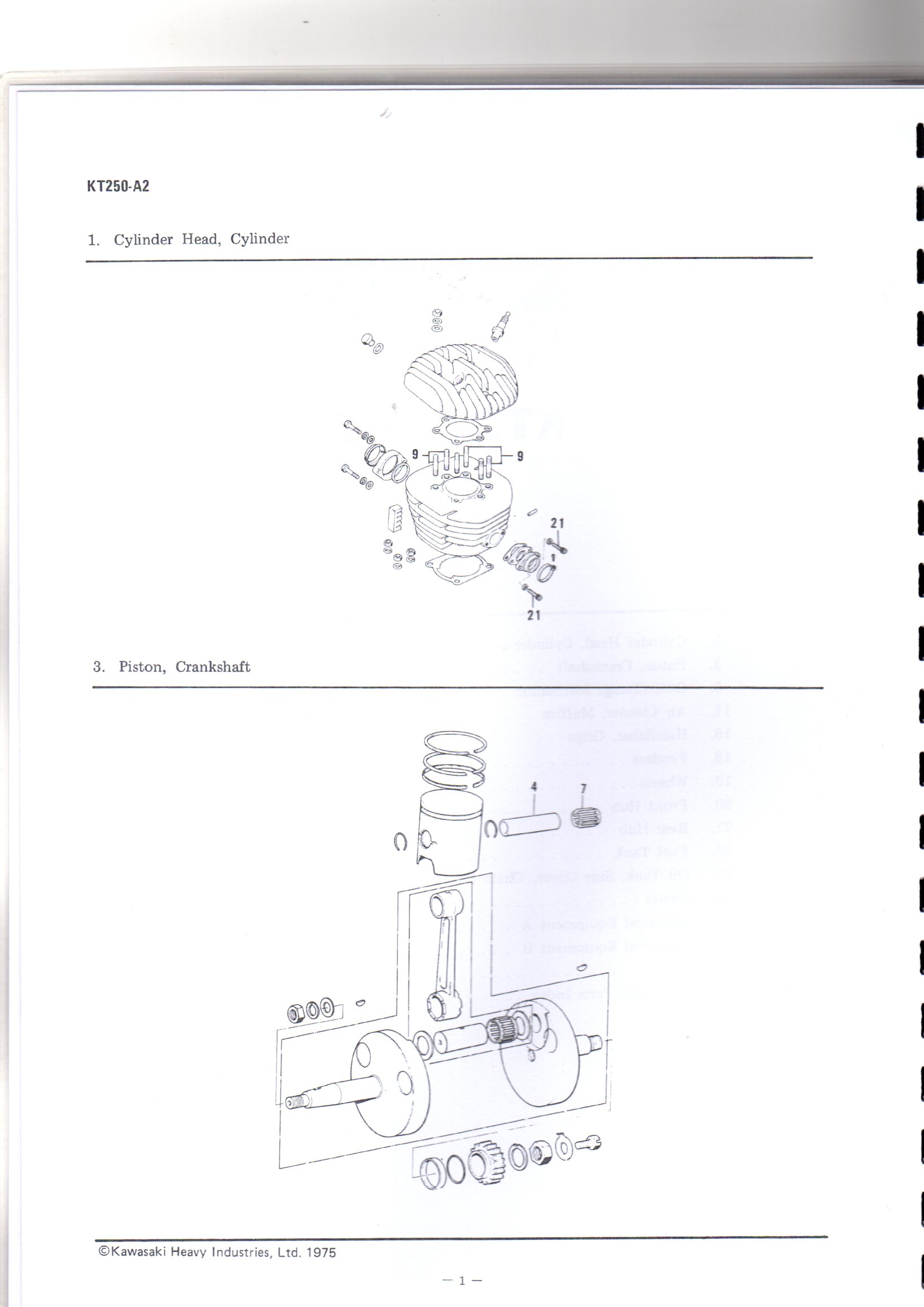

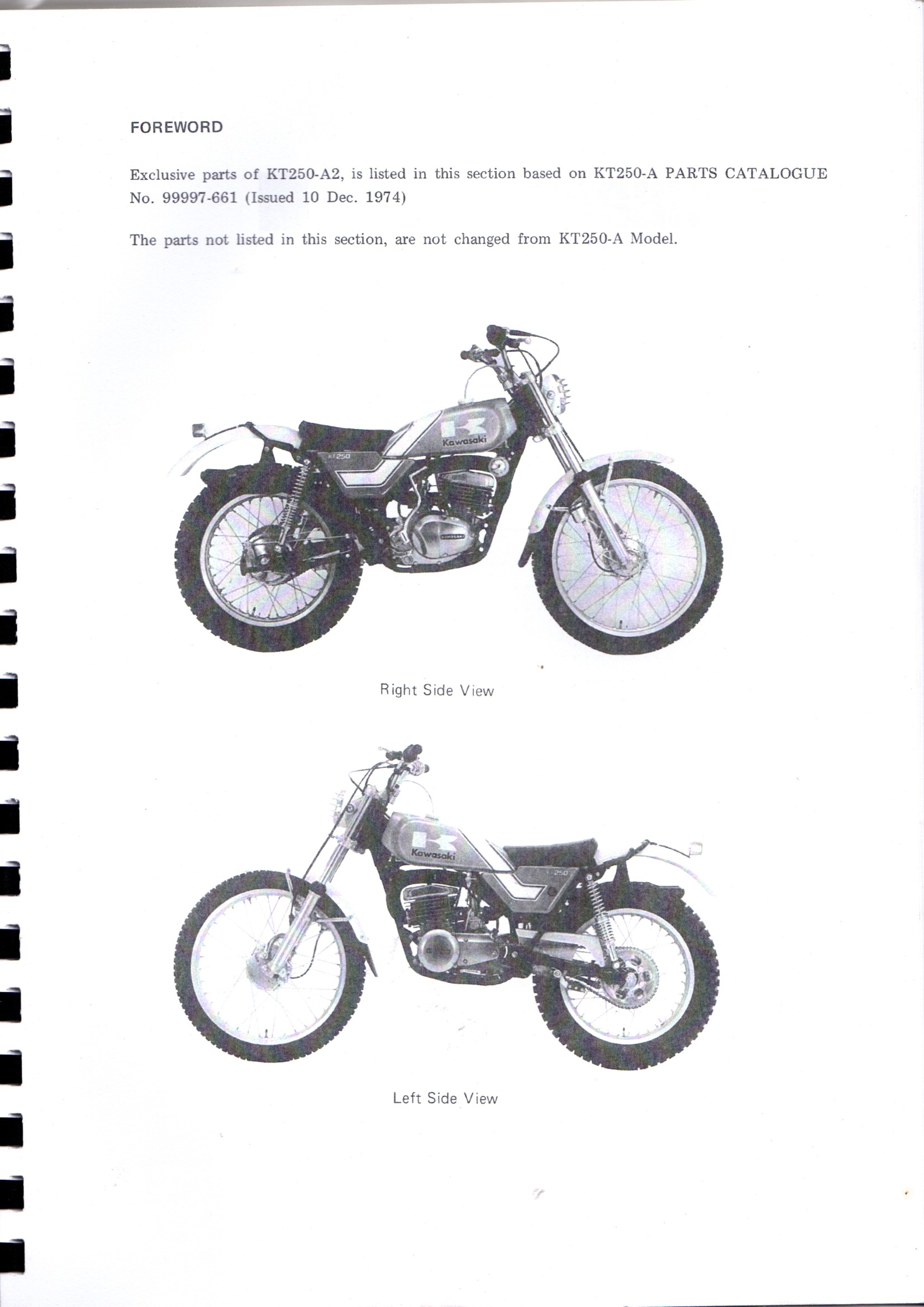

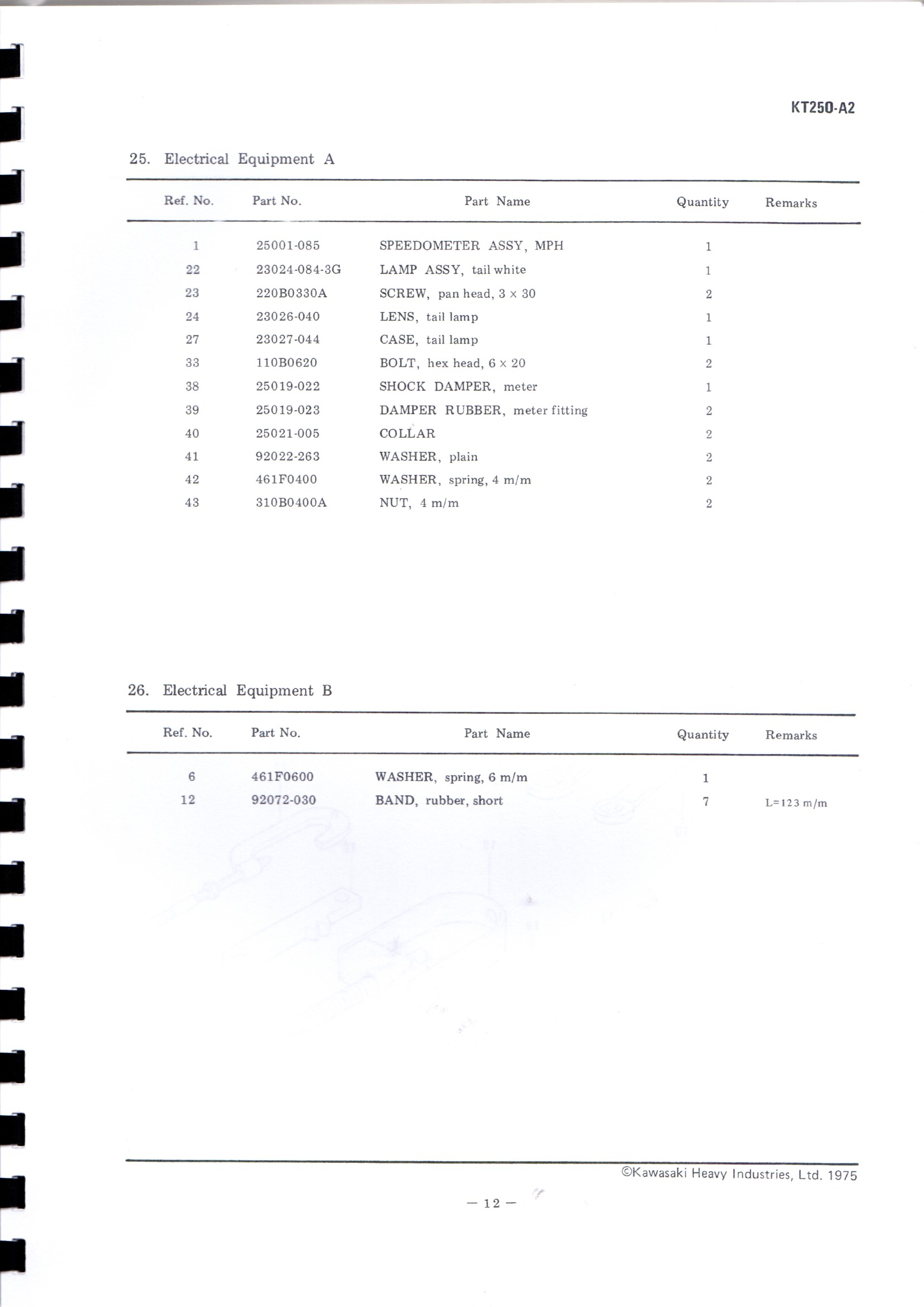

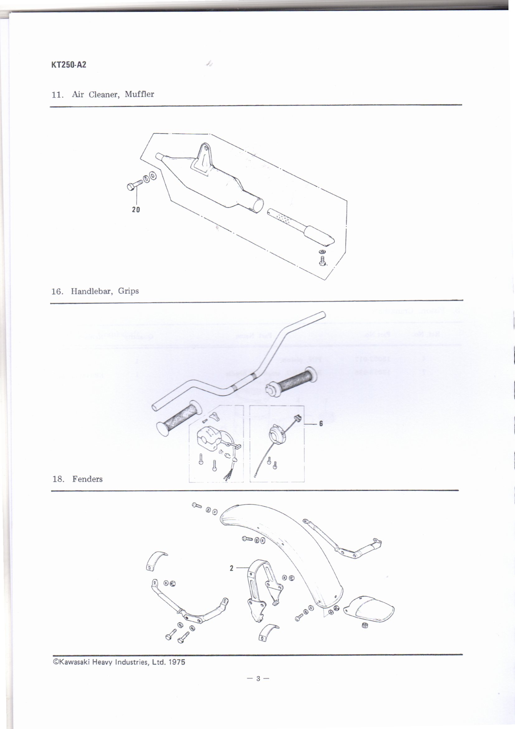

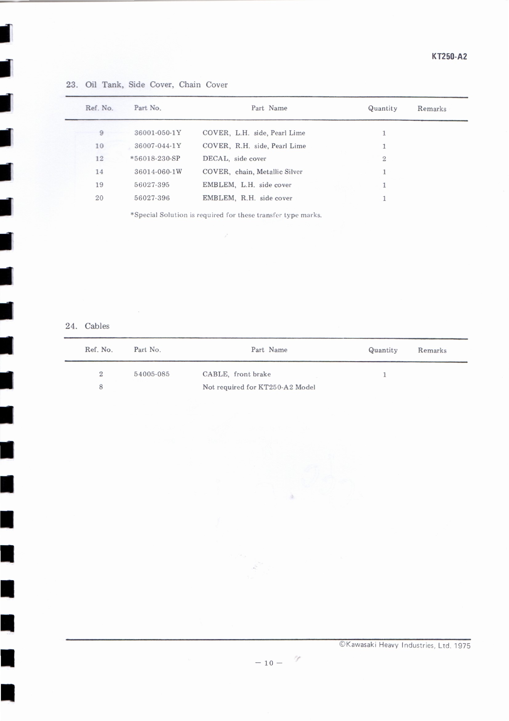

No major changes, just small stuff from what I can see from my parts manual for the '76 A2, note that only the numbered parts are different between '75 A and '76 A2. Also frame and engine numbers start with KT2 on my '76 A2.
Differences between A and A2 FOREWORD.jpg (369.11 KiB) Viewed 4392 times
Differences between A and A2 Part Numbers.jpg (328.95 KiB) Viewed 4392 times
Differences between A and A2 page 1.jpg (203.22 KiB) Viewed 4392 times
Differences between A and A2 page 3.jpg (188.58 KiB) Viewed 4392 times
Differences between A and A2 page 5.jpg (627.5 KiB) Viewed 4392 times
Differences between A and A2 page 7.jpg (705.44 KiB) Viewed 4392 times
Differences between A and A2 page 9.jpg (618.72 KiB) Viewed 4392 times
Differences between A and A2 page 11.jpg (702.16 KiB) Viewed 4392 times
Re: kt 250 differences
Posted: Thu Jul 02, 2020 6:38 pm
by Rod

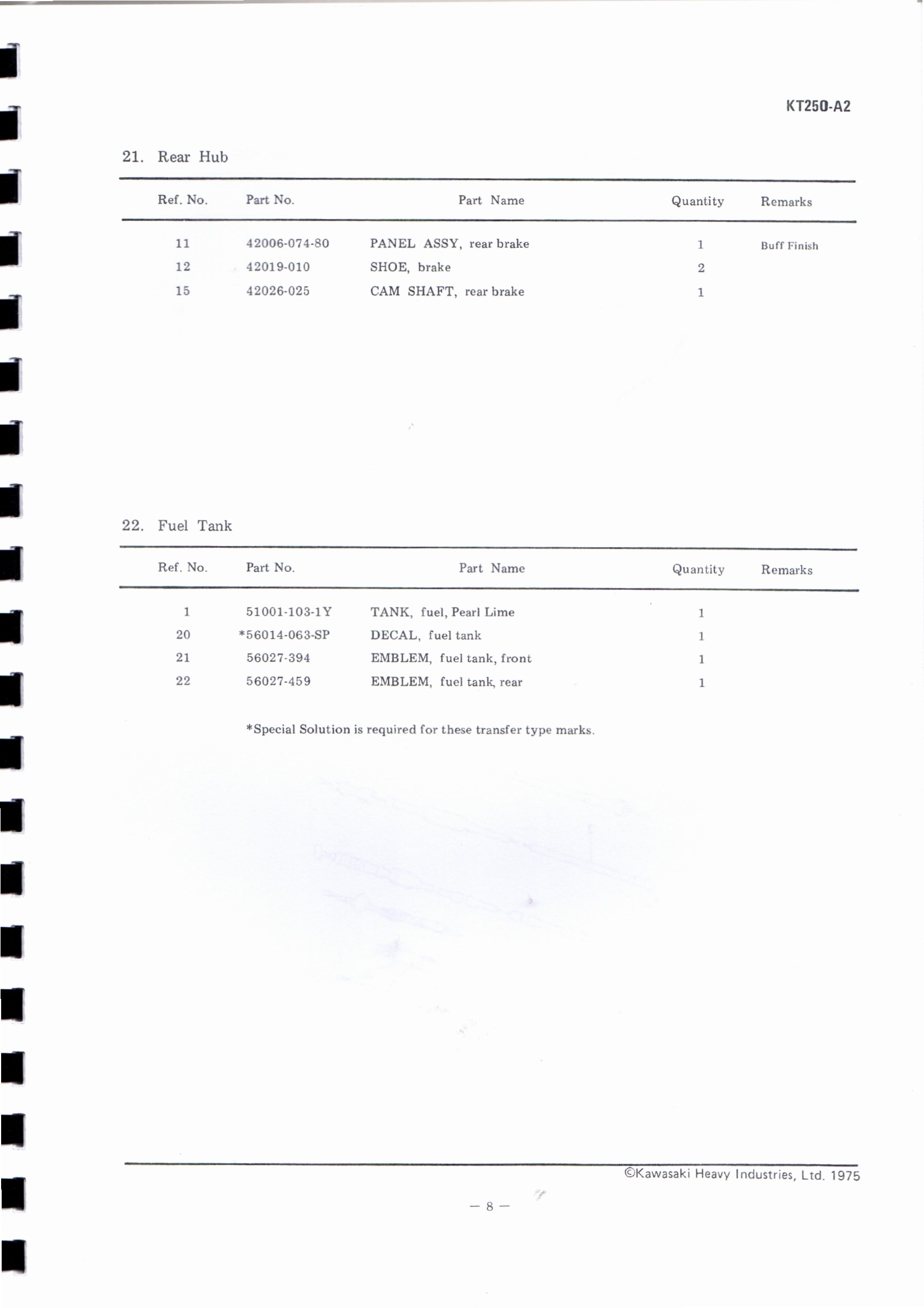

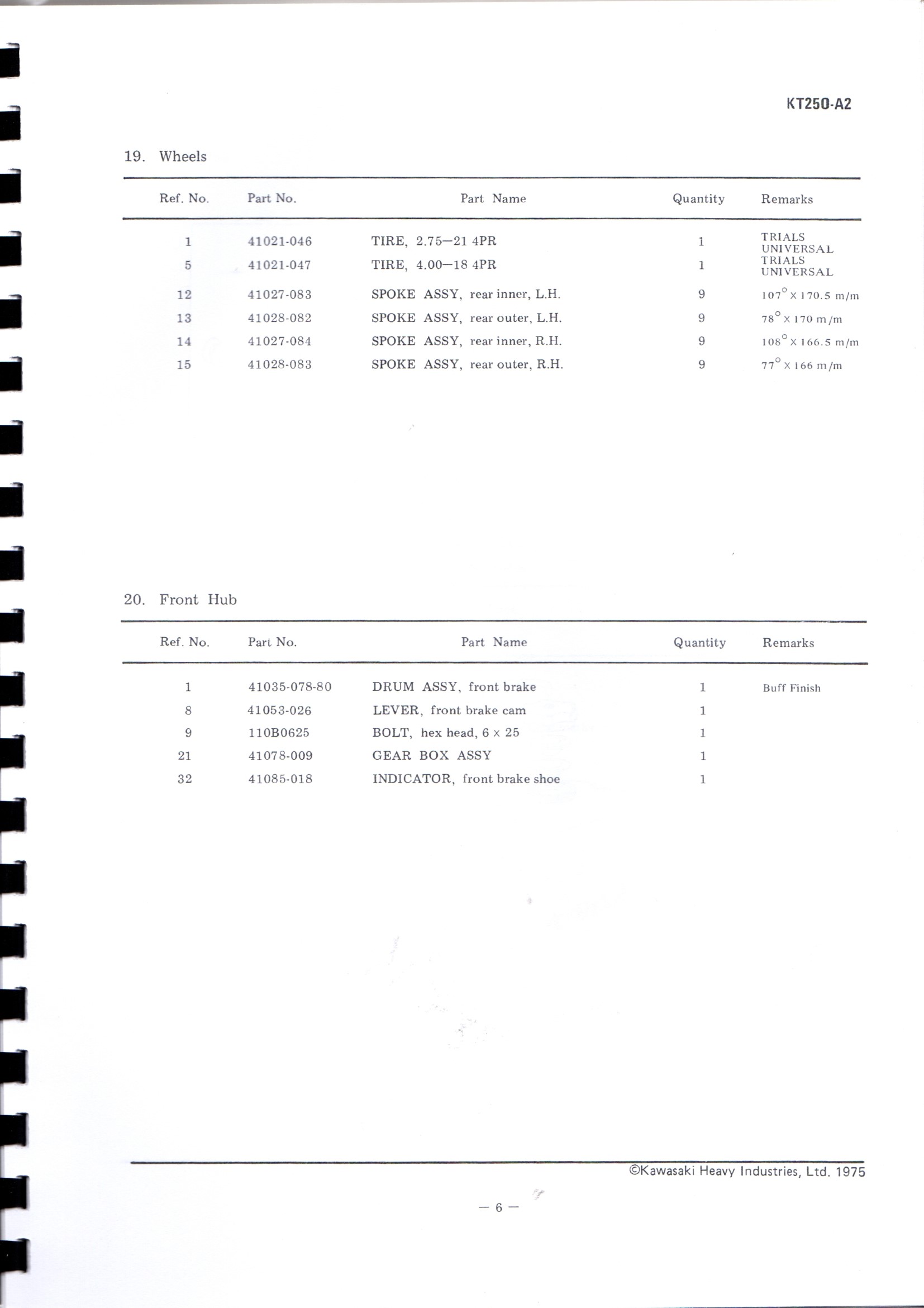

Here's the even numbered pages with the part numbers and descriptions.
Differences between A and A2 page 2.jpg (217.25 KiB) Viewed 4372 times
Differences between A and A2 page 4.jpg (195.99 KiB) Viewed 4372 times
Differences between A and A2 page 6.jpg (229.3 KiB) Viewed 4372 times
Differences between A and A2 page 8.jpg (195.22 KiB) Viewed 4372 times
Differences between A and A2 page 10.jpg (194.51 KiB) Viewed 4372 times
Differences between A and A2 page 12.jpg (238.63 KiB) Viewed 4372 times
Knock yourselves out.

by Rod
Hey Graham, other than gudgeon pin and bearing, the front hub seemed to be the most updated mechanical parts.
