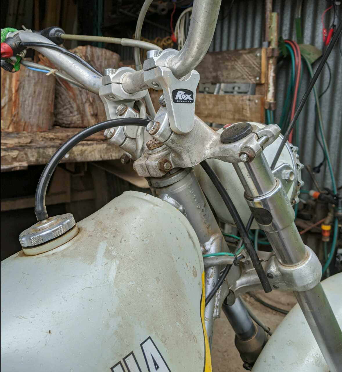

I installed some "rox risers" to move the bars up and forward and that made the whole set up work well.

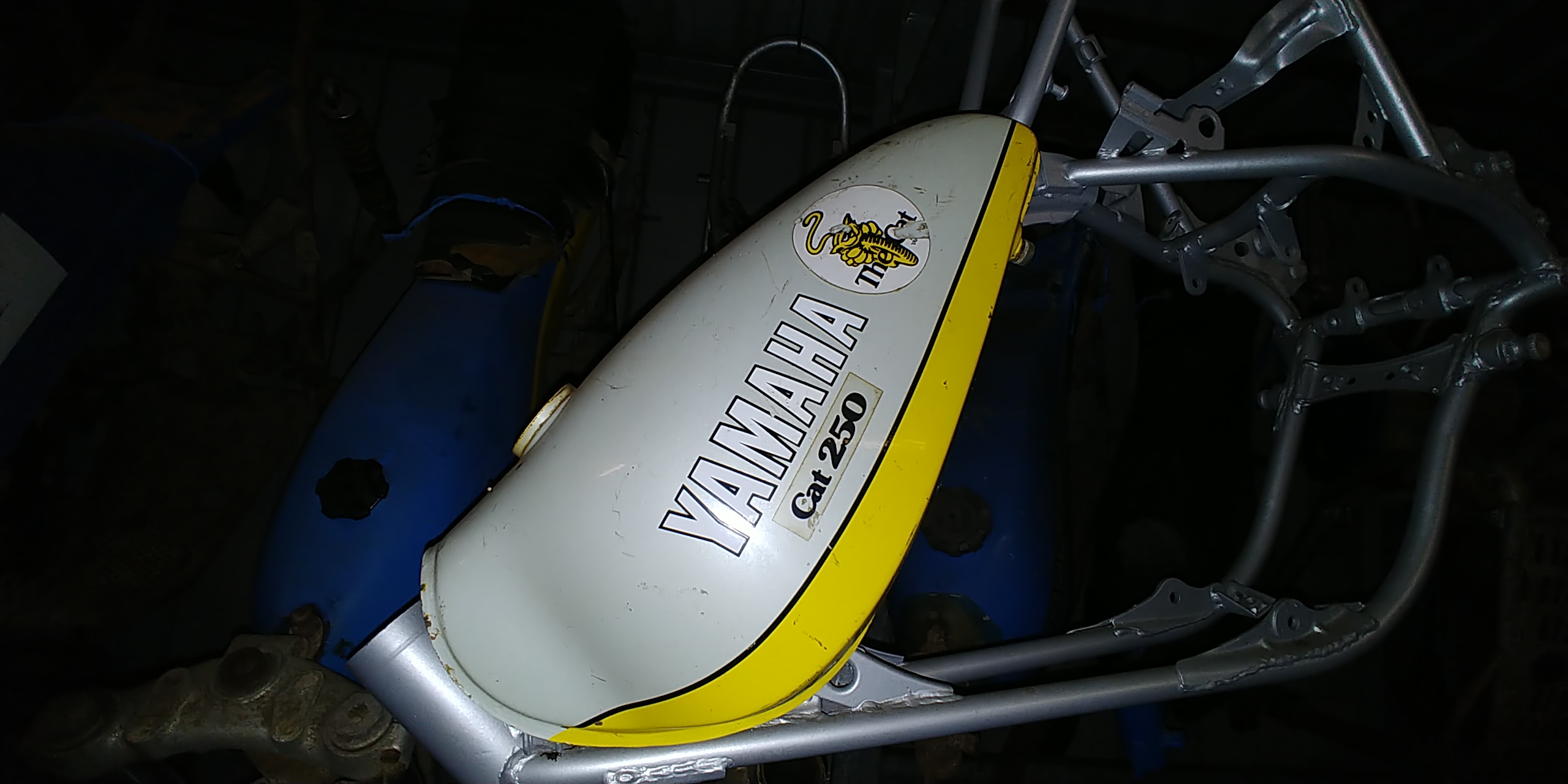

I confess to being a bit fond of
A model tanks and bought this one from the USA a couple of years ago, complete with Cat stickers
A model tanks and bought this one from the USA a couple of years ago, complete with Cat stickers- Attachments
- 20200807_172539.jpg (642.68 KiB) Viewed 8204 times

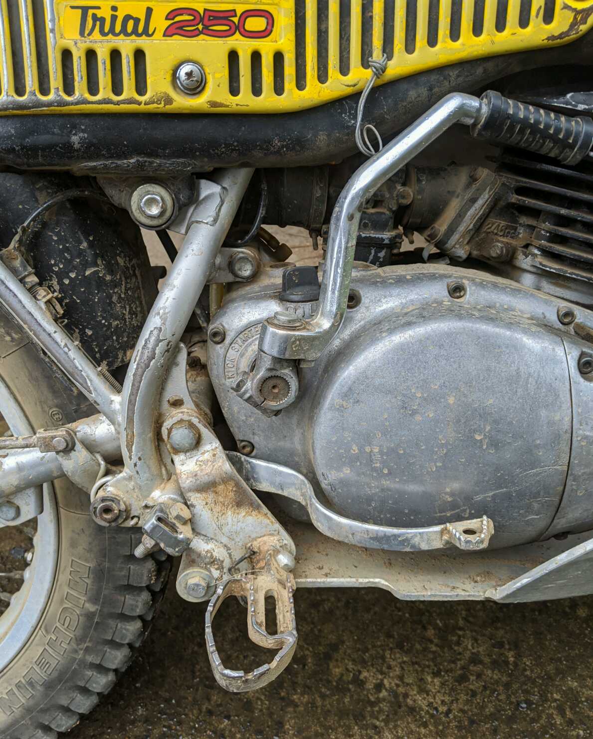

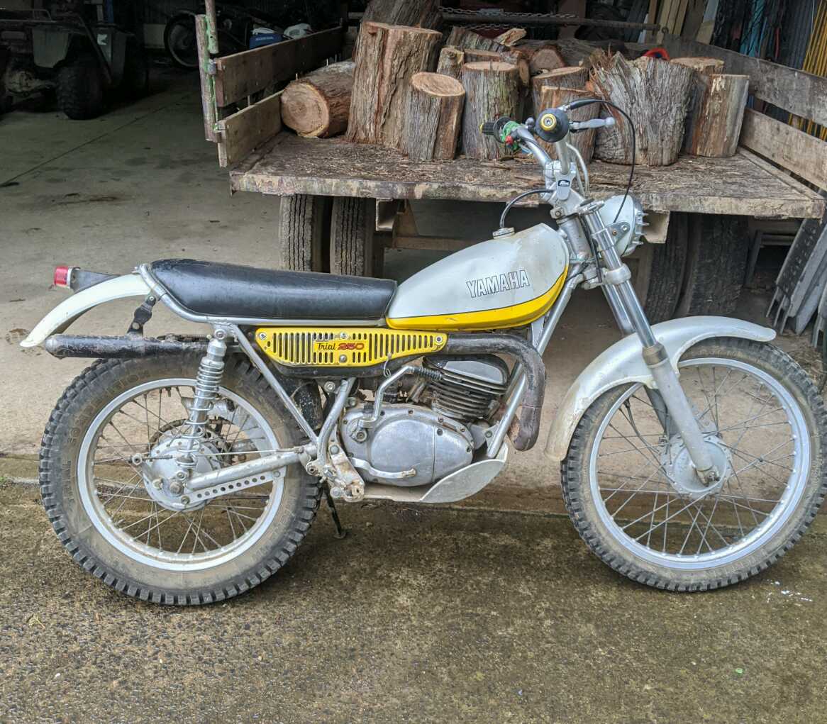

Re: Yamaha TY250 CAT
Hey David.
I have 2 trail kits, both sourced from the US.
One was a NOS kit that I no doubt paid an exorbitant amount of money for.
Later I spotted a "bit of a kit" on eBay and contacted the US bike wrecker and explained the issue of the vital longer swing arm bolt and other bits and pieces.
He had no idea, but found it all bar the peg pivot dodads.
The peg relocating brackets attach at the swing arm bolt and have special plugs that hammer in to the lower frame cross member and then accept a bolt. On my bike the cross member had copped a bit of a hiding so I hammered a hardwood dowel right through and then used a couple of roofing screws. Here is my kit fitted to my beloved "A" model:
The NOS peg kit is somewhere in the shed along with a mountain of NOS A model bits including a NOS tank. Strange obsession.

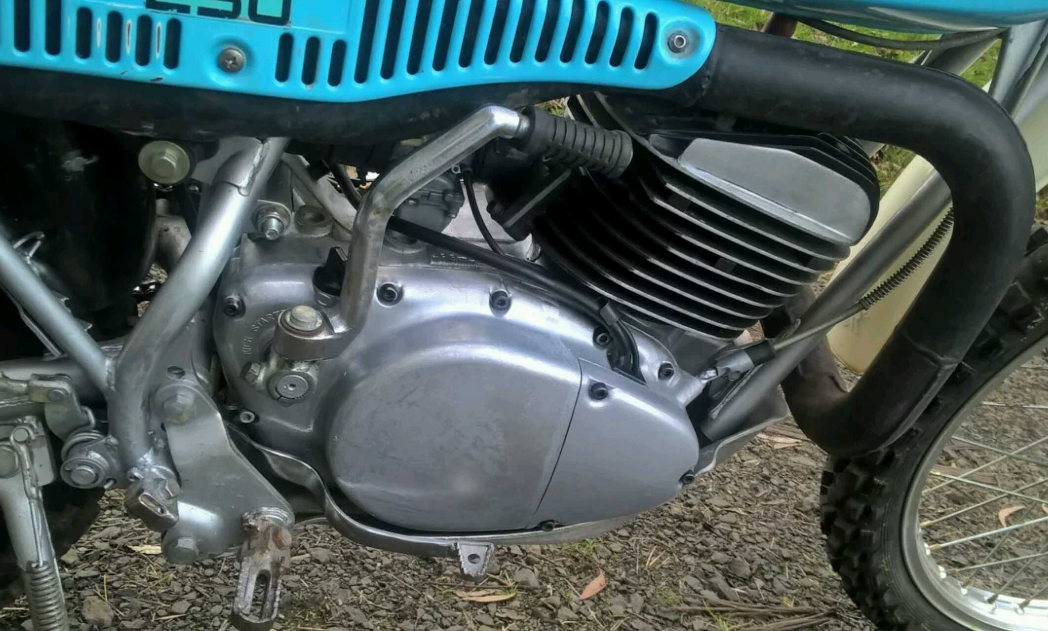

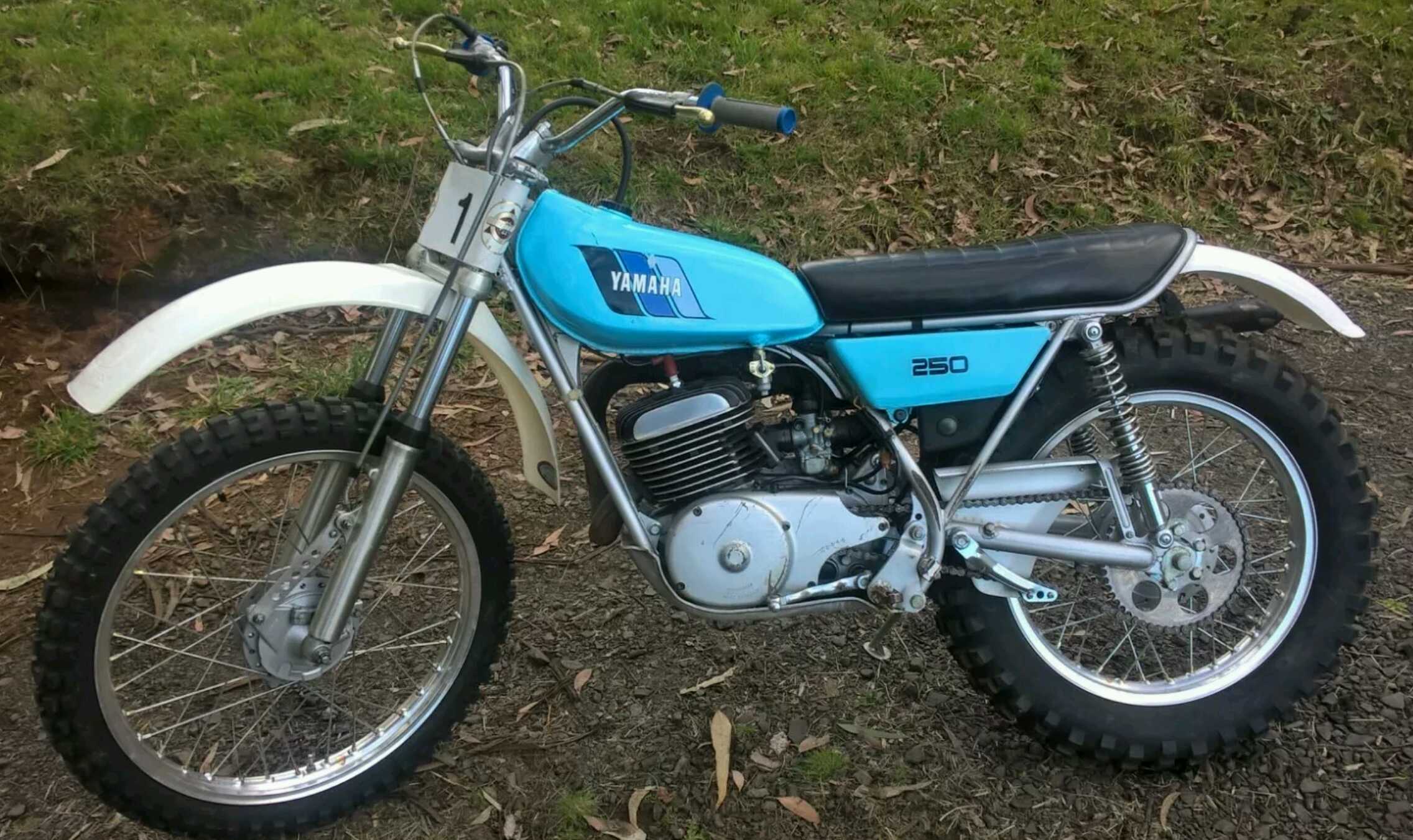

Also while I am going, here are photos of the "D" model on ebay I talked about:
