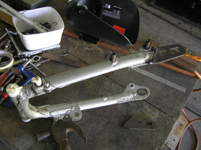

Here's how I did one
- P1230200.JPG (72.28 KiB) Viewed 7513 times

Re: Is it worthwhile to lengthen swingarm TY 175?
That looks easier than what I had in mind. I like the nice straight cut for adding the extension. Thanks.
