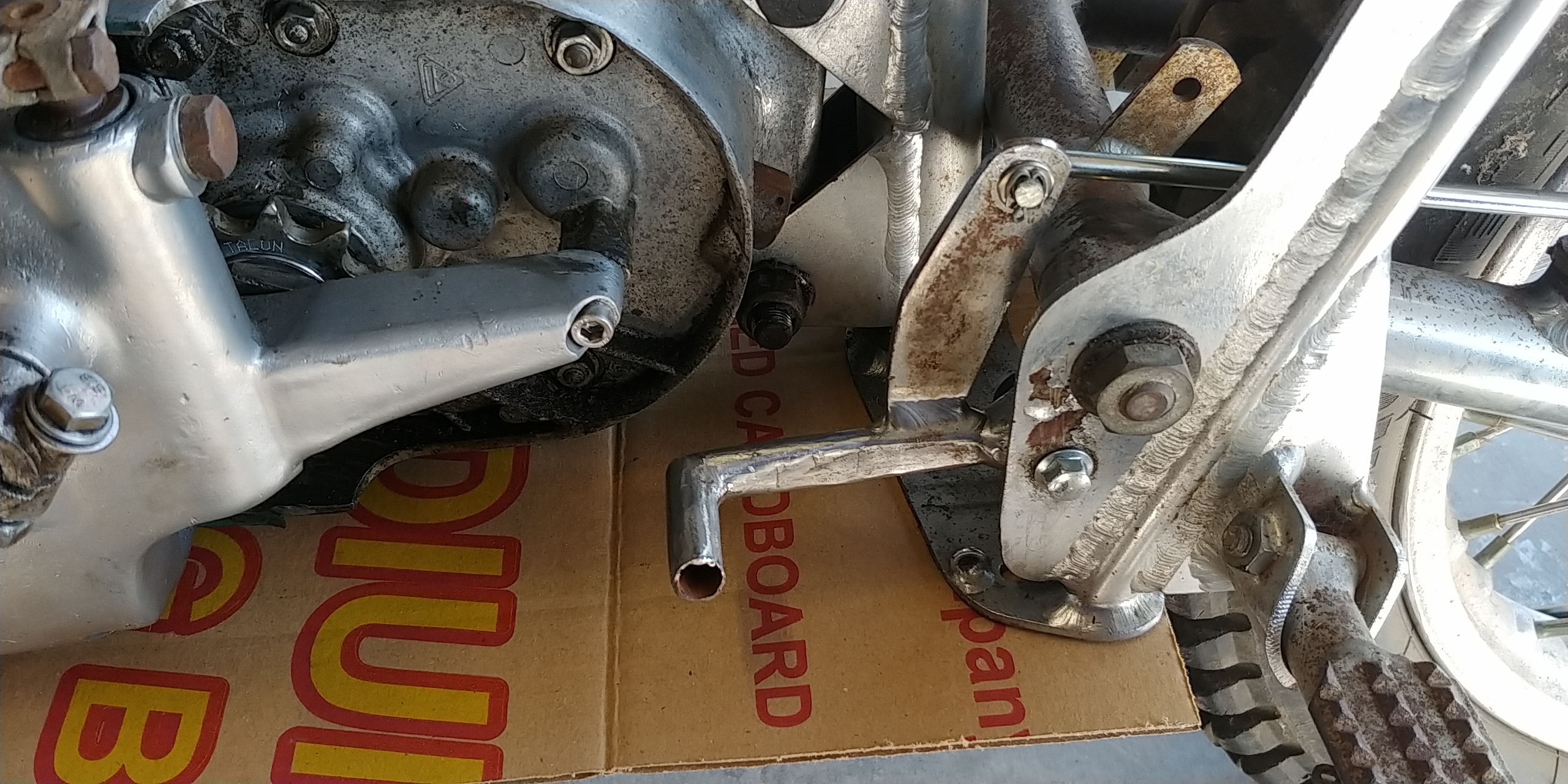

One thing was to set up some rear brakes.
The brake pedal had been extended and was was quite bent so last weekend I removed the ugly extension piece and did some straightening. The pedal is made from thin-wall steel tubing and is held together with bronze welding so I couldn't use heat to soften it for straightening, so it's not as neat as I wanted but at least it should work OK for the test riding.
Before
Before
The brake pedal is now ready for the test riding

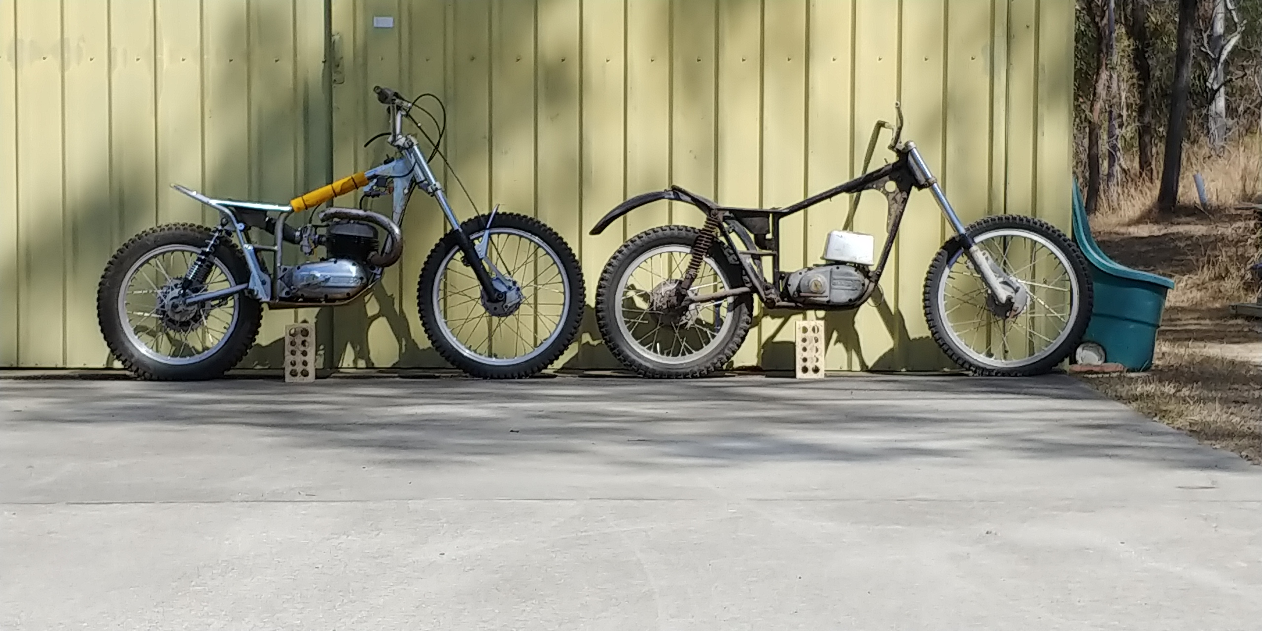

No progress on getting the SM frame bike ready to ride, but today I had to move some bikes around and decided to do a comparison photo of the SM frame :bultaco: bike with a model 80 :bultaco: Sherpa T.
I've put housebricks under them to better show up the difference in clearance under the motor. As expected, the SM frame bike is a bit higher than the model 80 bike.

Miller frame looks to have a slightly steeper head angle. Is that the case?
Re: Sammy Miller Highboy Bultaco
don.howison wrote:Miller frame looks to have a slightly steeper head angle. Is that the case?
It is steeper than that M80 Don. I suspect that the Konis in the photo that are on the model 80 are a bit shorter than ideal.
I put 340mm shocks on the SM frame bike so that it had the same steering angle as my model 49, which I had set up to feel lovely in the steering. I think if I fitted 340mm shocks on this model 80, the steering angle would be very close to or the same as the SM frame bike. Maybe that could be something to check next time I need to move the bikes around in the shed
