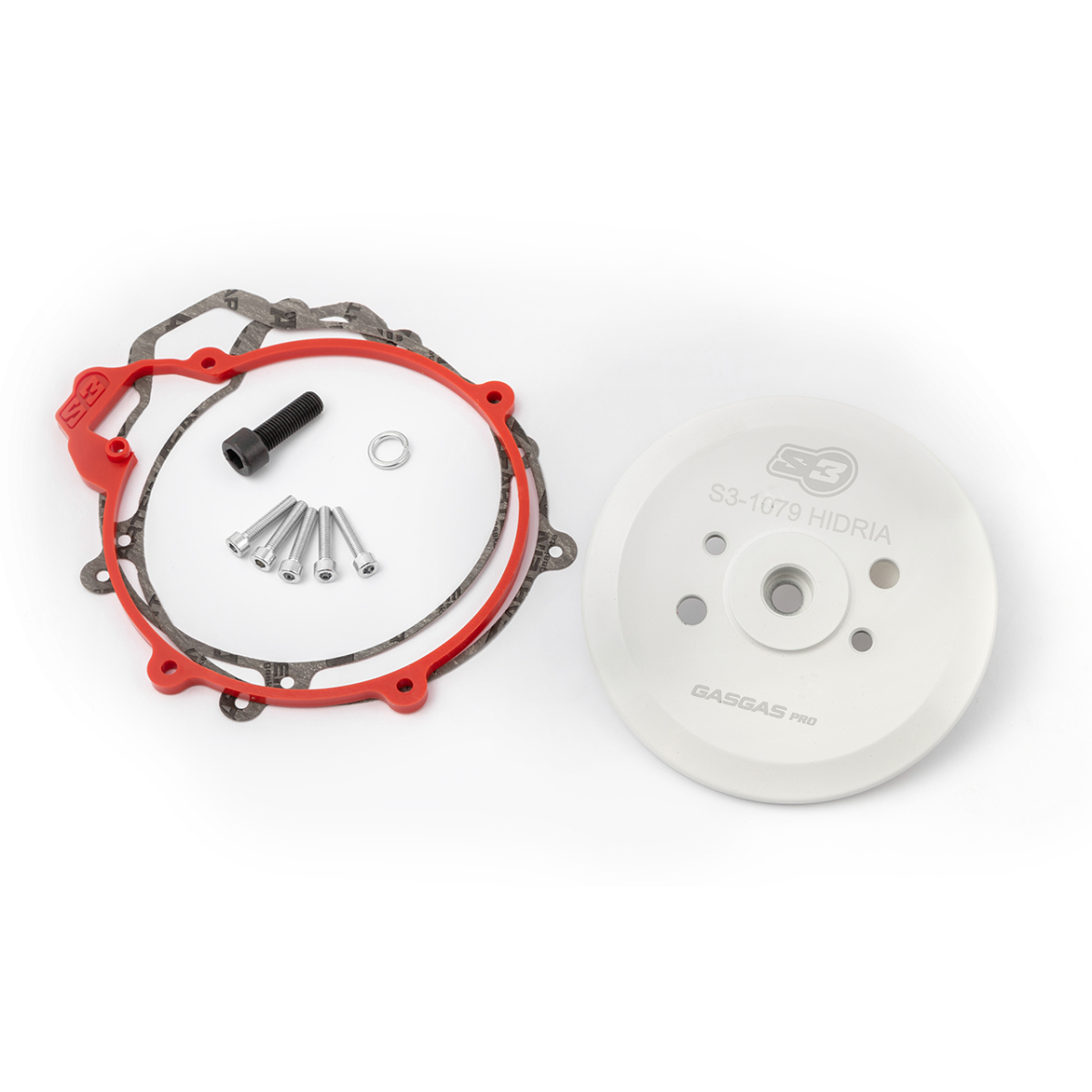

I added an S3 flywheel weight to my 2014 GasGas 300 several years ago to tame it down to my liking, I was a 52yo getting back into Trials after a 20yr absence, it served its purpose well and is still fitted 9 years later. Weighed around 600 grams from memory.
Cheers, Rod.
S3 Flywheel Weight for '14 GG 300.jpg (376.94 KiB) Viewed 6231 times
