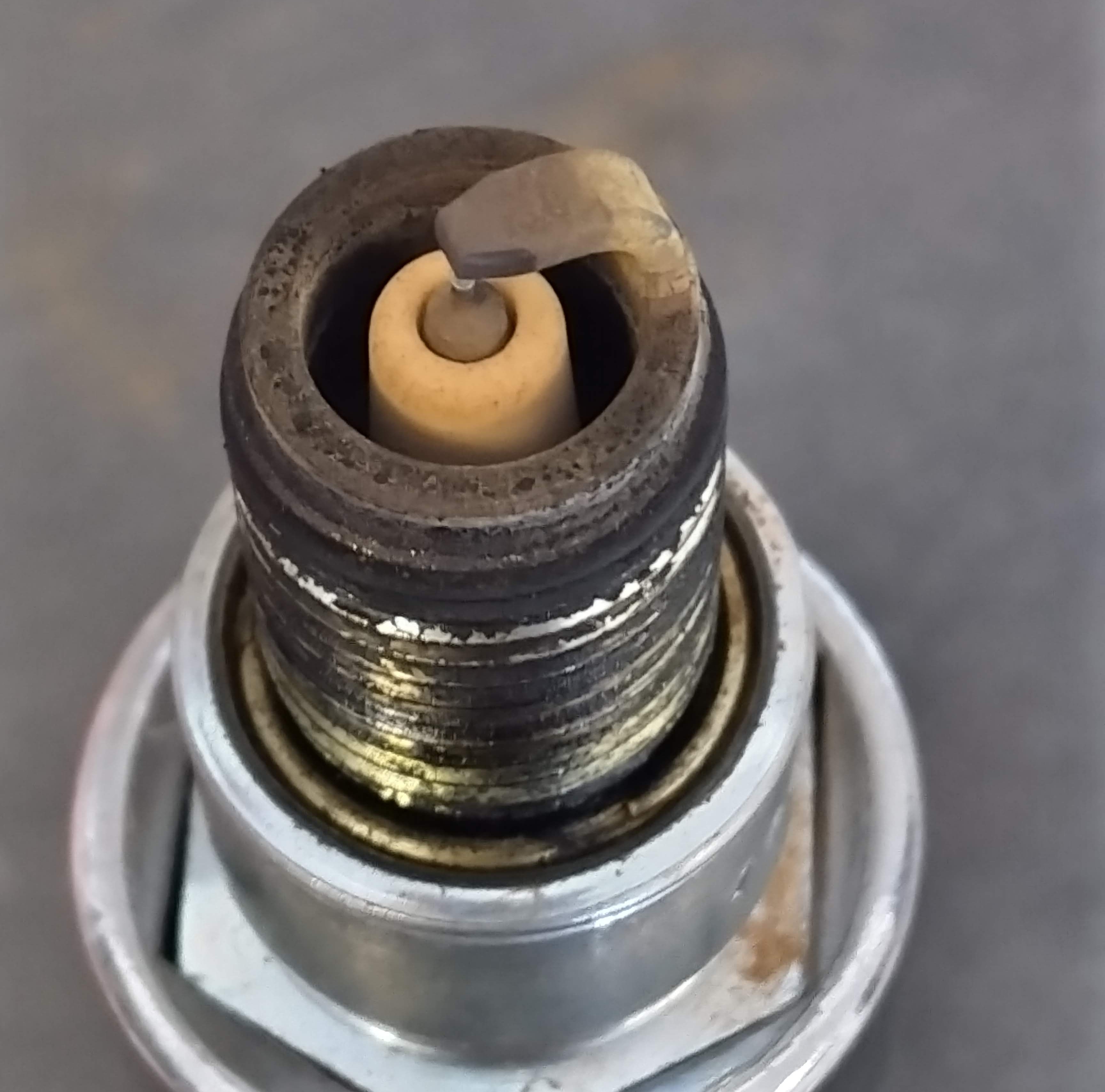

Thinking about the original post, I have had a 2018 Raga Race 125 and for the last couple of years a 2021/2022 TRRS Raga Race 125 and I use 98 octane as per TRS recommendation. I have heard and read about people's concerns with the additives, but I don't think I have had a problem. I have tried 91 and 95 but perhaps by thinking too hard about whether there was benefit or not, I felt that 98 was better. But heck, was it just because 98 is a bigger number and is more expensive and therefore must be better :D
That aside, I have attached the pic of my current plug (iridium because my current model allows standard plug) but my bpmr6a was similar in the 2018 bike. I have run boyesen reeds in both of my TRRS 125's, optimised my jetting and importantly changed my needle from a jjh to a jjj - slightly leaner in that critical just off idle - 1/8th throttle position that I have found in each TRRS i have ridden, which just has a very slight "burble" - ie slightly rich and is a range perhaps well used puttering in sections. While some of my fellow riders would say "get over it - just twist the throttle more", I do like to understand and optimise my carby to my needs - sealevel to about 400m and the warmer climate here in :WA: and I am known for delicate throttle twisting.
May be when someone looks at my spark plug below they will say it is too lean, or too rich on the main or has deposits from additives ??? But my bike runs well, does not foul plugs, starts easy, does not ping and is the same plug for a year or more.
The Boyesen reeds (to me) give better performance (torque and consistency in response) low down and great responsiveness through throttle range. The pic of the sparkplug was after a practice ride at our clubs Trial Park (3ha) and not a plug chop after a full throttle firebreak run.
Spark plug.jpg (726.59 KiB) Viewed 10050 times
