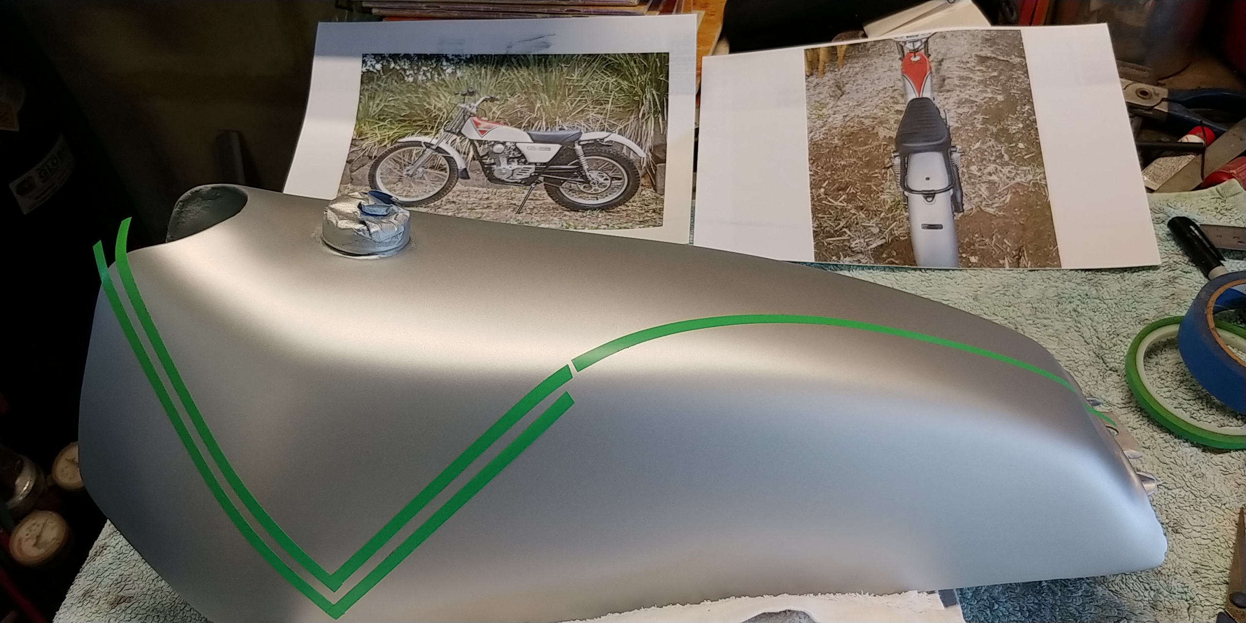

Repainting twinshock fuel tanks that have multiple colours and swoopy patterns and have them look like the original is a challenge. It's the main reason why I've gone for custom tank colour schemes on some of my bikes.
The :yamaha TYs with the swoopy colour schemes are tricky ones. This is the first :honda: TL fuel tank I've done and it is every bit as tricky as a :yamaha TY175 B, C TY250 B, C. Not only does the pattern have to look right from the side, but both sides have to match very well on top.

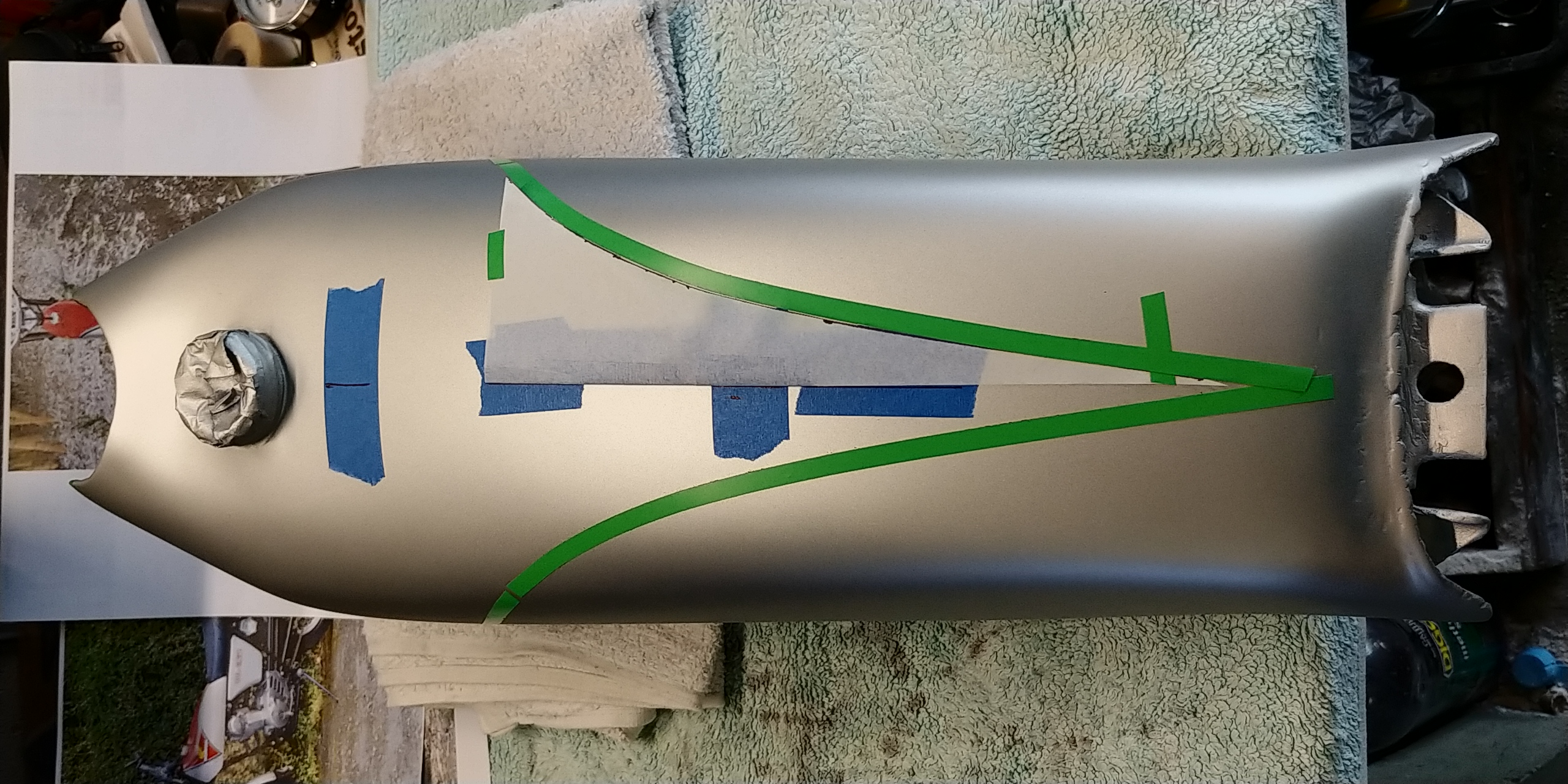

I tried using skinny masking tape freehand many times but could not get it symmetrical. I eventually gave up and made a paper half-pattern for the top side of the tank which worked OK just don't tell my wife that I raided her scrapbooking supplies for the tracing paper.

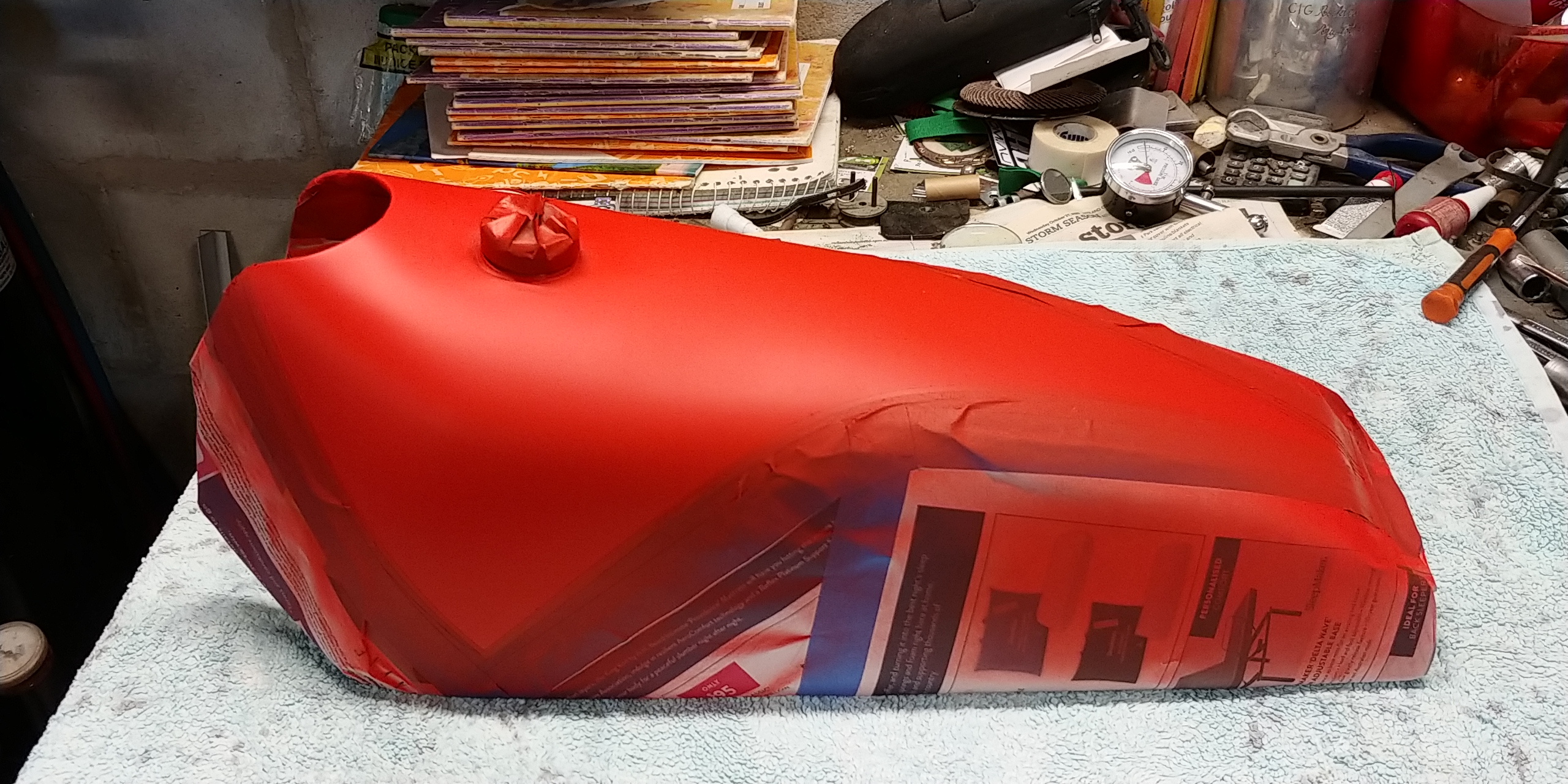

The :honda: red bit is now painted.
The silver and black stripes are next.
