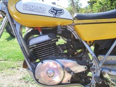

Drakey I take back what I said about the TY250 magnesium engine covers. The finish on the one in the photo certainly drags it out of the dull and drab category and firmly into the cool and groovy.
You are full of surprises. Next you will be telling us that you ride one or both of those TYs. I kind of imagine already that you might ride the one with the Fox sticker and shiny mag cover, or did ride until the SY250F turned up.

I do have a few suprizes in the bag.Sadly I do not own the B and would never commit the crime of putting a fox sticker on.I think I tried to buy that bike just to take that sticker off. Ive become strictly an A man now! You cant beat Cool and Groovy.

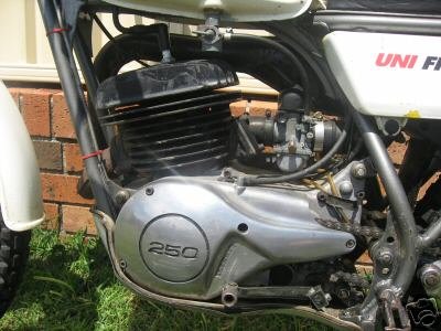

How good does that A look ?Now that I think of it I bought that A to take the UNIfilter sticker off.
